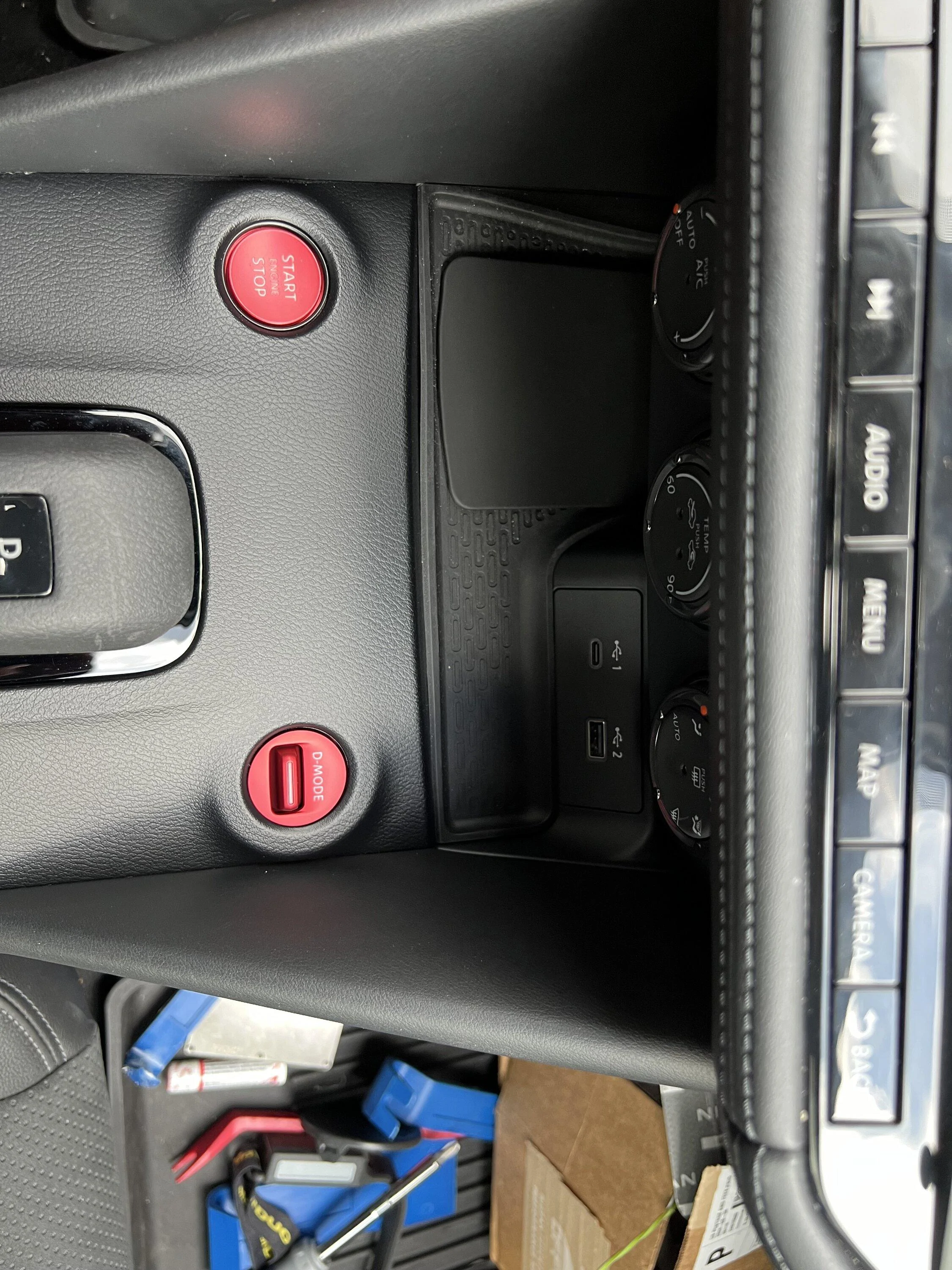

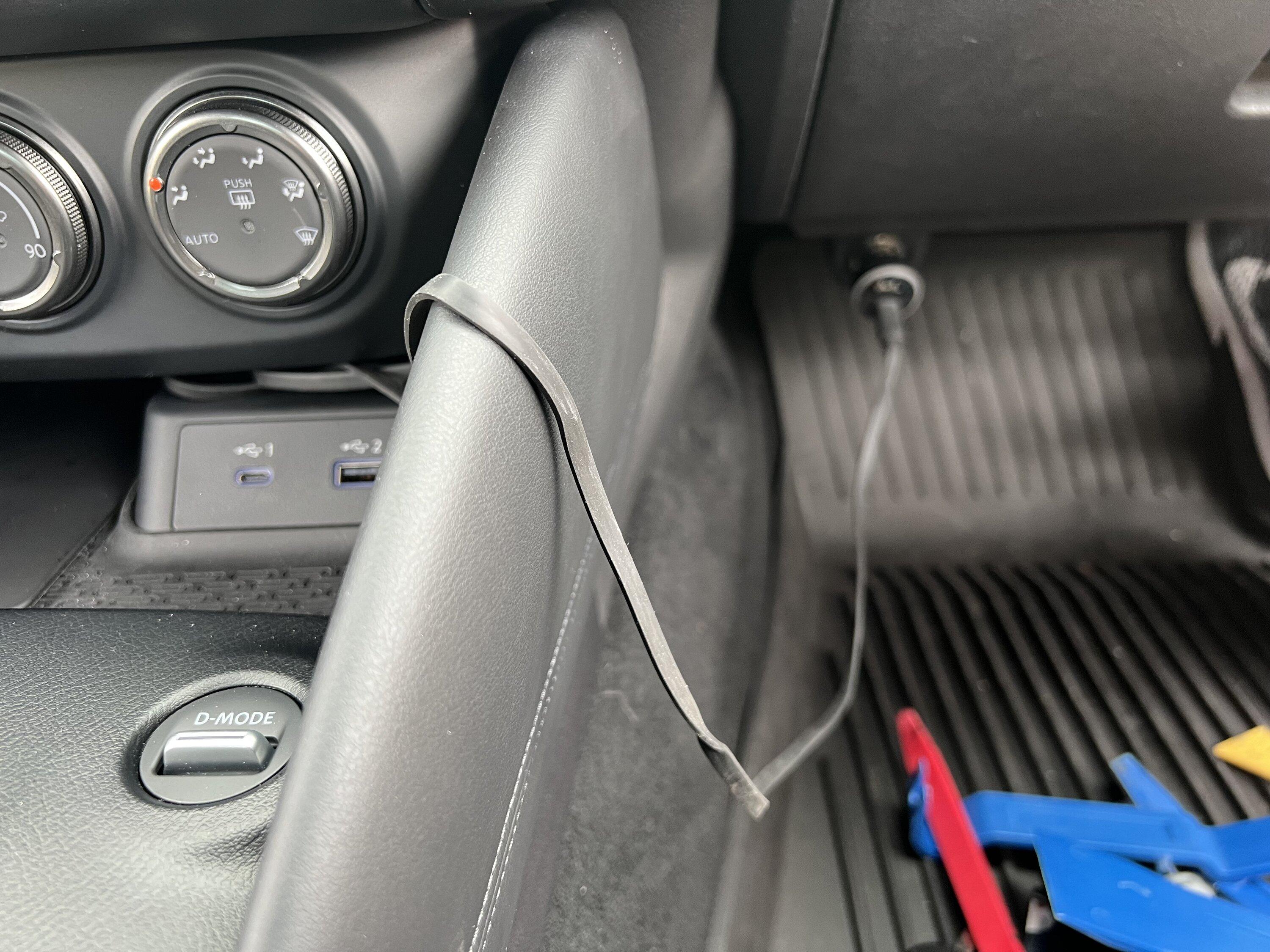

Did a little something today. Starting the addition of the red accent pieces in the interior. Also got the wire hidden and ran to the outlet in the center console.

I thought that would the best way as long as there was enough power for the charger. Can you explain how you raised the console? I assume you had to drill a couple of holes at each end of the console.

I didn’t raises the console. I pulled the top panels off. Starting with the cup holder piece. And worked my way forward. Eventually I took the little cubby out as well. Ran the cord to the rear and zip tied it to the other wire harness. The charger I got has a flat cord so I ran it up and out beside the second cup holder going into the center console. Leaving all the slack zip tied underneath. The black cord blends in and can only be seen when the arm rest is moved back. Hope that helps.
