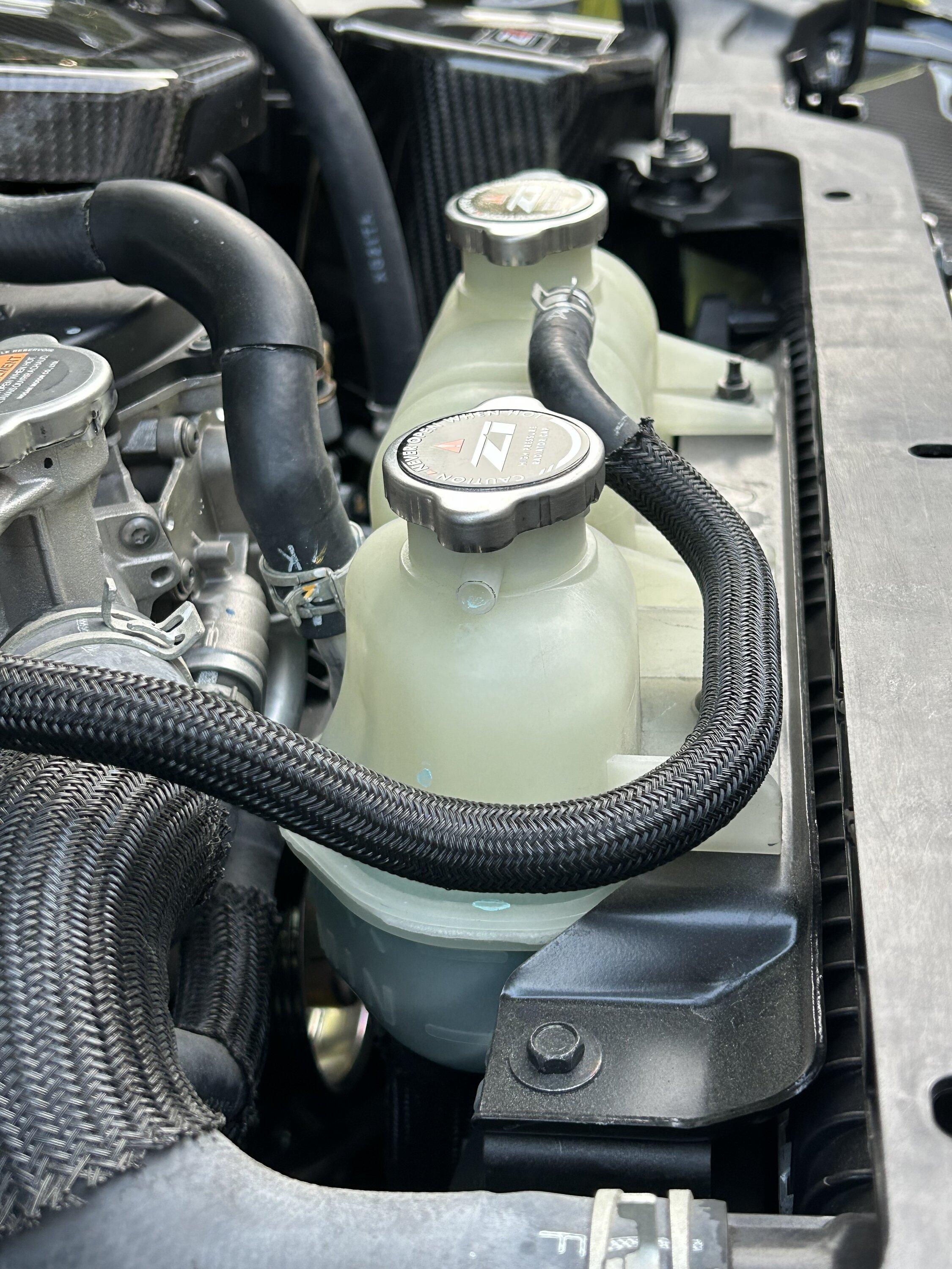

Hey Guys,
I was wondering what the average of both should be. I know some places with higher climates can change all that.
I have a range of 204-214F just idling. Albeit, today was like 93F. But speaking to someone else, they had hotter humid temps and his readings were much lower than mine.
Is there anything I can look at?
Checked my levels, looks good. Not sure if I’m missing anything else?

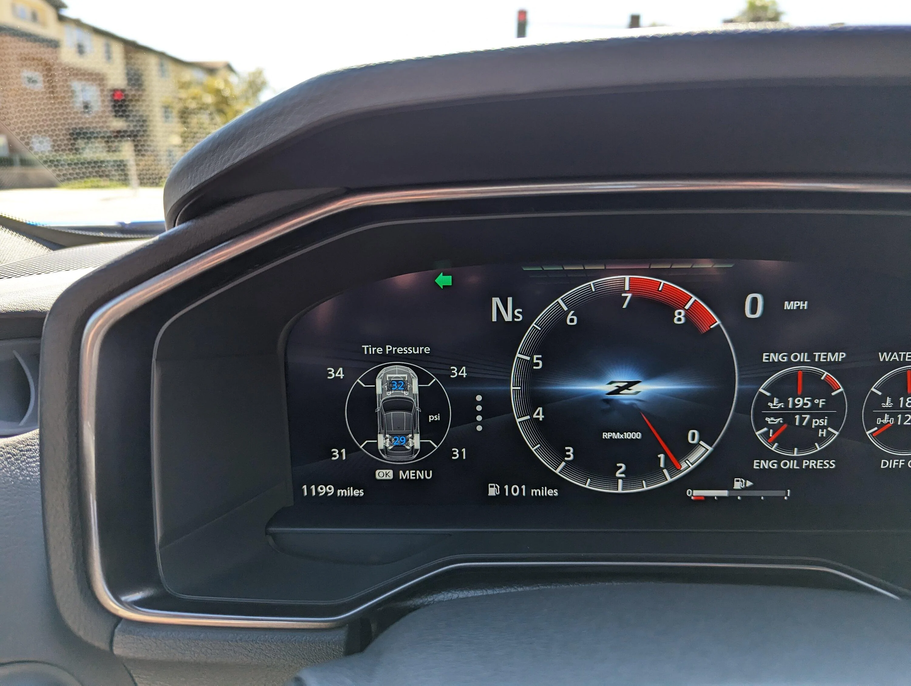

Driving around San Diego today at sea level and maybe 70 to 75 ambient temperature, my oil temp was 195, and my water temp was 18x, so that seems cooler than yours, but then it wasn't 93 outside.
I actually think humidity doesn't matter for oil and water temp. These are closed systems, right? So atmospheric humidity shouldn't enter the equation.

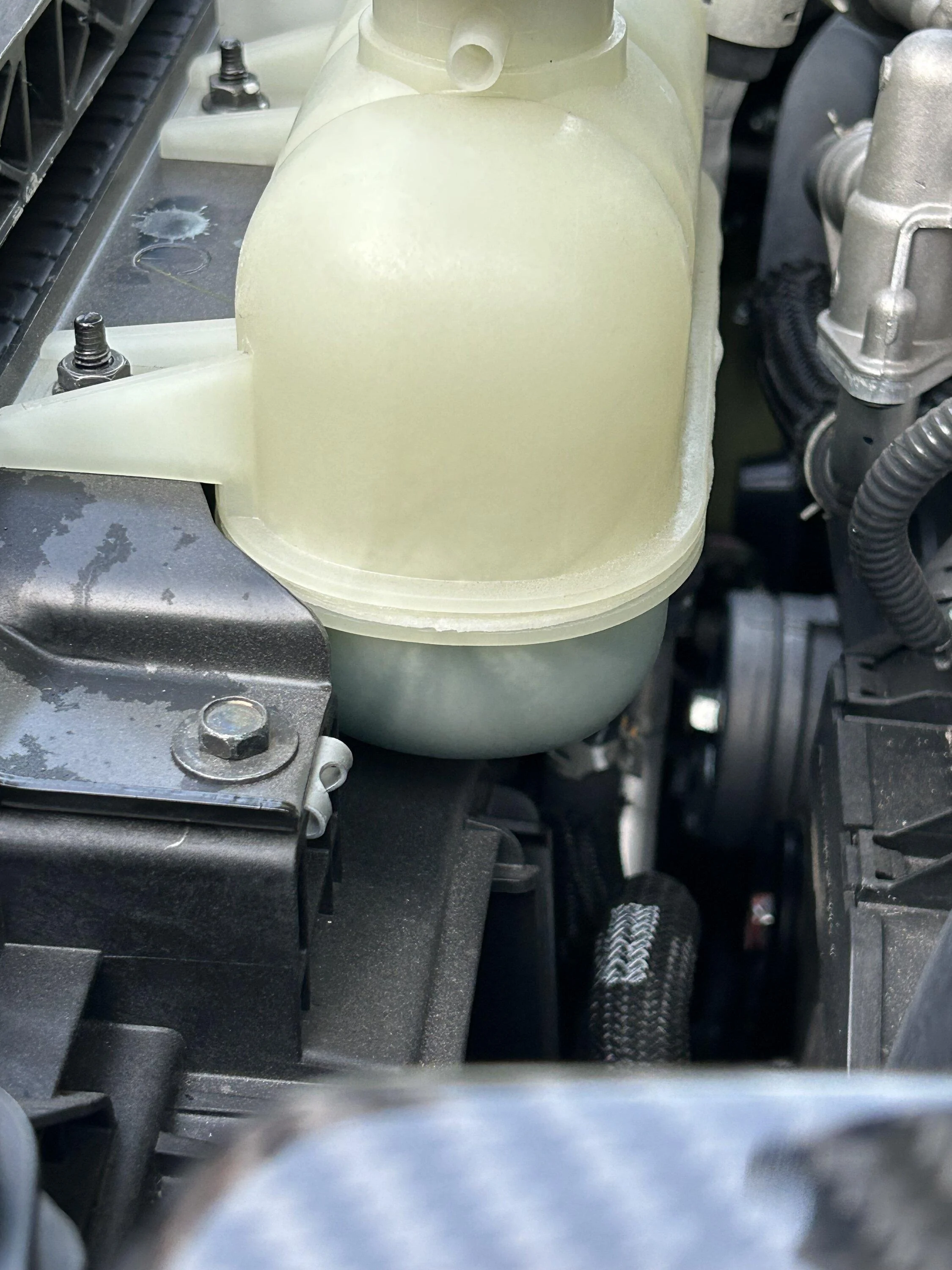

Yes, I just got back from taking it for a night spin.
I topped up some coolant as it looked somewhat low. Then went out and noticed it was good. Hovering around the middle for both temps. But when I got home in drive it creeped back up closing in on the redline. So went out again , yes it cools back to normal when driving . So, I’m assuming it’s normal to creep up in temperatures that high when idling. Especially on hot days/nights.
