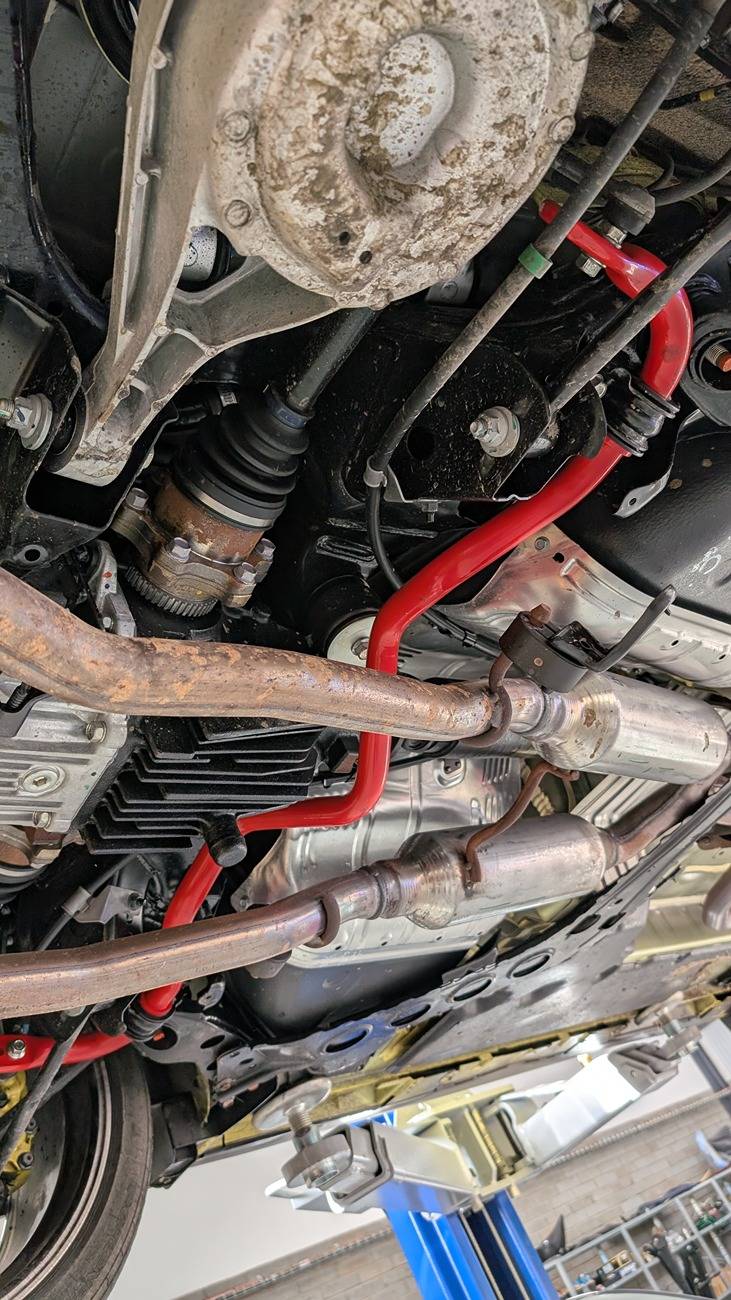

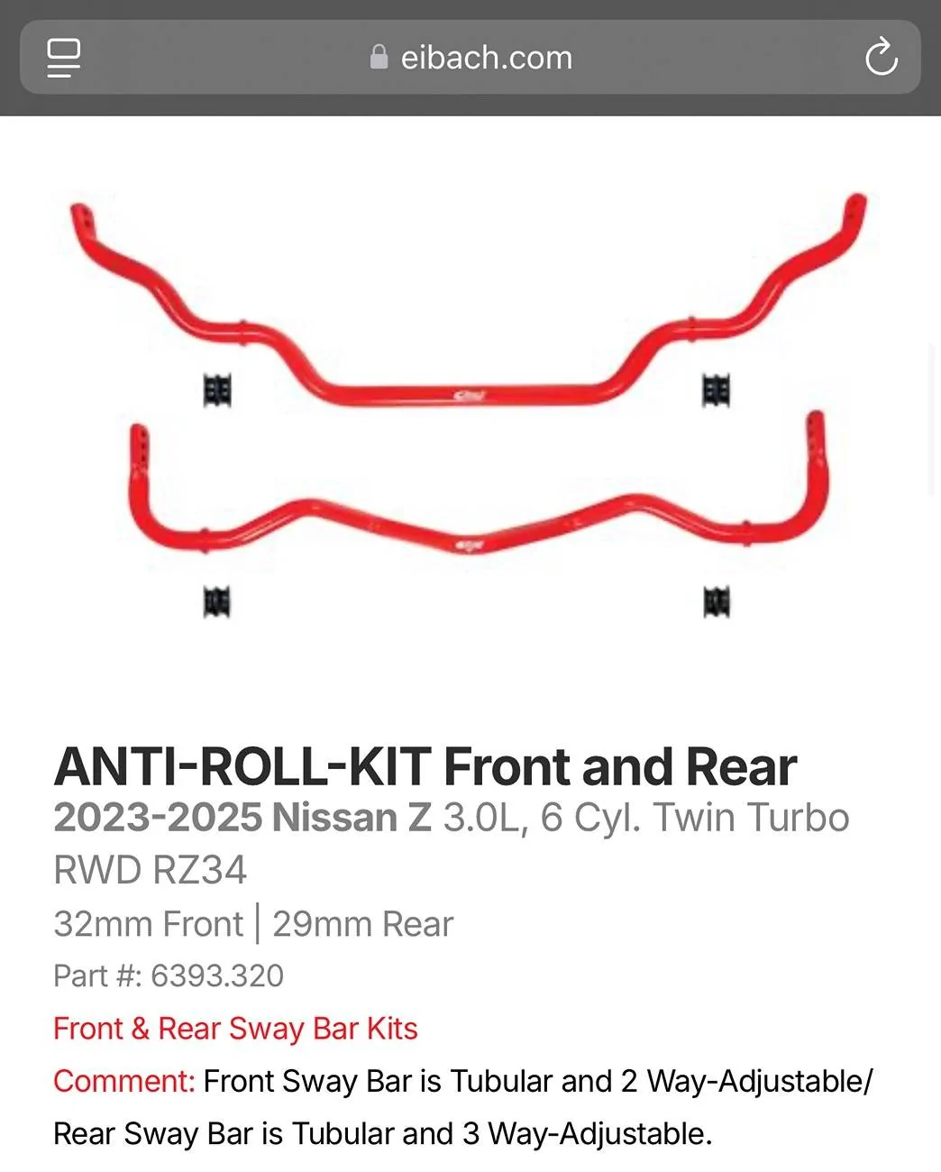

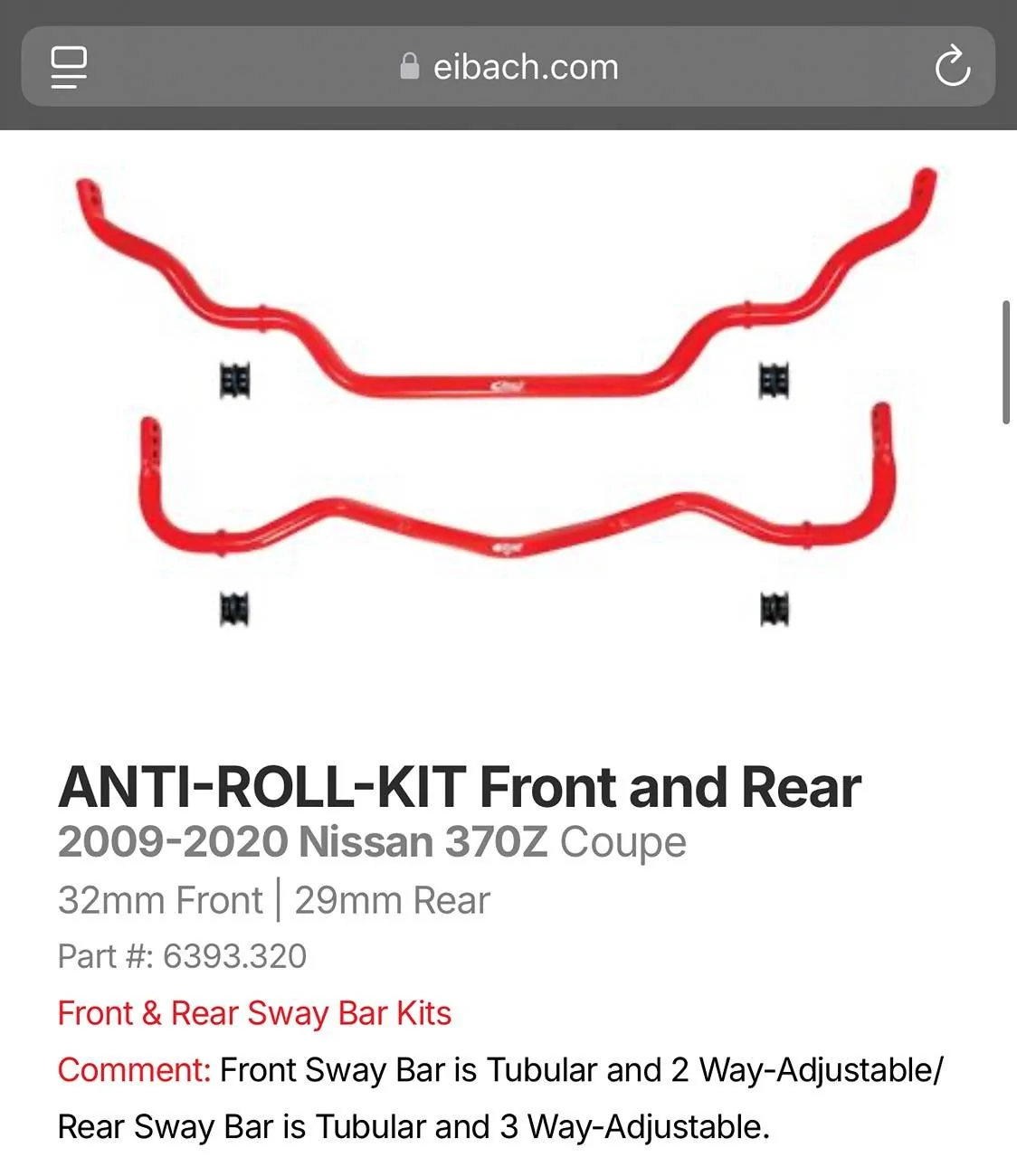

For future reference this is not true at all. I just installed a 370Z eibach rear sway bar on my new Z no problem and you can see it's the exact same shape as the stock one I removed

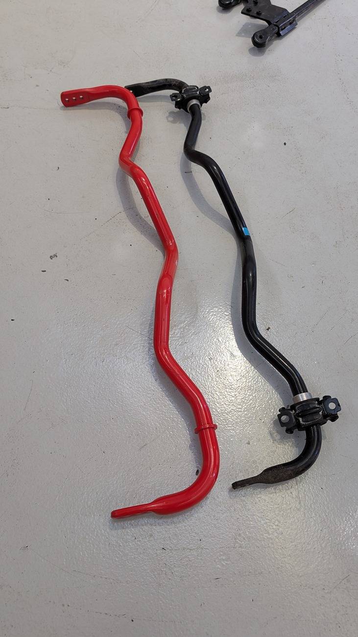

Not sure about eibach sway bars. But the ones i got are cusco from jp. The dimensions are slighty different from the rear and the part number completely different. https://www.rhdjapan.com/cusco-rear-sway-stabilizer-bar-fairlady-z-rz34.html
https://www.rhdjapan.com/cusco-rear-sway-stabilizer-bar-z34.html
Could be one of the reasons why some bars actually snapped? Nismo usa might have just used the same z34 dimensions and had to address the issue recently

Every single 370z suspension part will bolt right up to the RZ34, they are identical as far as critical dimensions go.
The dimension you are seeing a difference is in the bar diameter, which determines it's spring rate. Companies re-developed their springs/shocks/sways because the RZ34 is much heavier than the z34 and has more front weight bias. Even though all the z34 coils/sways bolt up they are not tuned properly for the heavier chassis hence the part number differences.
This goes for almost every part on our car, 90% of it outside of the engine bay is identical to the Z34 and can be swapped back and forth.
