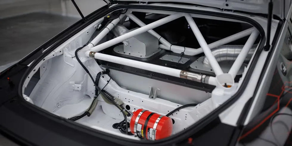

Off-topic, but interesting how the Z GT4 has the rear strut tower brace welded in to the cage, but still has a screw, assuming for adjustment.

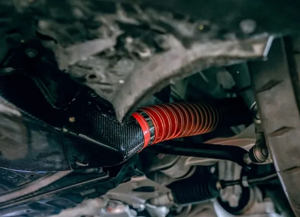

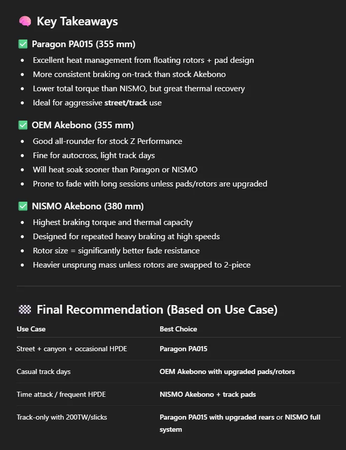

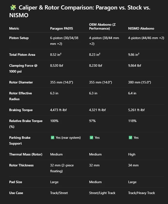

Some interesting thoughts. I did some research on brake kits that would fit my current 18" track wheels and came across the Alcon and Paragon options. I also compared the clamping torque between the Akebono, Nismo Akebono, and Paragon. Feel free to review the images for interesting thoughts on the matter.
In summary, there is no near real impact or need for me to upgrade the Akebono calipers to the Paragon calipers aside from potential heat management within the calipers themselves, which I plan to help mitigate if I chose either option with Paragon 2-piece vented rotors (which I already have multiple sets).
There is also a company that was researching brake ducting kits for non-nismo Z's. I reached out a couple months ago and they paused it, but didn't abandon it.

Seibon brake cooling ducts
I don't know anything about these. May just be the ducts and you supply hose, hardware, etc... Only thing that stands out is these appear to fit under the vehicle in front of the wheels (sandwich to the undertray?) and I feel like they could easily get ripped off in certain street situations or off-track excursions.
I've looked into this before and IIRC we'd need the seibon front lip for these to mount into. Pretty expensive total solution

I think you were talking about Togue Factory, and they were undermount inset NACA ducts.
Didn't know about the lip thing on the Seibon. If I wanted to make it happen today I would get off-the-shelf NACA ducts, hose, etc. and design my own system before doing the Seibons. Seibon seems like a money-dump and huge mechanical hassle. Not that designing one from scratch would be simple, but if you're not trying to make it look show car perfect... You can get good quality NACA ducts cheap. Hose, is where you'd spend the money, if you want the silicone hi-temp yadda yadda yadda stuff.

Just look at the chart posted above, 4000(!) ft'lbs of braking torque per wheel! That is greater than 1 G deceleration PER WHEEL braking at only 1000 psi (lines are rated to 3000), so unless you have F1 quality aero and are braking at 4+ G's, I don't believe you.
Also notice the base model has more brake toque than the bigger braked performance trim?
