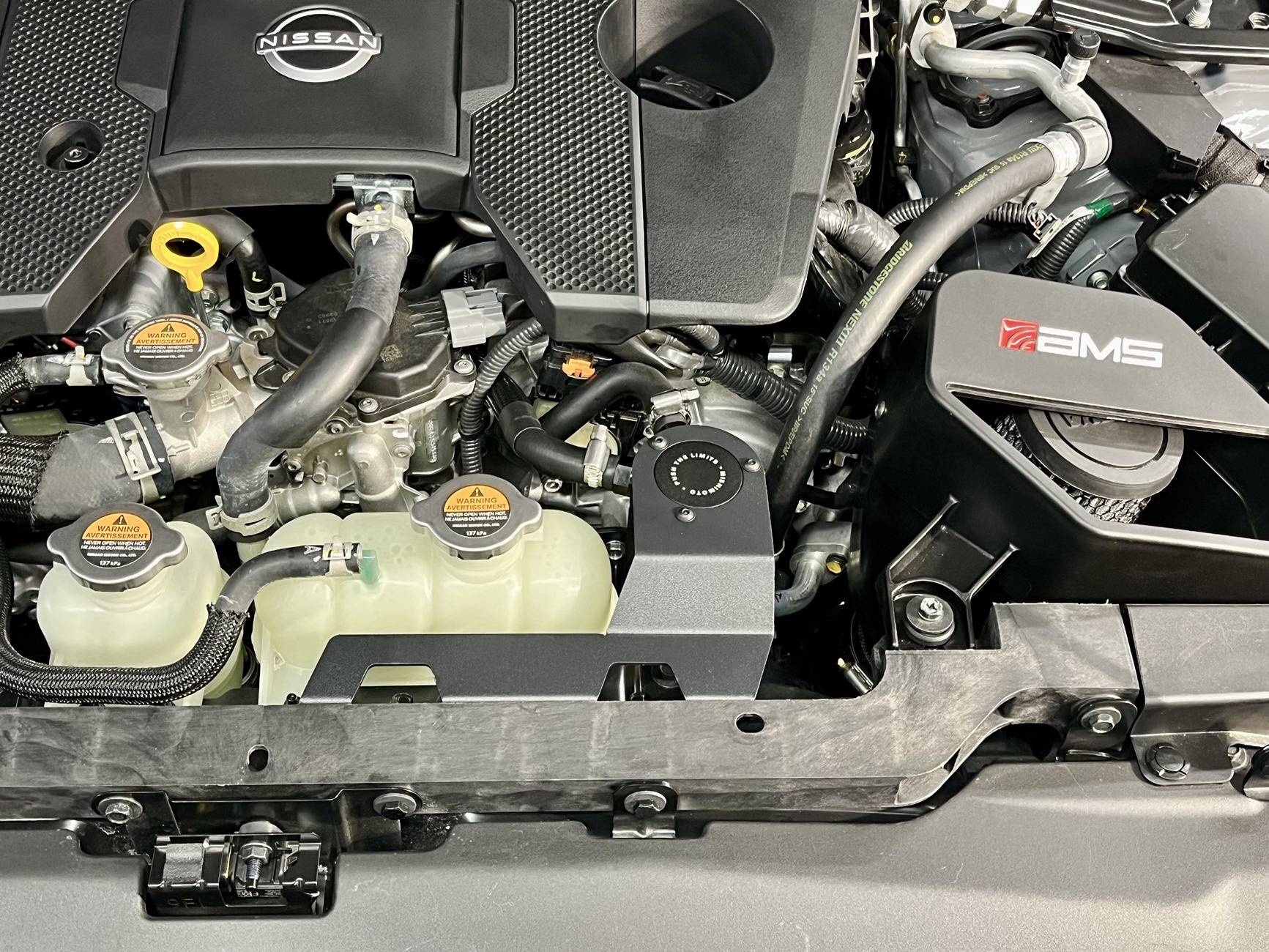

Installed Mishimoto's catch can. All hardware fit & finish is top notch. Install was straight forward, they have a nice PDF and full install video to support DIY. It has an AN plug to drain but the bracket itself slides on guide slots once loosened so I think I'll just empty top-side. Hardest part was wrangling the intercooler out of the way, I ended up using a straight pick to help coax/break the hoses loose.

I did the Z1 catch can a few weeks ago, the intercooler step was a gigantic pain, but hopefully it'll be worth it when I drain the can next oil change.
