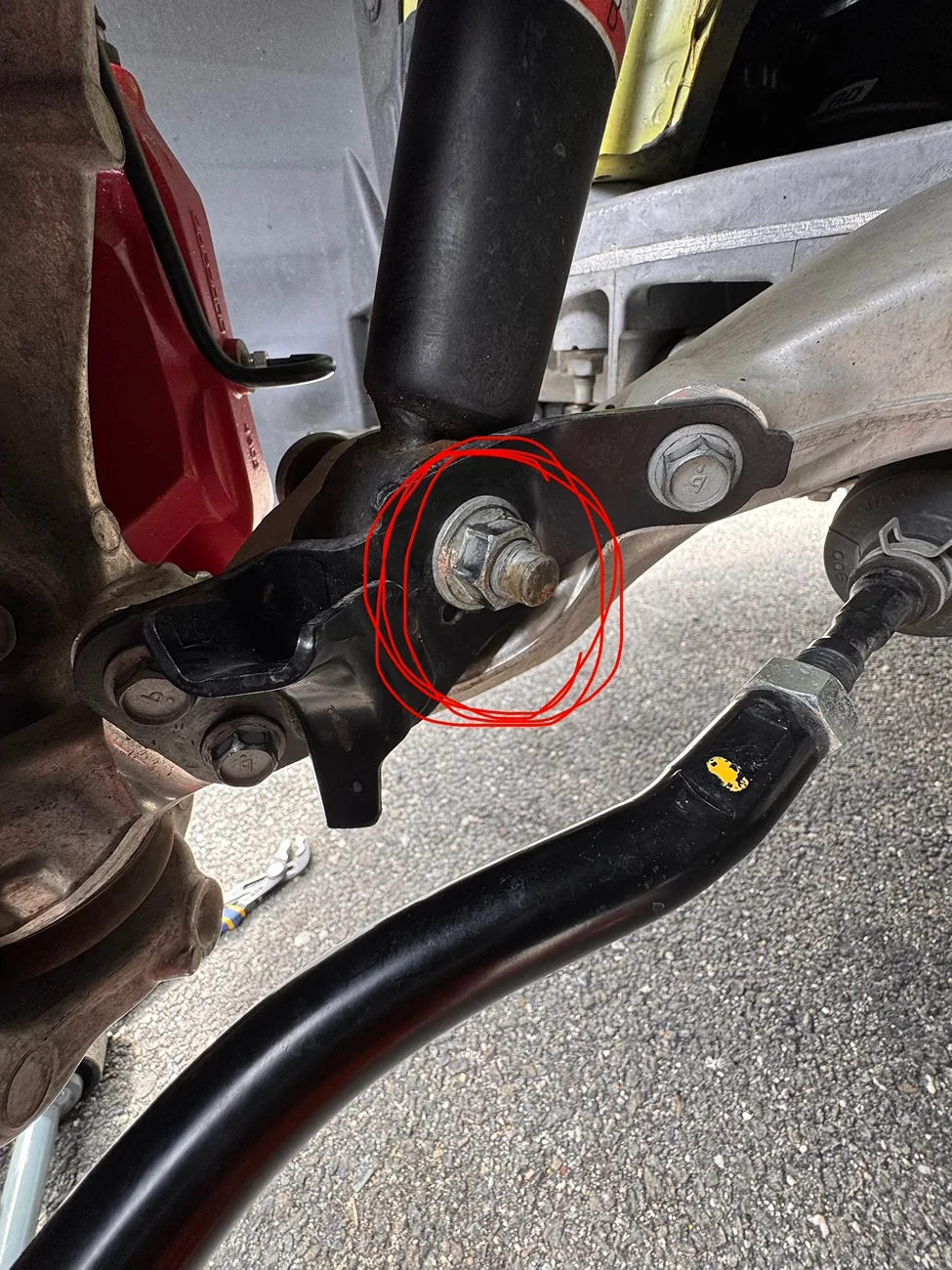

Took the stock “coilovers” no problem, pb blaster came in clutch. But as I removed the stock spring and on the eibach springs, mounting the strut back on to the car was SUCH a hassle. I couldn’t get the bottom mounting bolt/nut aligned together. Upon careful inspection the hole on the shock absorber where the bolt goes thru and tightened by the nut (I’ll have a pic circled for reference) was a bit angled off. Raising the lower control arm was no use and it was angled horizontally. I tried twisting the shocks hoping a little budge would align it, no use.
I had to take it out again, compress the springs, loosen the top nut where it holds the springs, and rotate the top rubber hat so the bottom mounting bolt can align to the lower control arm. Basically this procedure rinse and repeat until it finally aligned and bolt was able to go in. On YouTube I’ve just seen guys just swapping out springs and mount it back on no problem.

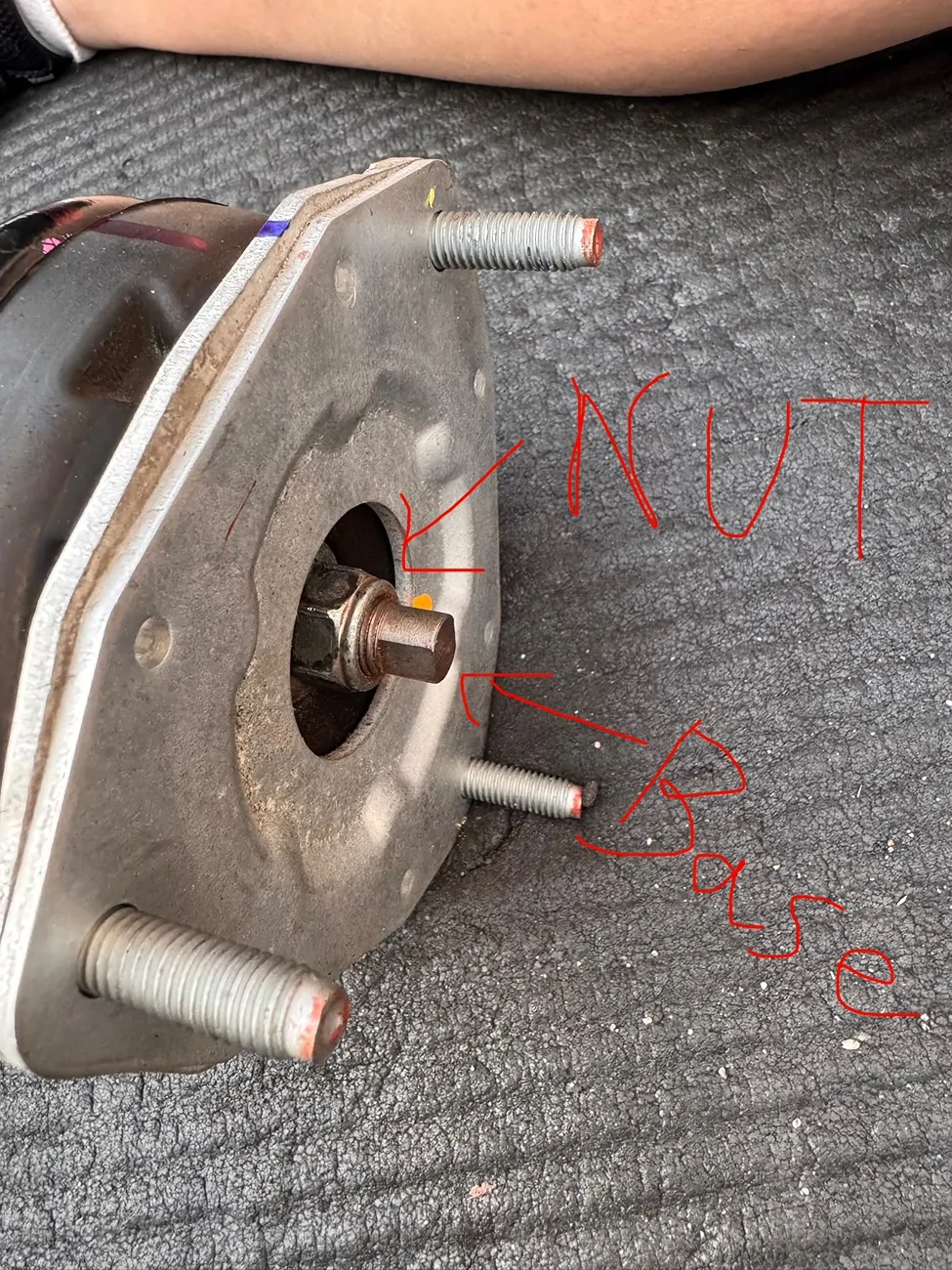

I want to know what I did wrong or what I should have done for future reference. And one more thing. On my right strut when I loosened the nut on the top rubber mount, the square off stem/base was loosening as well when I loosened the nut ( will have a second pic showing what I’m talking about). When I was retightening with the new spring on I just tightened and held the base in place as I was tightening the nut. What does that base/stem do? Should I be worried it was loosened at first?

For non-adjustable coil overs you would have to clock the shock and top hat to the proper position, just copy the same orientation you took off the car, best to mark it when you take it off.
For the spinning, that's why the stem is "squared off" to hold it with a wrench when you loosen or tighten that nut. That squared off part is the shocks rod itself that carries the piston head, valving and seals and stuff, spinning it too much can be bad for the seals. If you just spun it slowly a little, it's probably fine.

Appreciate it, indeed took a lot longer than expected but happy I got the hard part out of the way. I should have marked it when taking off the old one like you said. Good to know for next time.

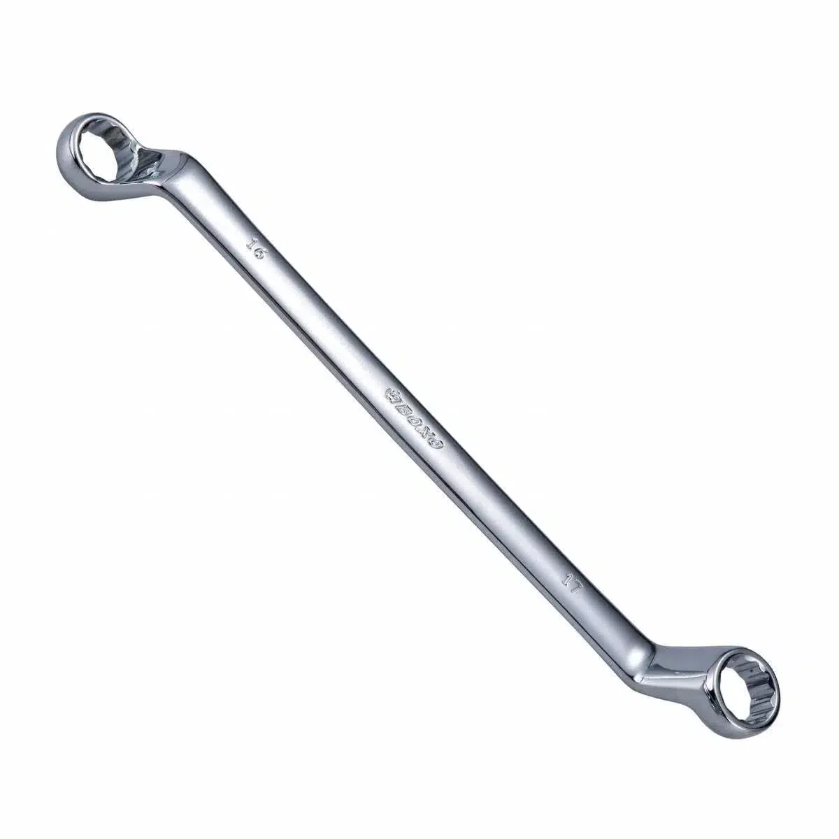

I’m sure there are other ways, but the few times I’ve done it when the nut was buried in the hat, I held the rod with a crescent and loosened/tightened the nut with an offset wrench.

Mark everything, install the bottom bolt first but leave the nut loose, you can get some twisting with the spring and tophat to get it to align up top after.
