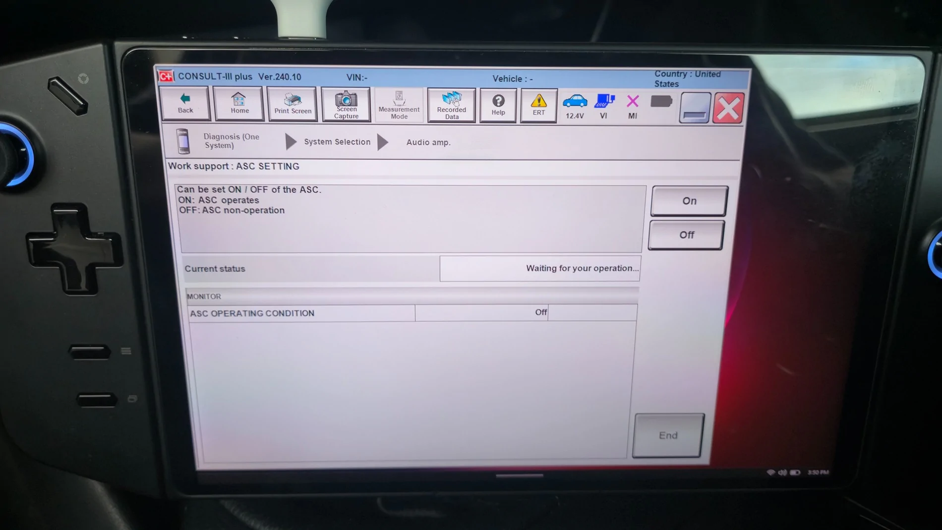

Well I ended up buying everything I need to just turn it off with software as well. I want ASE off the most so pulling the ANC pin wouldnt do me any good. Its annoying they tied everything into to the CAN signals for it on the new Z. I figured while I had all the plastics out I would sound deaden it as well. Removing them takes no time at all. The sound deadening took me and the wife about 7 hours though and I was one piece short in the trunk kit to cover everything I want.

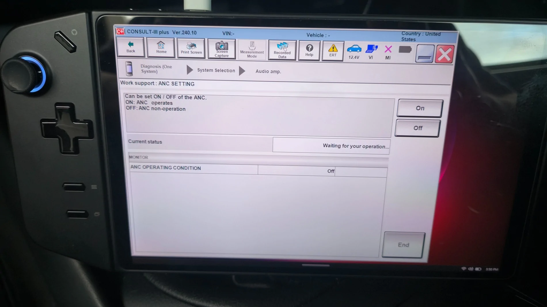

Got the ANC and ASE turned off. Bought the RLink. I used chatgpt to guide me, it was prettt fantastic. One of the things it did was have me configure all my power settings on the laptop (including individual property setting on each USB port) to ensure the connection wasn't lost during write operations. I was pretty nervous about bricking the ECU but it went smooth and all is well. Engine sounds normal now and the audio is better for sure.

The ANC is terrible in my opinion. Felt like I was inside a speaker port or a small tunnel when i was driving sometimes. Without it the interior feels "open" for lack of a better term. It was like something was wrong that I couldn't directly identify, and now all is well. I guess years of racing and driving/riding all types of vehicles really makes me want to be able to hear everything that is going on.

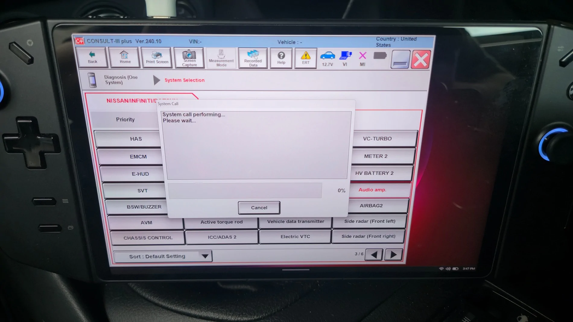

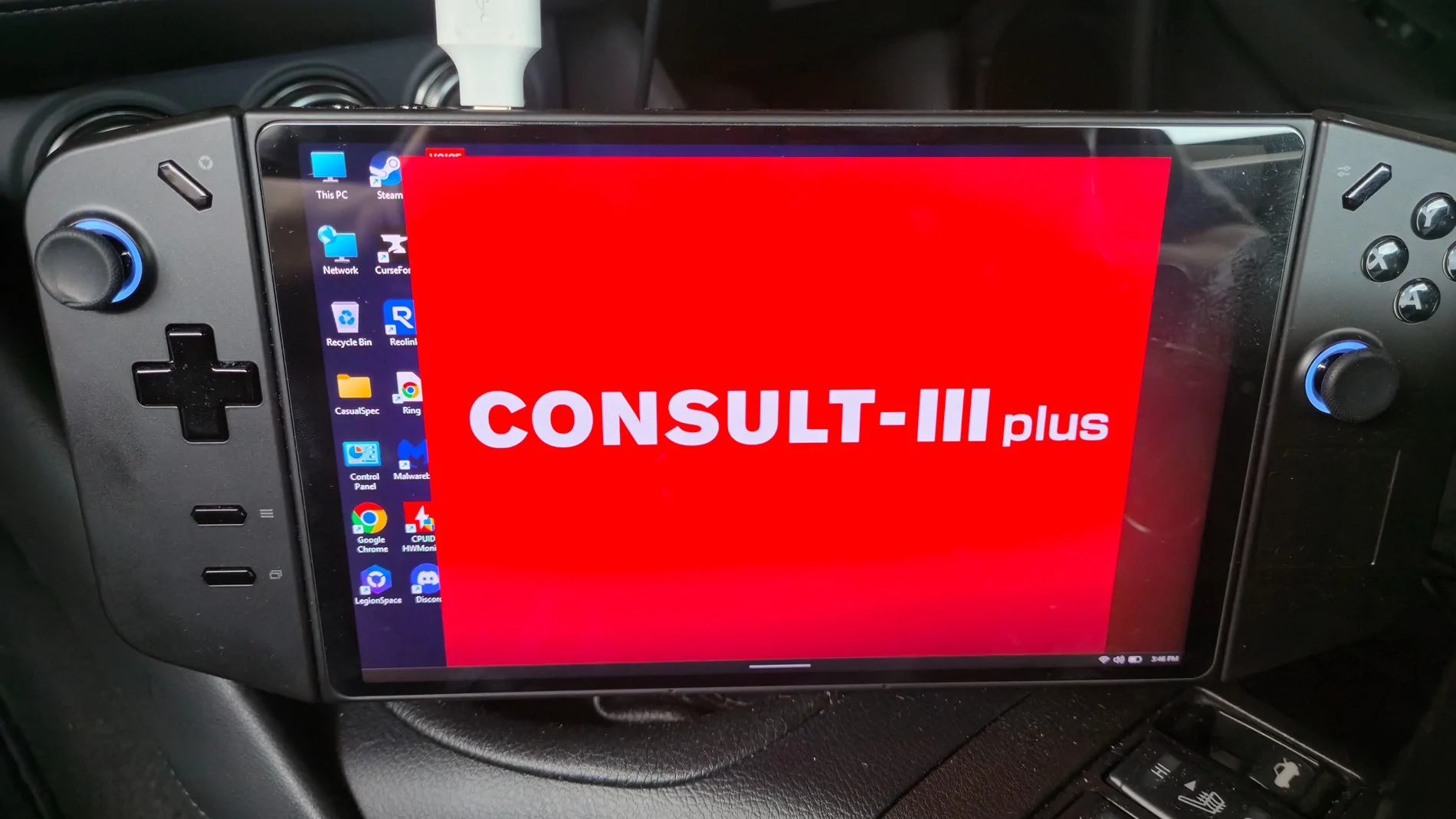

i did mines. bought a VI. used my legion go gaming handheld. havnt tested yet but, now im sure ill be able to hear my awe exhaust while windows are up. perfect with the legion go touch screen.
