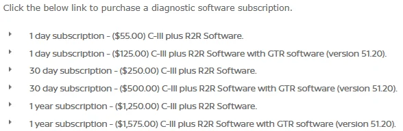

  • One day subscription to Consult III (link)

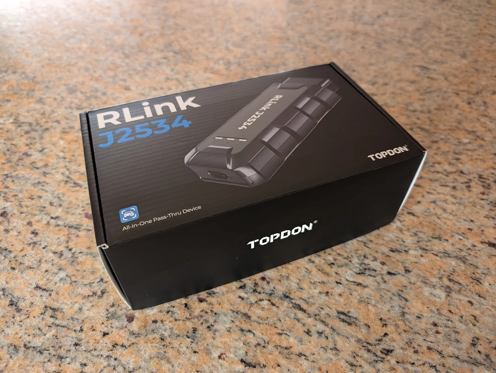

  • J2534 compliant device. I purchased Topdon Rlink J2534 based on rec on the Consult III page

This is awesome! Thanks for sharing. I found the pricing for the one-day subscription.
EDIT: A previous post had shown $35 for a one day subscription. The correct price is $55:

Is this the RLINK you purchased?

I paid $55 for the one-day Consult + R2R, looks like you found a less expensive option that excludes R2R (whatever that is), nice work.
Yes that’s the RLINK I purchased. There may be other less expensive options, YMMV.

$55 for one-day is the correct price. The $35 was for one day of document access.

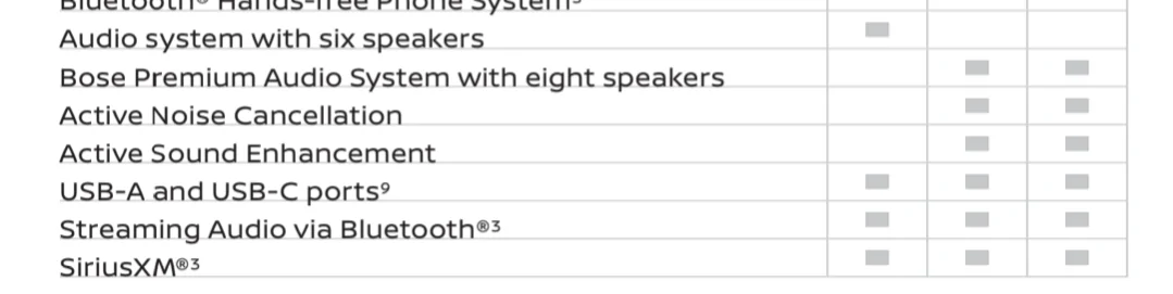

Hold up.... what the hell is ASE, ANC, ANT, and all the other stuff you guys are talking about????
This thread has some info.
It's these items from the brochure:
ANC is Active Noise Cancelation. As far as I can tell this does nothing, but I don't have the best hearing.
ASE (also called ASC) is Active Sound Enhancement - fake engine/exhaust sounds.
Both features of the Performance and NISMO models. Not on the Sport model.
