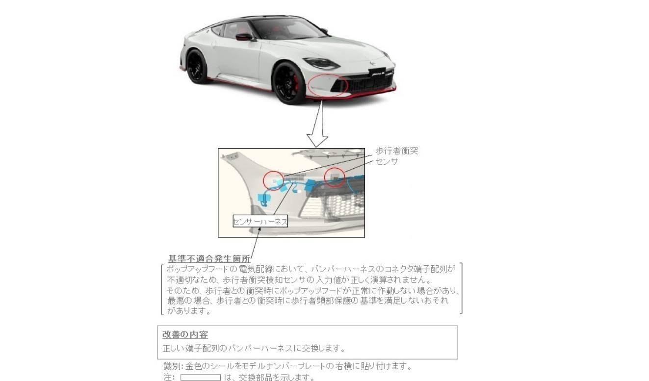

If you’re not then I’m definitely not ?
I looked deep into it and all it is...is just the sensor harness was installed upside down on the passenger side of the bumper( there are 5 sensors in total this was just one I believe) this makes it less sensitive or possibly not even detecting the impact on the side. I hate the popper system so no way im gonna have the dealer take by bumper off and have my car to fix something I wished didnt work to begin with
just my 2 cents everyone can make their own decision

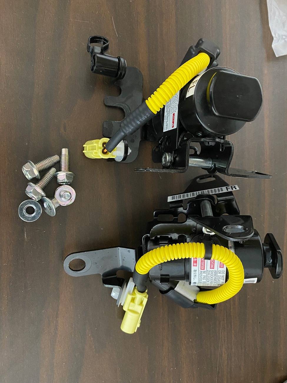

My hood poppers popped while driving. I took it in to the dealer on November 7th. Still waiting as they can’t get the parts. Turns out both airbag poppers have to be replaced. .

Oh man that is terrible. Did you hit a bump or something?

I have a set in stock...

Wow! There they are! A rare sighting of the impossible to locate poppers! My dealership still doesn’t even have a lead on getting them in smh
