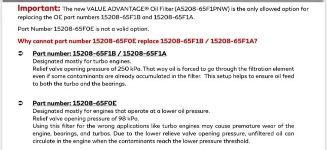

None of the aftermarket filters have the correct bypass pressure rating. Nissan does this to protect the turbos from contaminants. Its unfortunate since I typically prefer running filters with 99% efficiency @ 20 micron (as info, Mobil One filters are 99% @ 30 microns).
The correct filters (3) for the VR30 are: Nissan 15208-65F1A/B/E

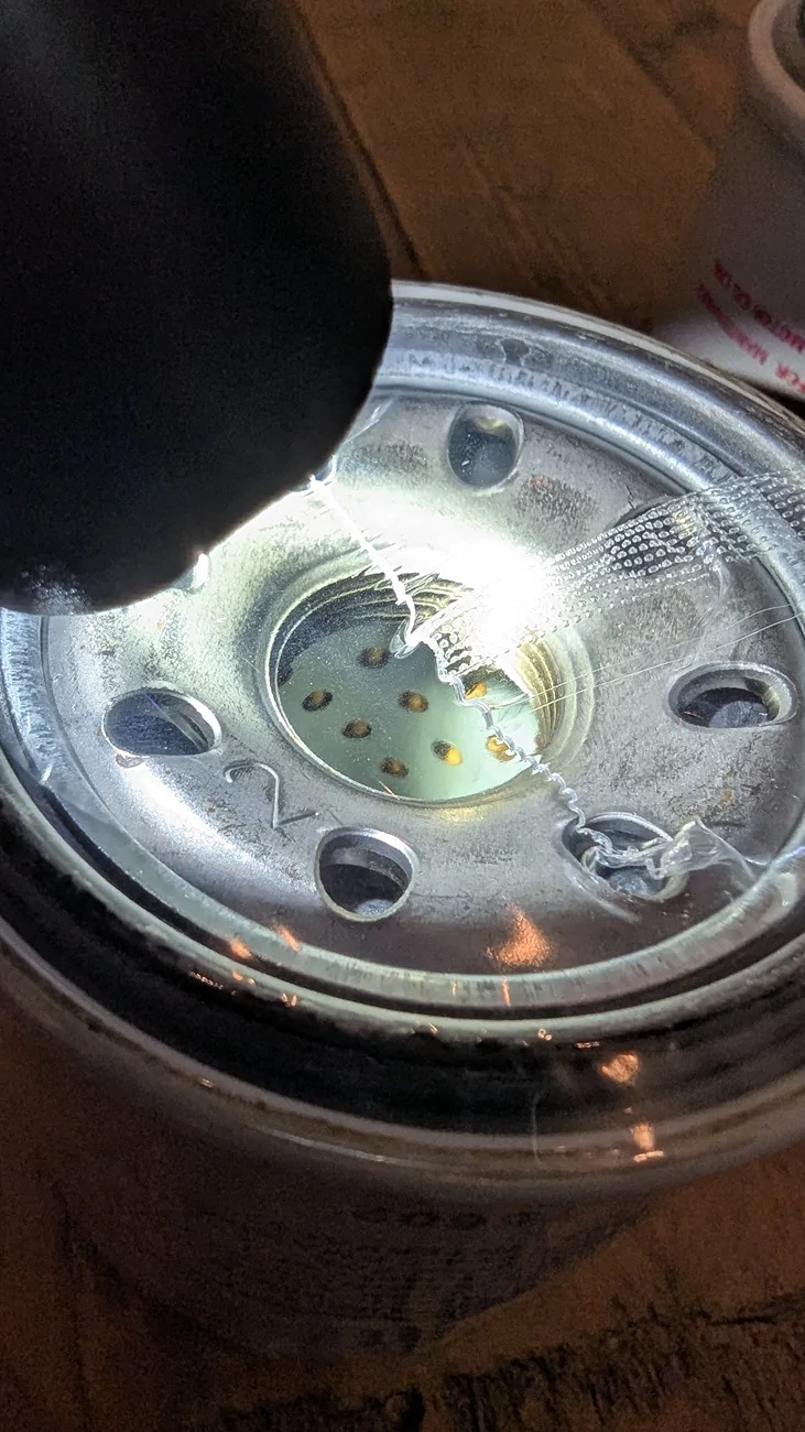

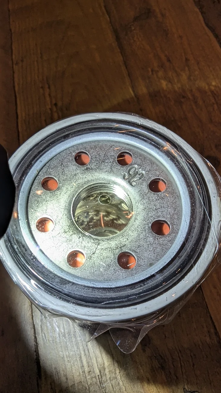

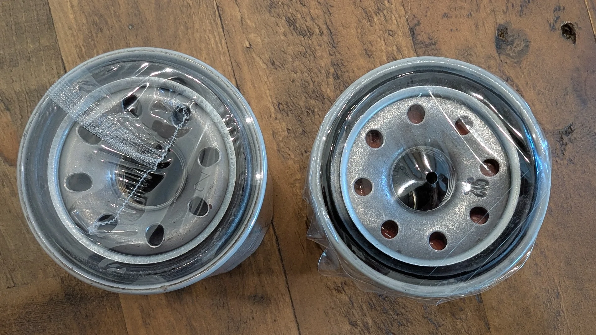

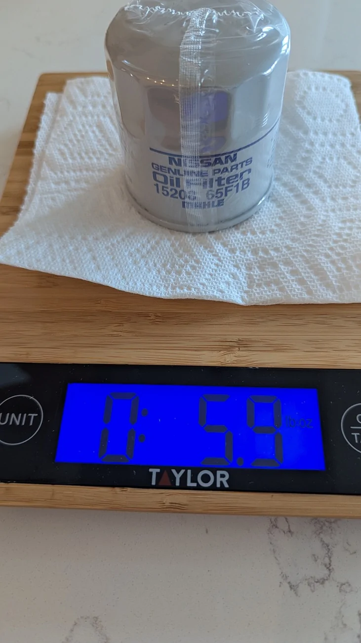

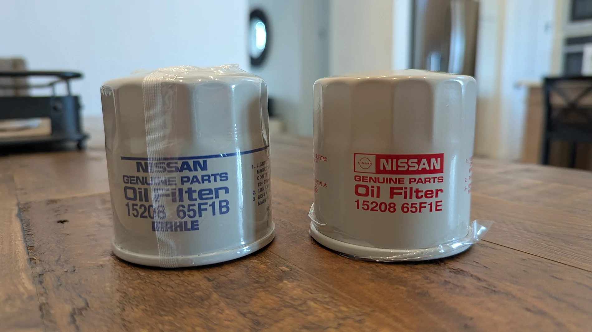

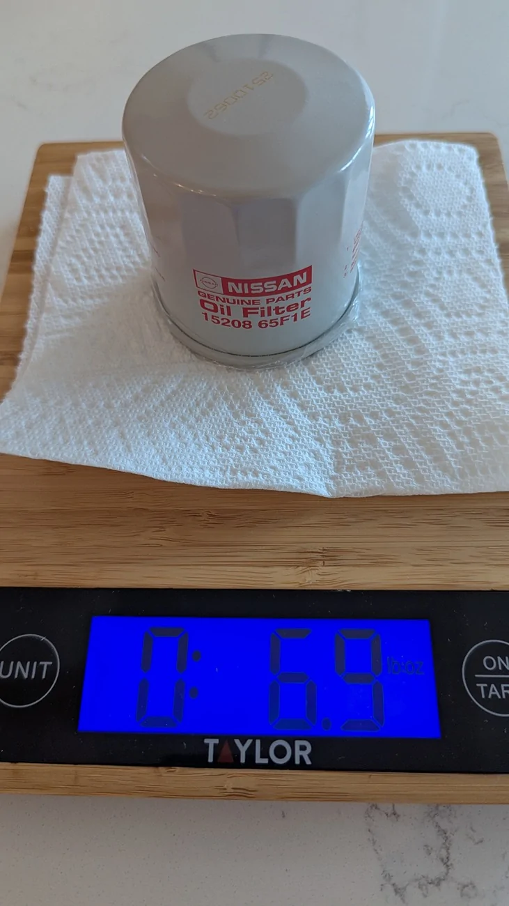

So which model number are you guys running?
A is what comes installed from the factory, B is made in Japan by Mahl (with a nearly exhausted supply, a few vendors on eBay still have them). Most dealers have the E in-stock (made in Mexico by Gonher - heavier w/nicer internal louvers).
B vs. E:
B:
E:
B:
E:

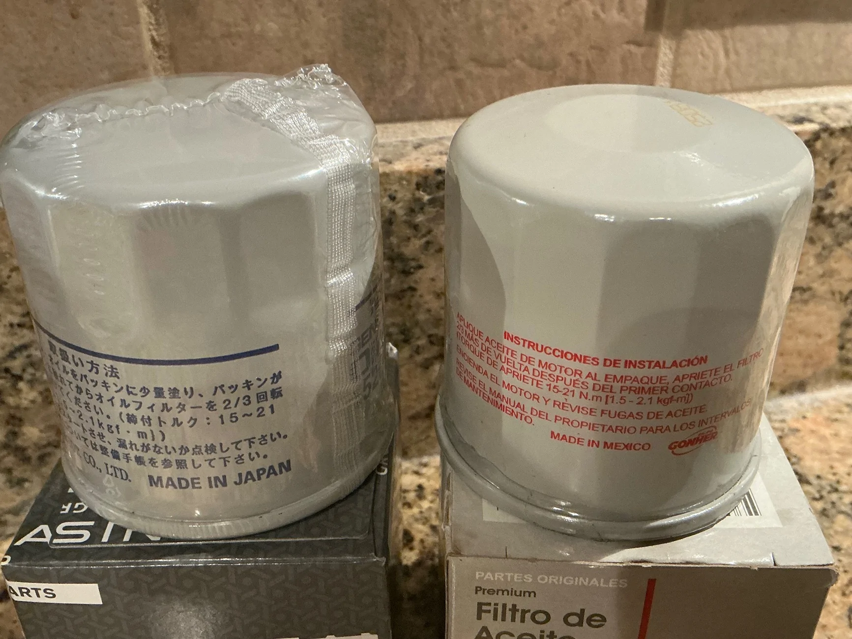

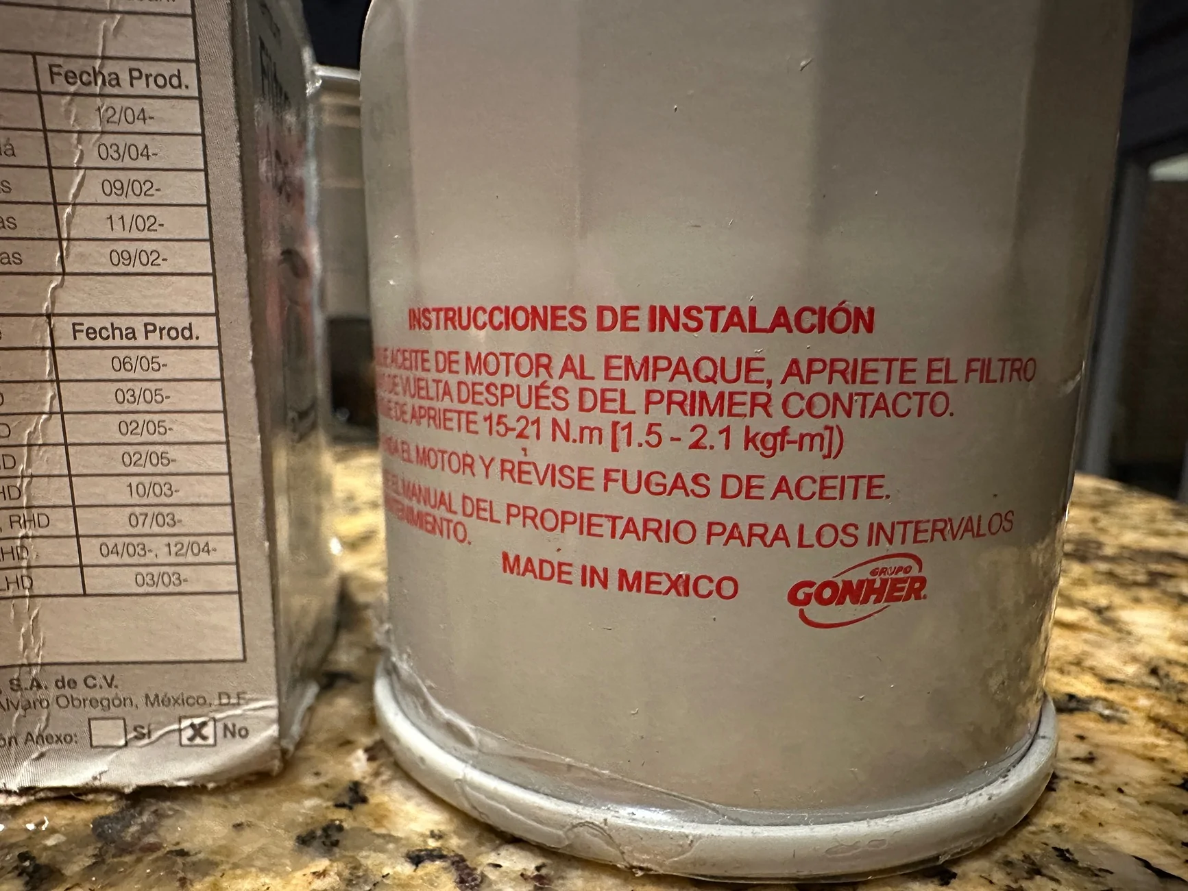

I’m sure the Mexico quality is just fine..
I will run the Japan version until i run out of stock - i just prefer the Japanese over the Mexican lengo
here’s a pic showing the “made in mexico” side…
