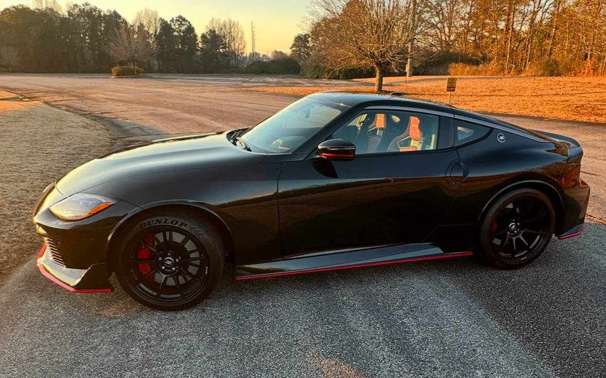

My car seems to be a few inches higher in the front than the rear (spacing between wheel and fender). Is there any adjustment for that? All the Z’s I see on the web look pretty even.
