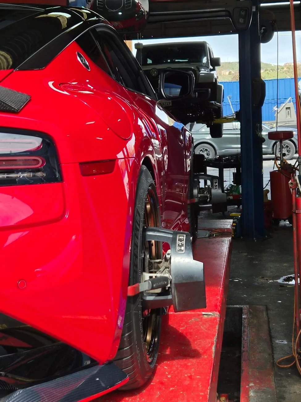

Got the car aligned and adjusted negative camber. I'd say it closed up that gap a lot better. Probably could have gone a bit wider on wheels initially, but I think this is as far as I would want the wheels to the fender.

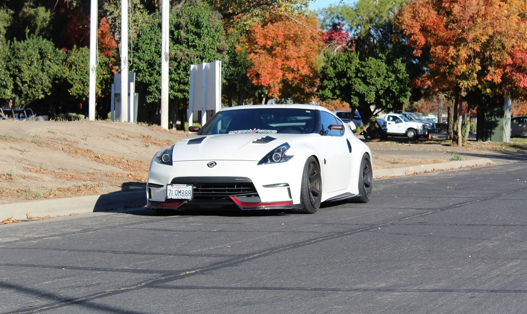

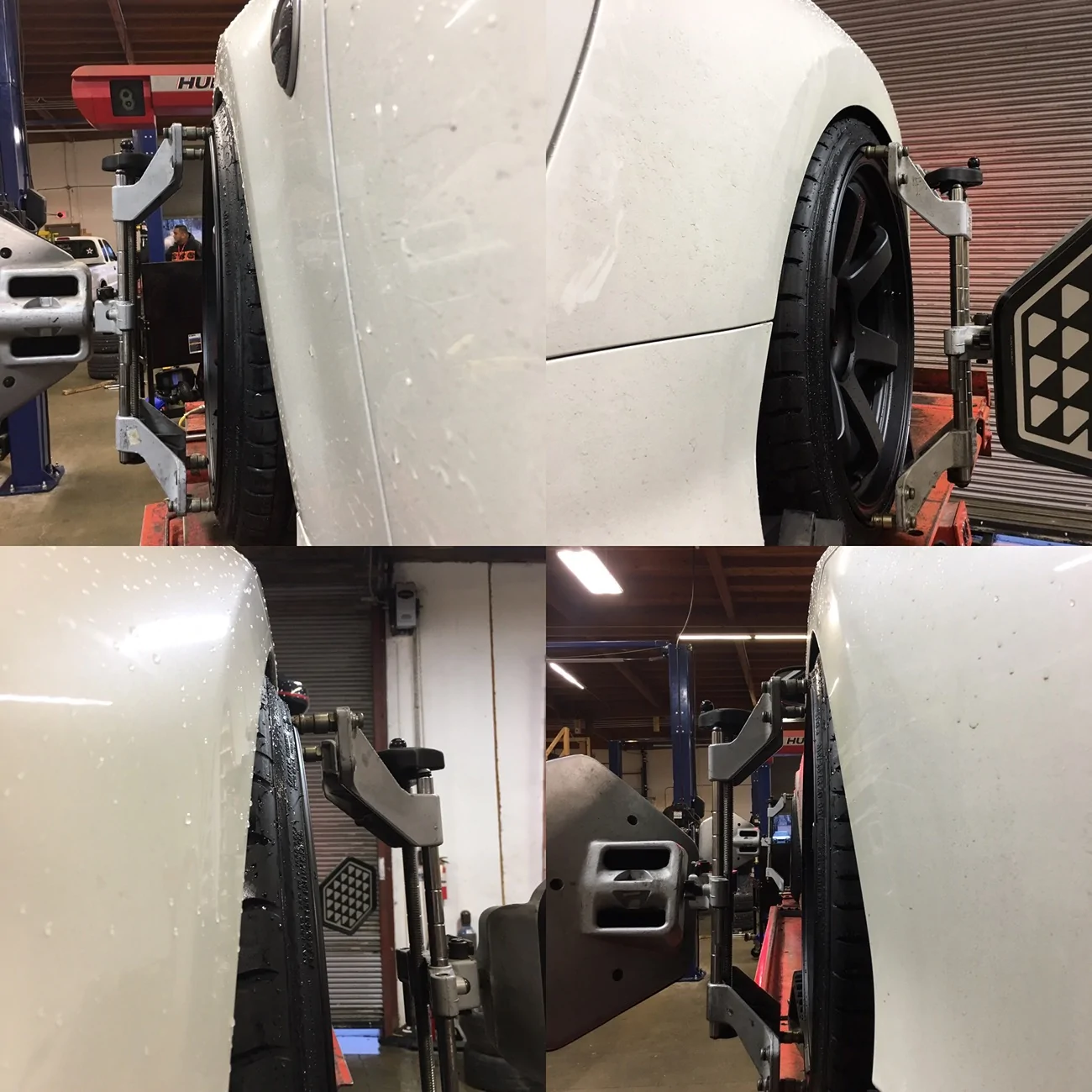

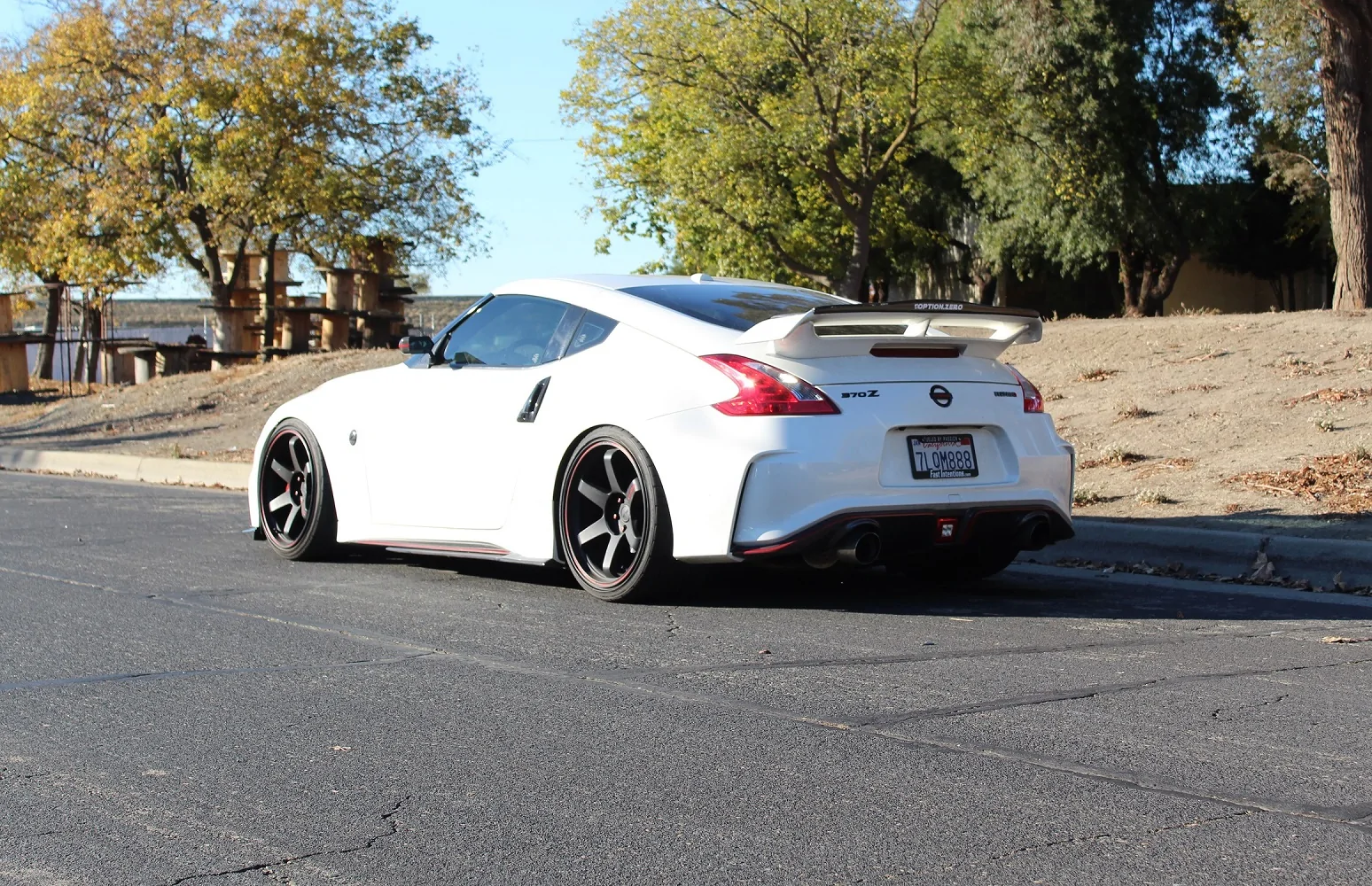

When I had those wheels, i was on straight Aragosta Type S coilovers. No rubbing in rear. Fronts, had to relocate a front bumper tab inward.
rears are rolled from the factory
Fronts are pulled a bit
now I have Stanceparts air cups on top of the coilovers, all 4 corners. Air cups operate as normal coilovers until activated, then provide 1-2 inches of lift as needed. When deactivated they do nothing.
These do not affect fitment as they dont change static alignment. Got them to save my front bumper/lip
Now running three piece wheels for more aggressive fitment since one piece wheel sizing is more limited
19x10, -1
19x11, -6

I knew you were knowledgeable and have experienced with fitment. Flawless!!!

Thanks for the information! Looks good. Hopefully your liking the 3 piece fitment.

I think this looks good. Wider tire and you might have to add some camber unless you are running a super stiff in the rear. How much camber did you set it too in the rear?
IMO if you are rolling or pulling fenders then it is not a perfect fitment.
But Id say OptionZero you made it look perfect for your setup.

Head up bro. That setup is straight baller. The fitment is near perfect. Size and stance is 👌 IMO. That color combo on dem Meisters. 👌👌 I have seen 100’s of RZ34’s on wheels here and yours is my favorite.

Will you be at JCCS this year? Like to check out your fitment and specs, great setup!
