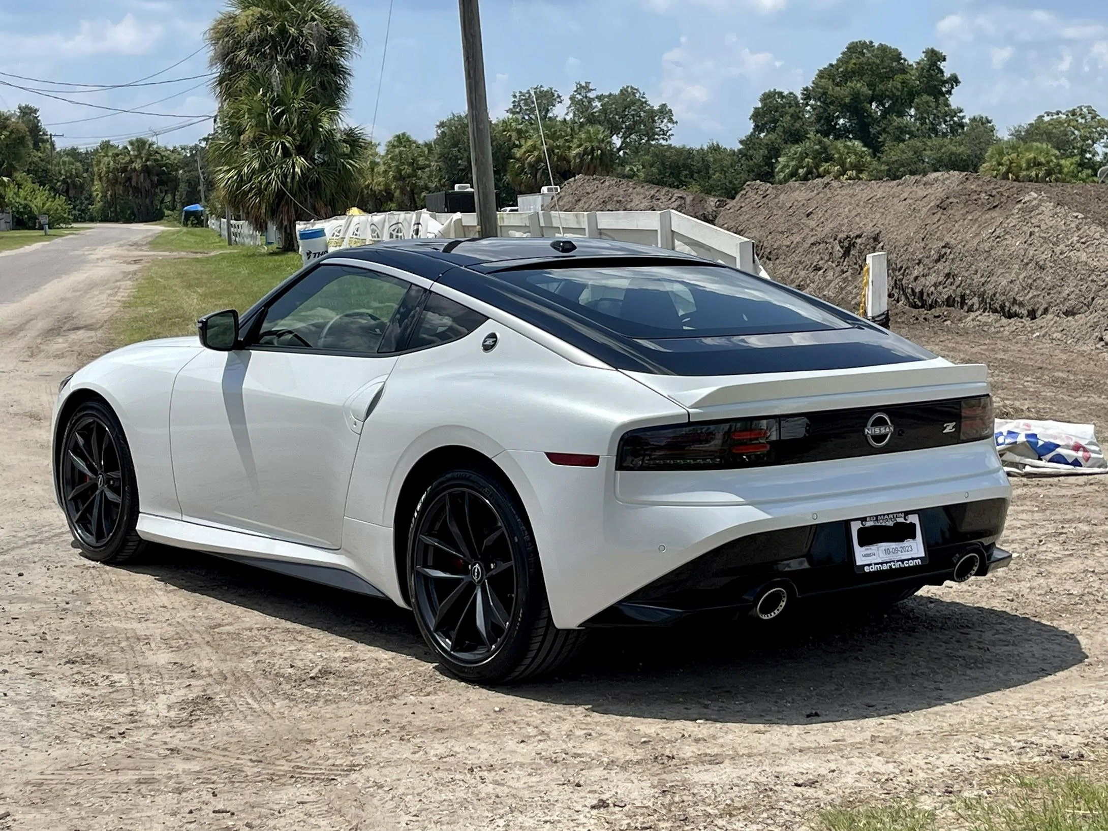

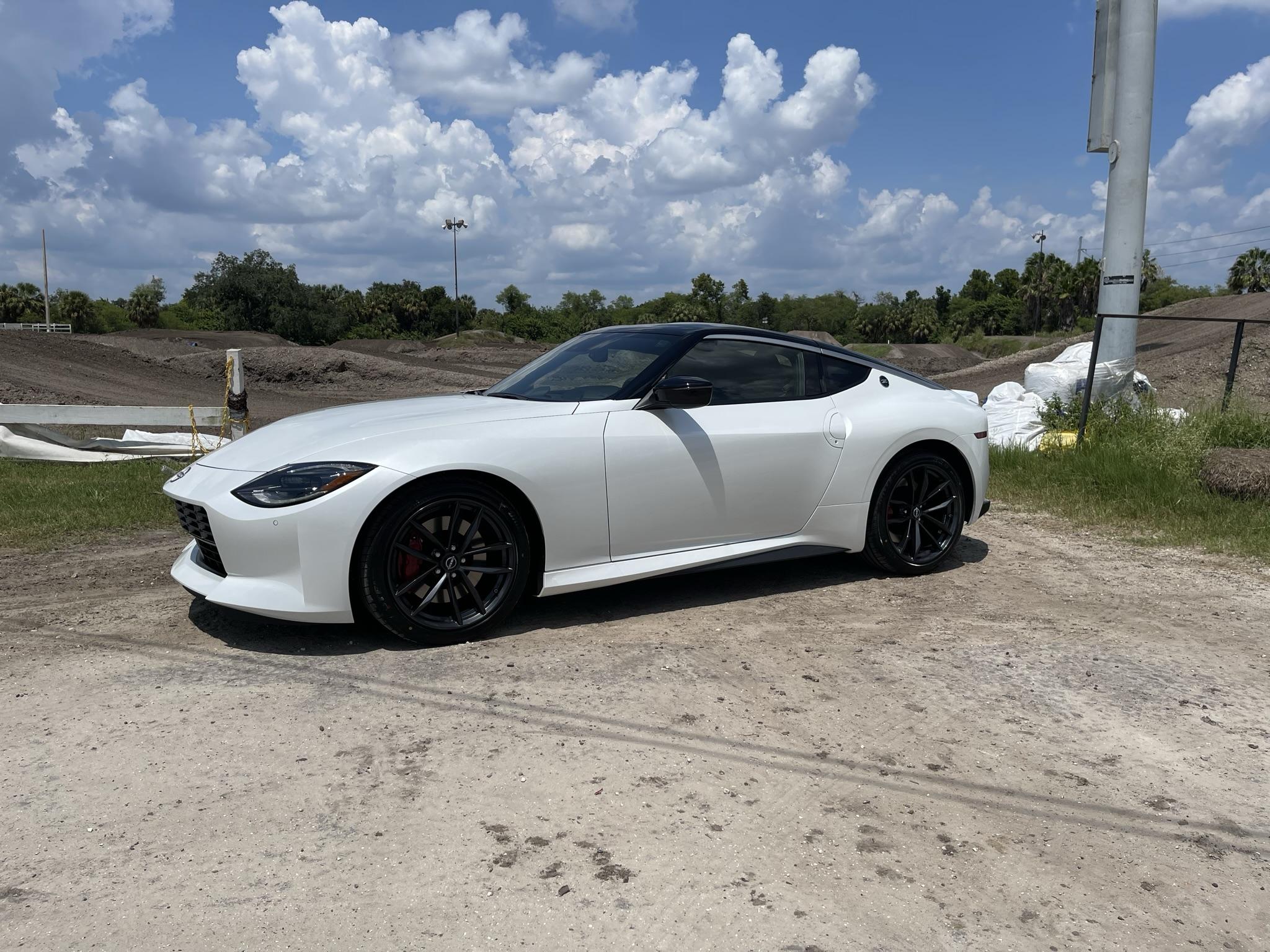

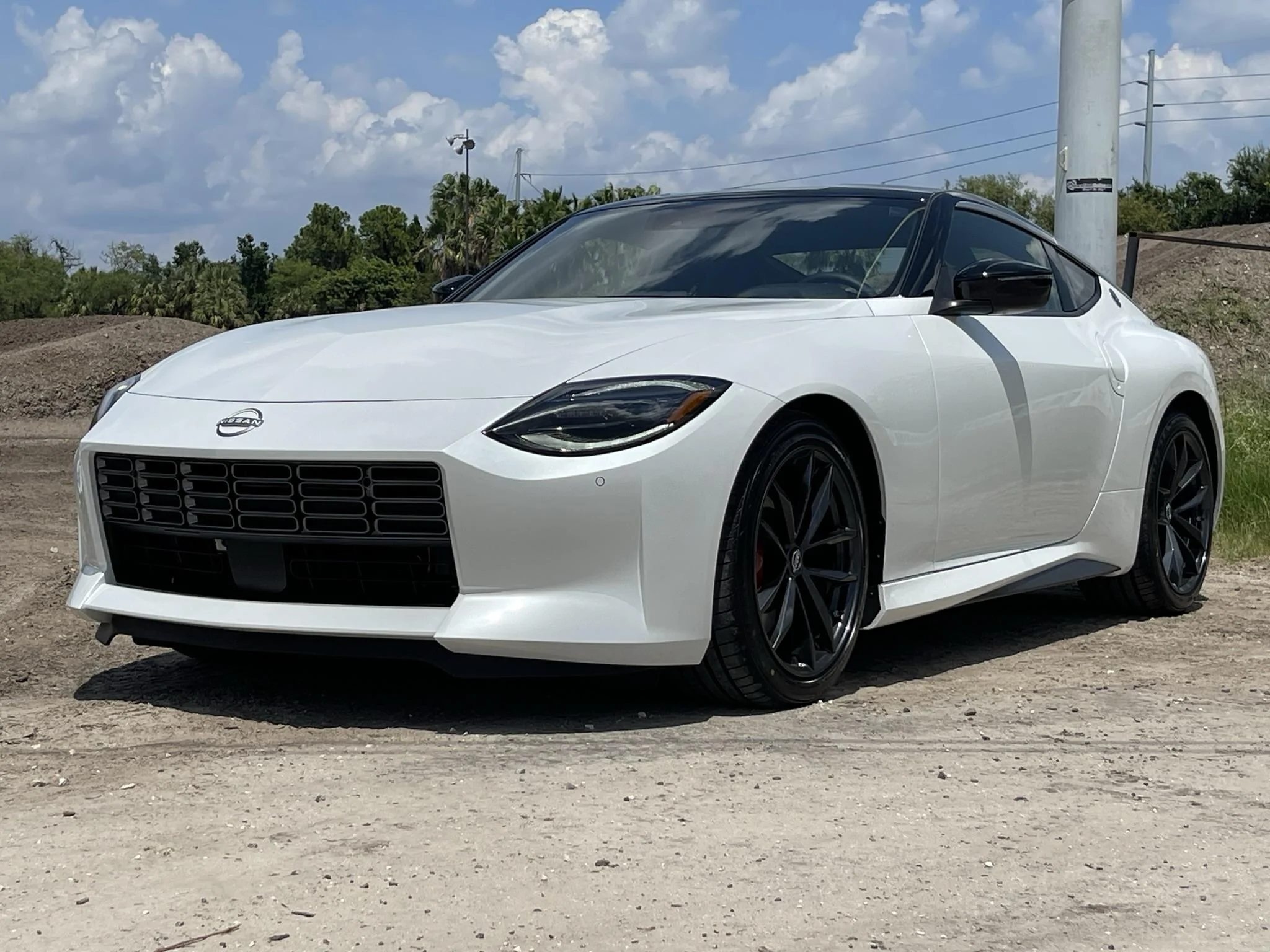

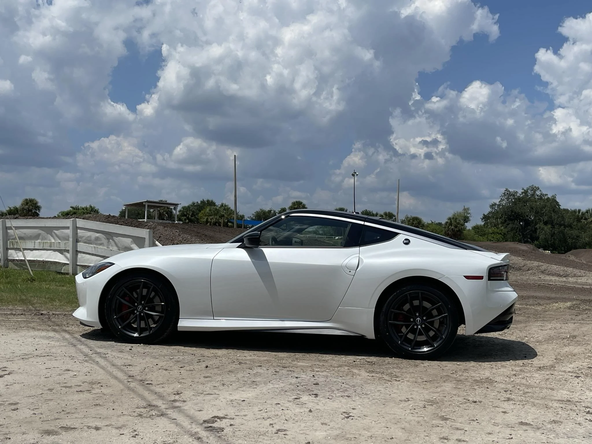

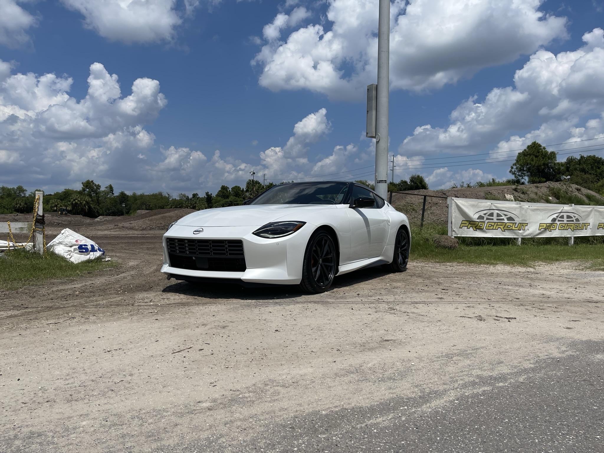

I feel like I was in the car all day and we only put 85 miles on it. Break in periods suuuuuck. First impressions are great. Though we haven’t went over 4k RPMs and 1/4 throttle, you can tell she wants to stretch her legs. There is just something about how this chassis delivers power that makes me smile. The front end feels a little floaty but I did notice the tires were over inflated. Correcting that should help a little. The exhaust is so quiet I thought they rolled it off of the truck. Strangely enough, the sound inside the cabin is pleasing. So from an engineering standpoint bravo. It will have to be upgraded ASAP though. That sound needs to be delivered to everyone. Haha
The interior feels like home having previously owned 370z’s. What some may consider minor updates, to me, really take it to a perfect level. I love that all the silver trim is now black chrome and though I would of liked color matching the interior stitching, the black is nice. It seems to have all the features I look for in a modern interior.
The exterior is so much better in person. I do not think I’ve ever experienced this same effect with another car. In photos I’ve always despised the front end. It looked like a clash of 3 different designs mashed into one. I’ve spent the last two weeks shopping for parts. A good portion of that time was deciding what I wanted to do with the front visually. It grew on me quite a bit during that time. Now seeing it in person I have no real complaints. It definitely needs something for my taste but it isn’t gut wrenching like I originally felt. The car is absolutely stunning up close. The pearl white has to be seen in person to truly appreciate.
Overall I can’t be happier. Some say the price is too high. I think 54k loaded is just about right for this car. Yeah it’s got reused parts but heck, if it’s not broke, don’t fix it! I’ve always loved Datsuns and feel like I have a reimagined one now. Enough blabber here are some pics by the local motocross track.
That’s Tampa Mx. I rode there quite a bit when I lived in Florida. Following your build and looking forward to the next update.

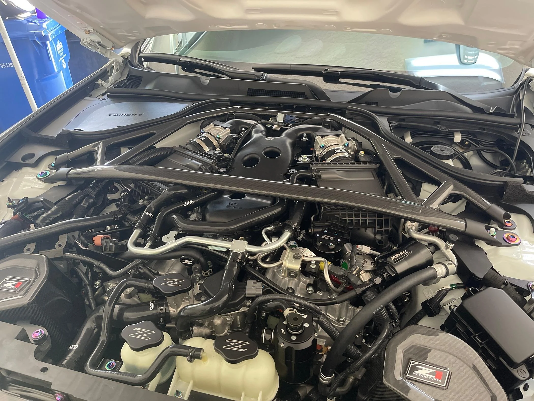

I had the shop put AAM silicone hoses everywhere while the motor was out. The main feed going to the intercoolers was too long and hitting the hood then pressing into the ECU. They should have cut this but didnt. So I went ahead and cut it since I had already spent the entire day fooling with fitment and the strut bar. Tried to close the hood again, still wont latch. I then decided to adjust the hood latches and boom it locked. The only reason I didn't try this first was because you could visibly see the hood bending in the middle as if it were hitting something when fully depressed.
So I take the car to the gas station to top it off with some 98 and try to bring my E content down a bit more since it will be sitting a while. When pulling up to the pump I start to hear a terrible knocking noise. To keep this a bit more brief I have no idea what it is. It goes away with throttle so I do not think its bottom end or top end noise. Ive just spent heaps of money on this car and I dont want it sounding like a **** box. My first thought was I got air trapped from opening the coolant system. Next morning I go get some coolant, drain the entire system, and refill it with my vacuum bleeder. Start the car up. Got excited because I couldn't hear anything at first, then it started making the sound again! So it wasn't air, but that's ok the system needs to be properly filled after opening it up. You can pretty much only hear it from inside the car as well. SO im clueless as to what it could be. I went out and just "sent it" figuring if I blow it up I guess I will just build the block. I took a log and sent to my tuner hopefully he sees nothing and its just a phantom rattle of some kind.
Somehow I managed to talk a 4th body shop into at least meeting with me during this time above. They agreed to hear me out and take on the job. Insuring it will be ready in time for the show. "Fingers Crossed" In my area what I'm running into is no one wanting to do anything beyond insurance claims. Its quick easy money. The custom work just doesn't pay as well. Especially considering the quality of most kits that get brought to them. I told the lead guy that will be working on my car not to go out and hurt himself until my job is finished LoL. He had a bunch of photos of 240s he worked on years ago before this insurance meta started. They all look great as does the insurance work I was able to see.
The phantom noise I will try and figure out once this damn body work is done. Bad pic but the engine bay is coming along nicely. All thats left is installing CF engine cover, HKS CF radiator cross beam cover, and GroupeM CF Ram air system.
