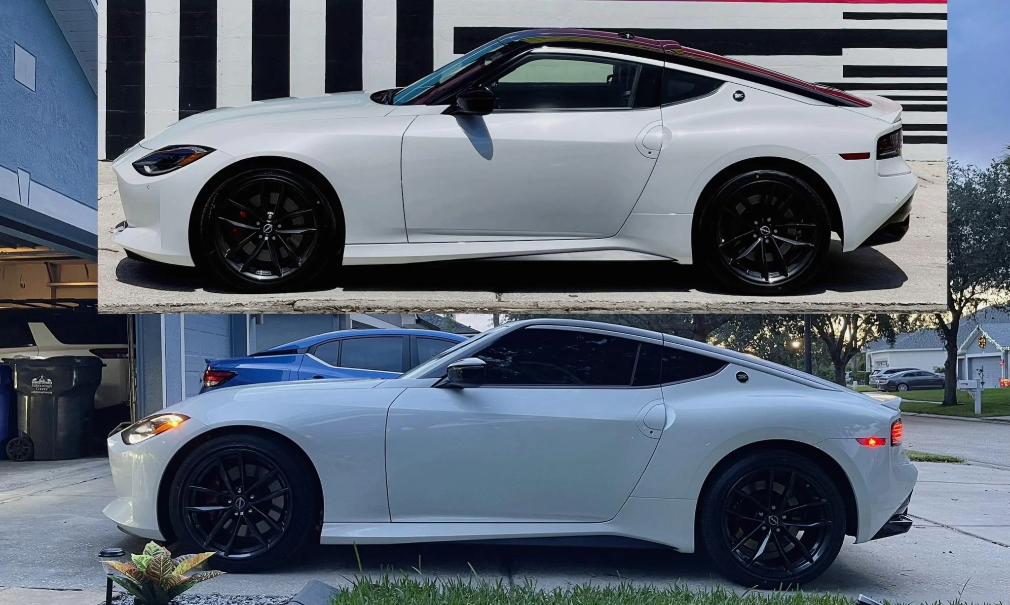

Swift springs got delayed again so I cancelled and went with coilover. Z1 Motorsports R-Pro’s. Here is a comparison different angles so a little hard to see. If it doesn’t settle much I may drop it another 1/2”
