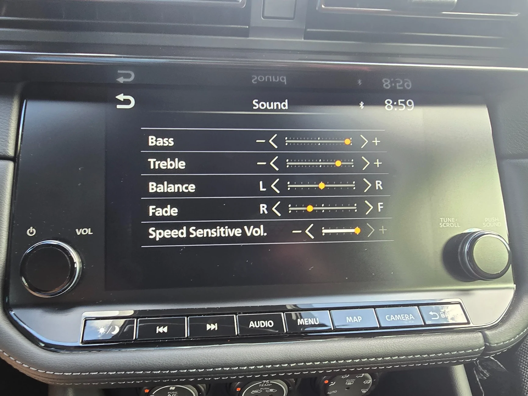

Can you take a photo of your settings? I've adjusted mine, and the bass still seems anemic.
Sorry for the delayed response, but here is a photo of how I have adjusted the audio settings. You can adjust the balance +1 F to have the sound come from the sides instead of being rear biased depending on your preference.
My reference song was Me and Your Mama - Childish Gambino at the volume of 30 and it fits my expectations for the audio system.
Overall, I agree with everyone's input that the audio in the Sport is definitely low quality and the Bose in the Performance and Nismo models is very underwhelming and if you want top notch audio in the Z, you are going to have to fork up some money and upgrade components.

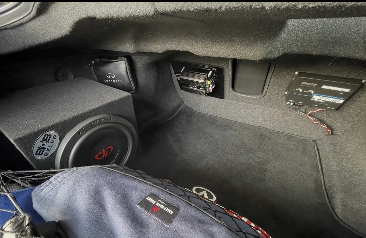

Hello Everyone. I'm a moderator on MyG37 and owned a 2004.5 G Sport Sedan prior.
First post here. Regarding the Bose in the new Z, do any of you know if the Bose amp is the same used in the G37/Q50? Knowing Nissan, I suspect its the same or very similar in its use of a balanced output.
If that's the case, you can buy an adapter that taps off the low level input to the amp and use the RCAs to drive a sub/amp plus DSP, similar to mine. This completely changes the personality of the Bose "Studio on Wheels" setup.
https://www.owc-upgrades.com/produc...io-interface-harness-adapters-platinum-series
Chris is the owner/engineer. Good guy if you want to call. He also keeps a list of compatible amps and can provide guidance if you decide to take this route.
Here's some rough pricing (I paid a little less because my installer of many years is franchised with DD and matched online pricing):
  1. Sub: https://www.amazon.com/SL610-D4-Shallow-Subwoofer-Speaker/dp/B0BMZG9PSH/ref=sr_1_4
  2. Amp: https://ddaudio.com/ss-series/monoblocks/ss850/ ($269, discontinued but newer model avail)
  3. Bass Restoration/DSP: https://www.amazon.com/AudioControl-EPICENTER-Black-Restoration-Processor/dp/B01EE3Y53Q
.75 cubic/ft enclosure was about $50, but since boot space is limited in the Z, I would likely run with something custom if/when I own one.
