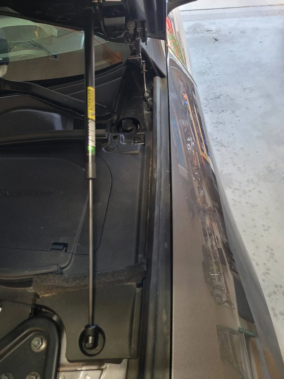

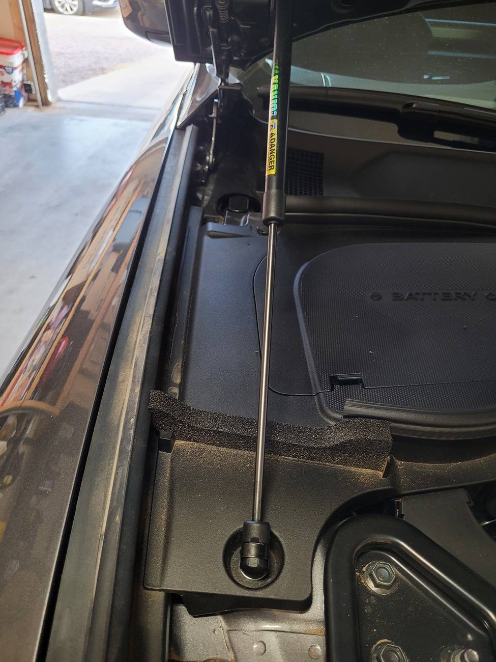

Price dropped to $74 US, so I bought a pair. I'll post after install.

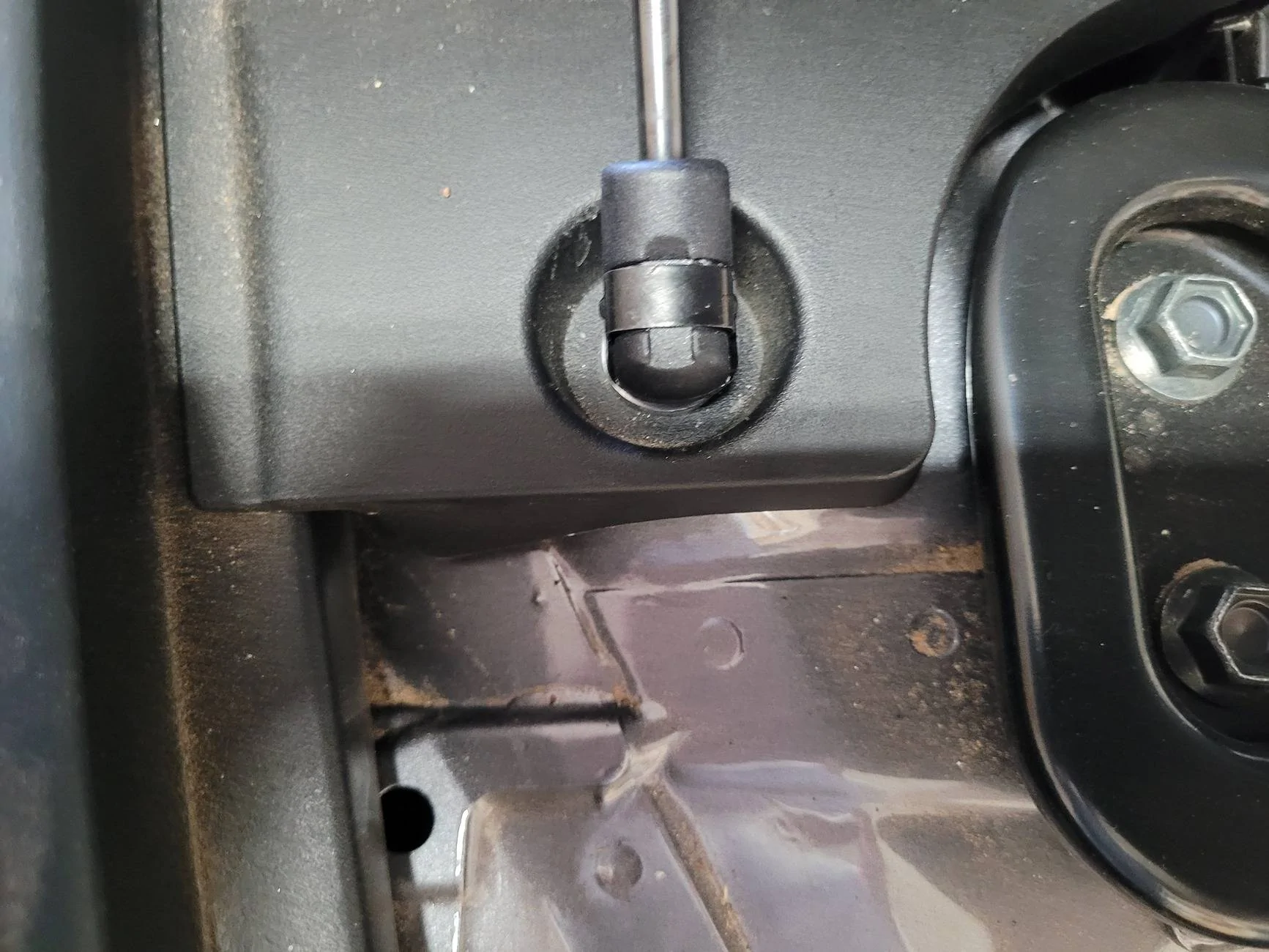

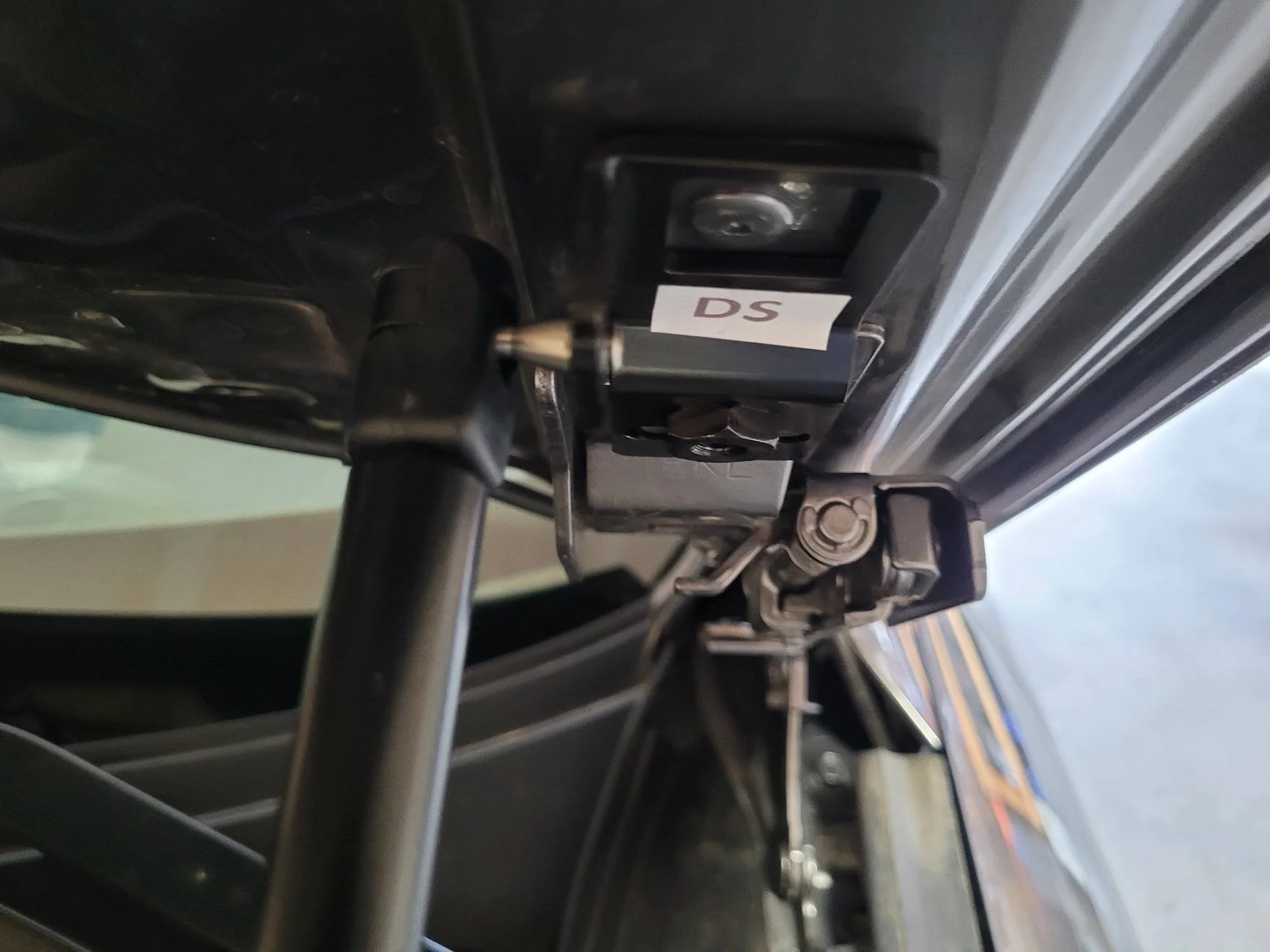

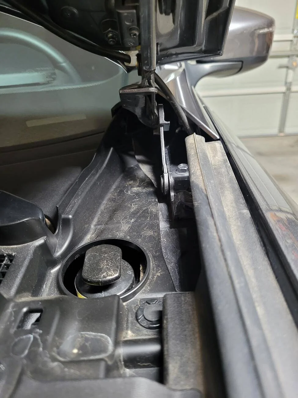

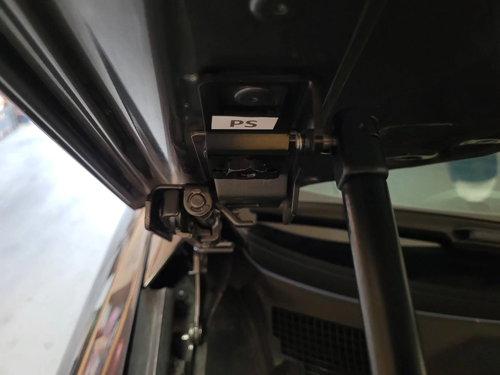

Install was ~30 minutes, finding the rachets/sockets probably another 30 minutes, but the Kanjo for the RZ34 fit perfectly. The videos on their website were close, but you do have to jack the car up a bit, the wheels don't have to leave the ground to get the clearance, so no need for jack stands (car never got high enough). I left the stickers on intentionally for the forum.
