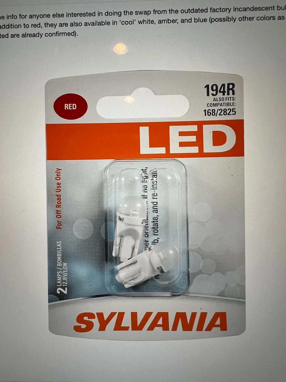

These are what I used someone posted them and I used the same.

Was using these, but I recently noticed (when I went to swap white out for red ones) that these bulbs “stay dimly lit” even when off. I swapped to this brand and it does not have the same issue
A much better brand. In my experience… basically they’re quite similar inside. A led is a led. Plastic case containing a diode and a resistor, some have a small capacitor. As it discharges, the LED can ‘glow’ for some time.
The cap stops the ‘flickering’ some people can see with cheaper alternatives.
Looks to me like the lenses & cases on the Sylvania’s are a higher quality than most. So you get what you pay for and the light should diffuse better. As mentioned, Some still prefer incandescent bulbs, or only ‘warm white’ LEDs.
