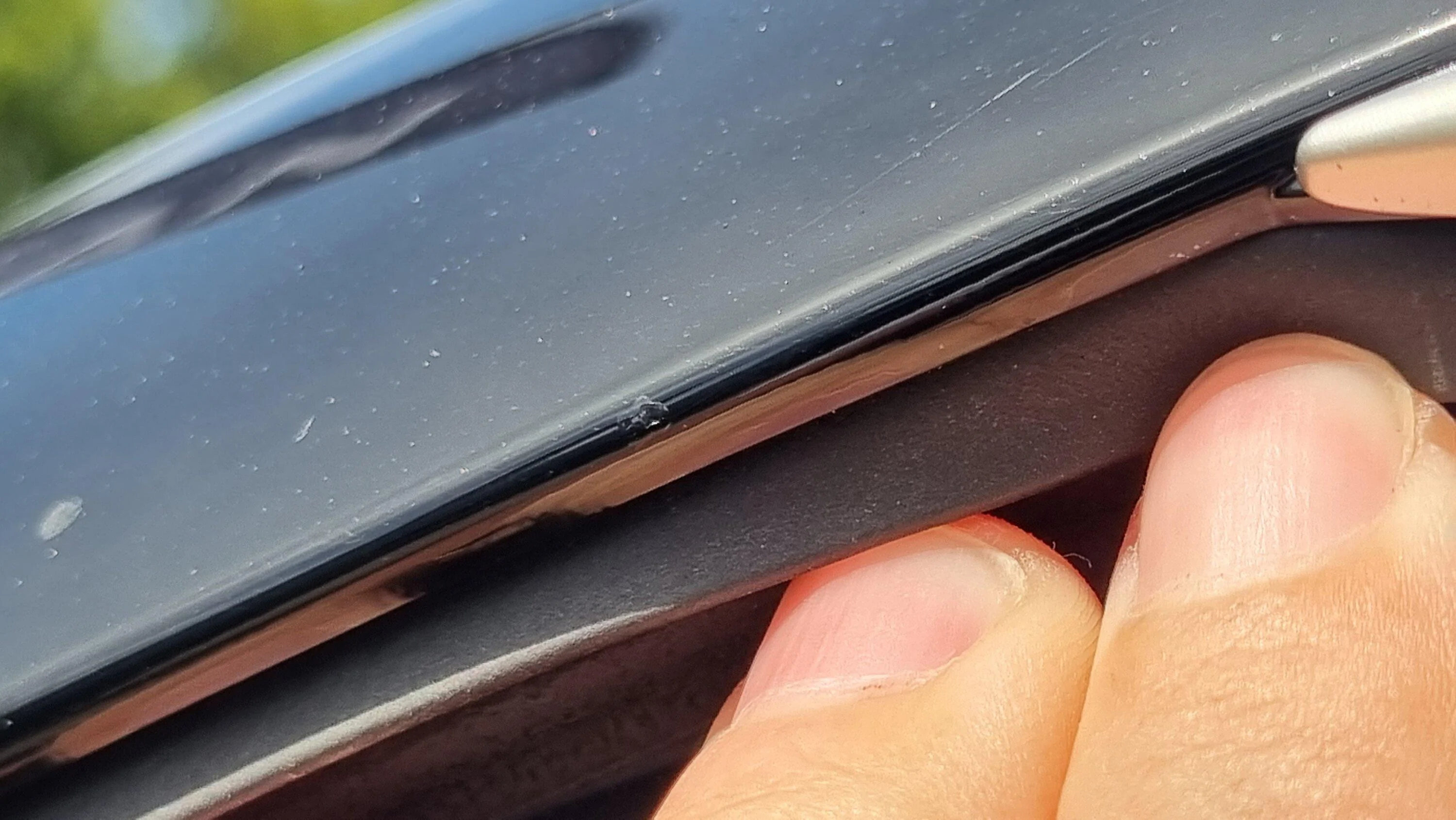

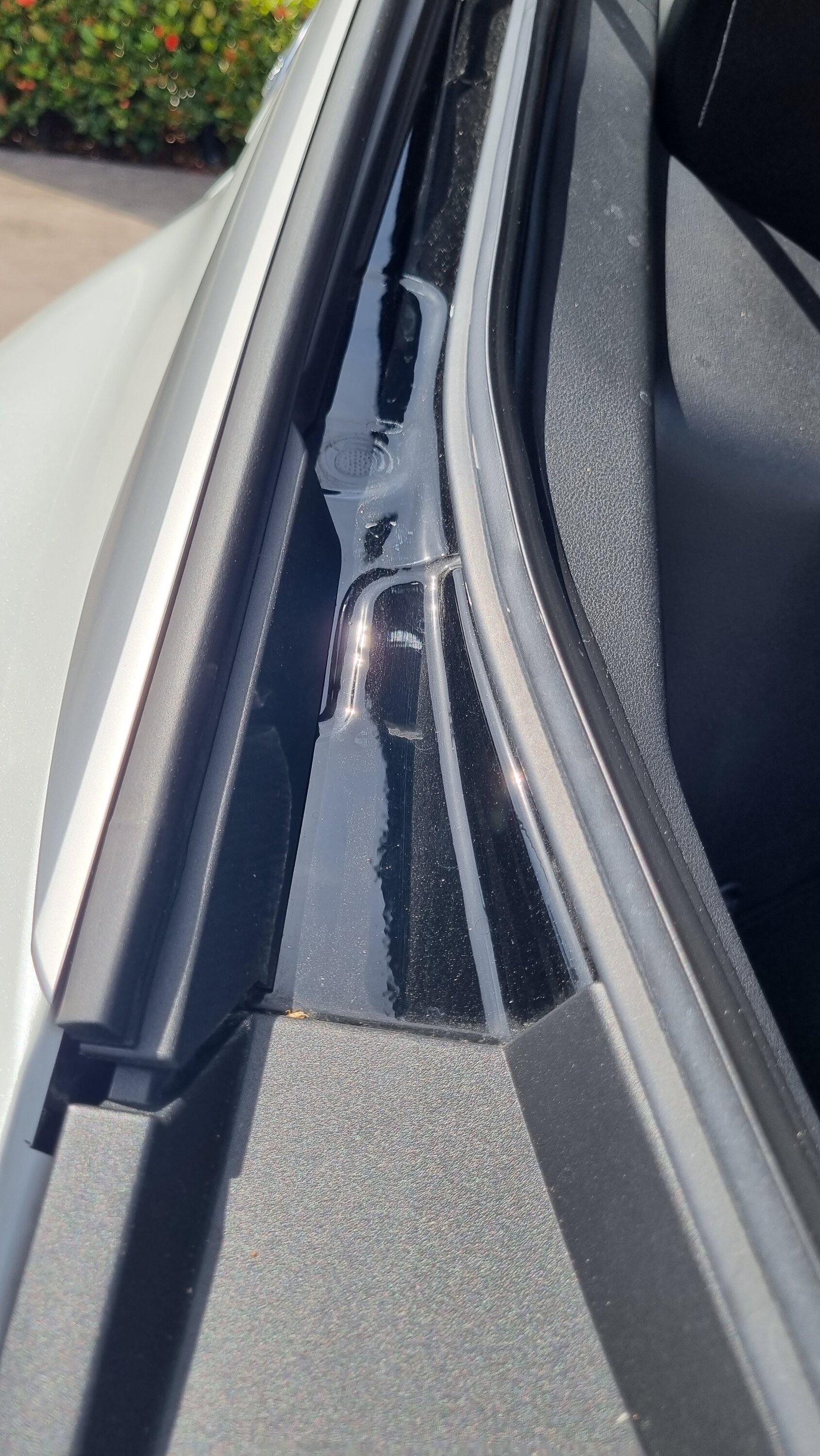

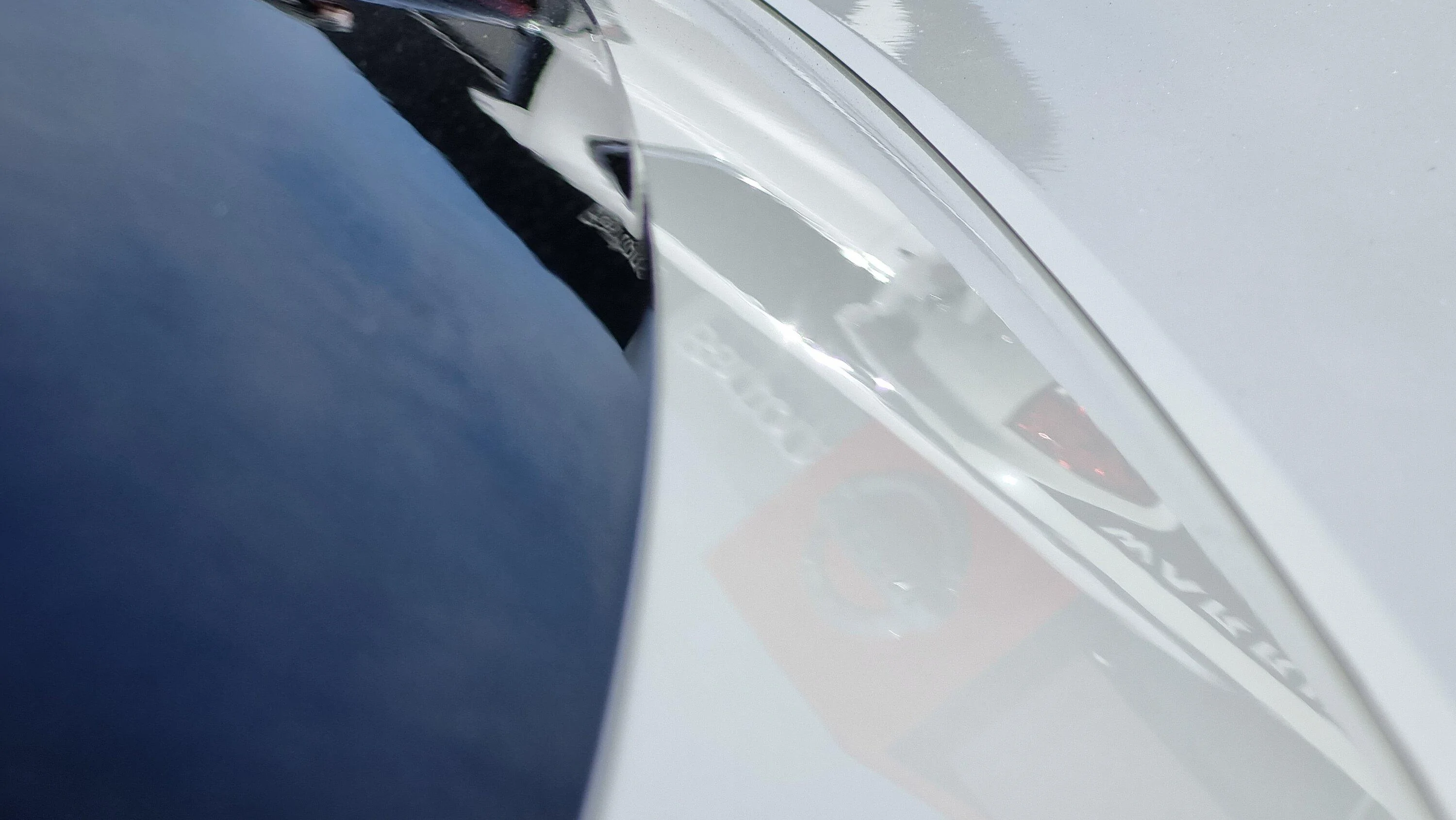

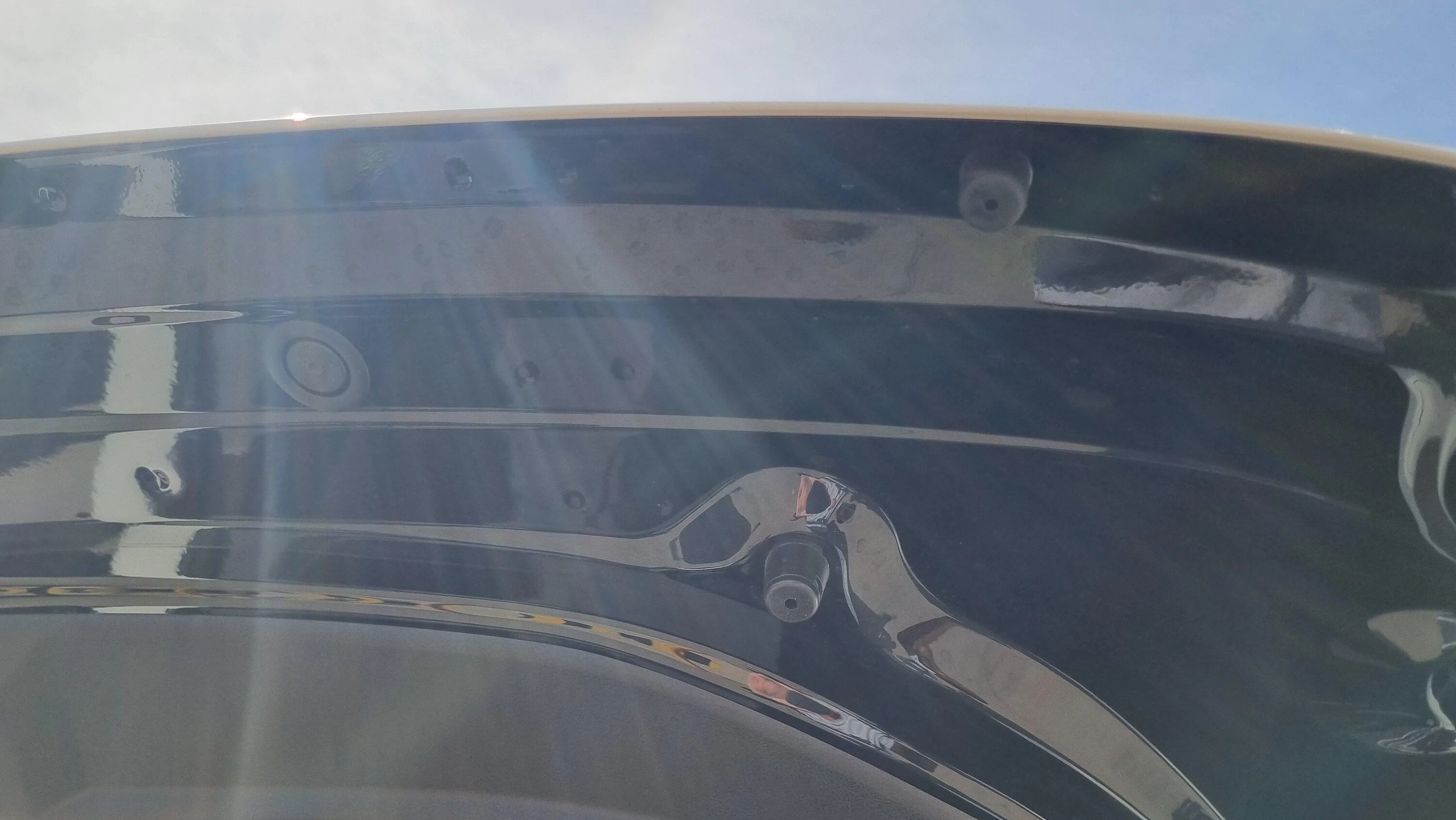

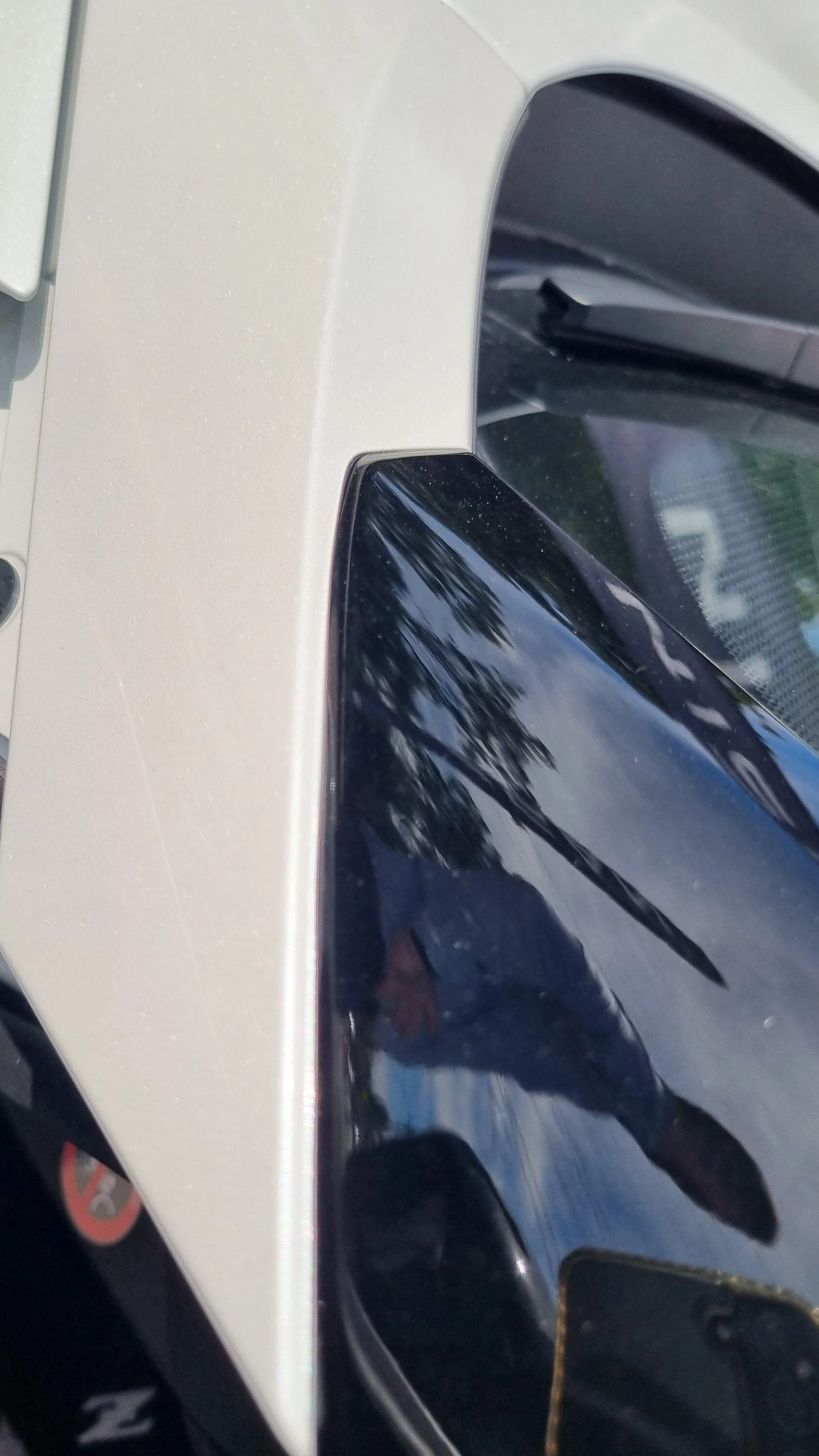

Ok I really want to put this to bed. I just went down to my dealer (still no news on my car :( )
We went and had a look at the Everest White demo with Super Black roof.
I will confidently say the roof and tail gate are both PAINTED BLACK based on the following.
a) there is a hard line across the back of the hatch above the spoiler where the black goes over the white. It's a big step and you'd expect clear coat to cover this, but it looks like the black is laid down last. We couldn't scratch or lift it up. A wrap would be VERY prone to lifting along here.
b) inside underneath the hatch is painted black. The inside has detailed concave impressions from stamping the part during manufacture. It's all covered in black and you can see the spot welds and every bump. This would be almost impossible to wrap
c) the inside of the car under the hatch is panted black. The white of the car does not continue inside. This has all the same detail as mentioned in point b
d) the black A pillar wraps around and inside the car. He wouldn't let pull the trim off, but there is no edge to the black that can be seen
f) this car is was sitting in the sun all morning at about 28C (82F) and none of the black was soft to touch, I couldn't make an impression with a fingernail etc (not the hottest place in the world)
