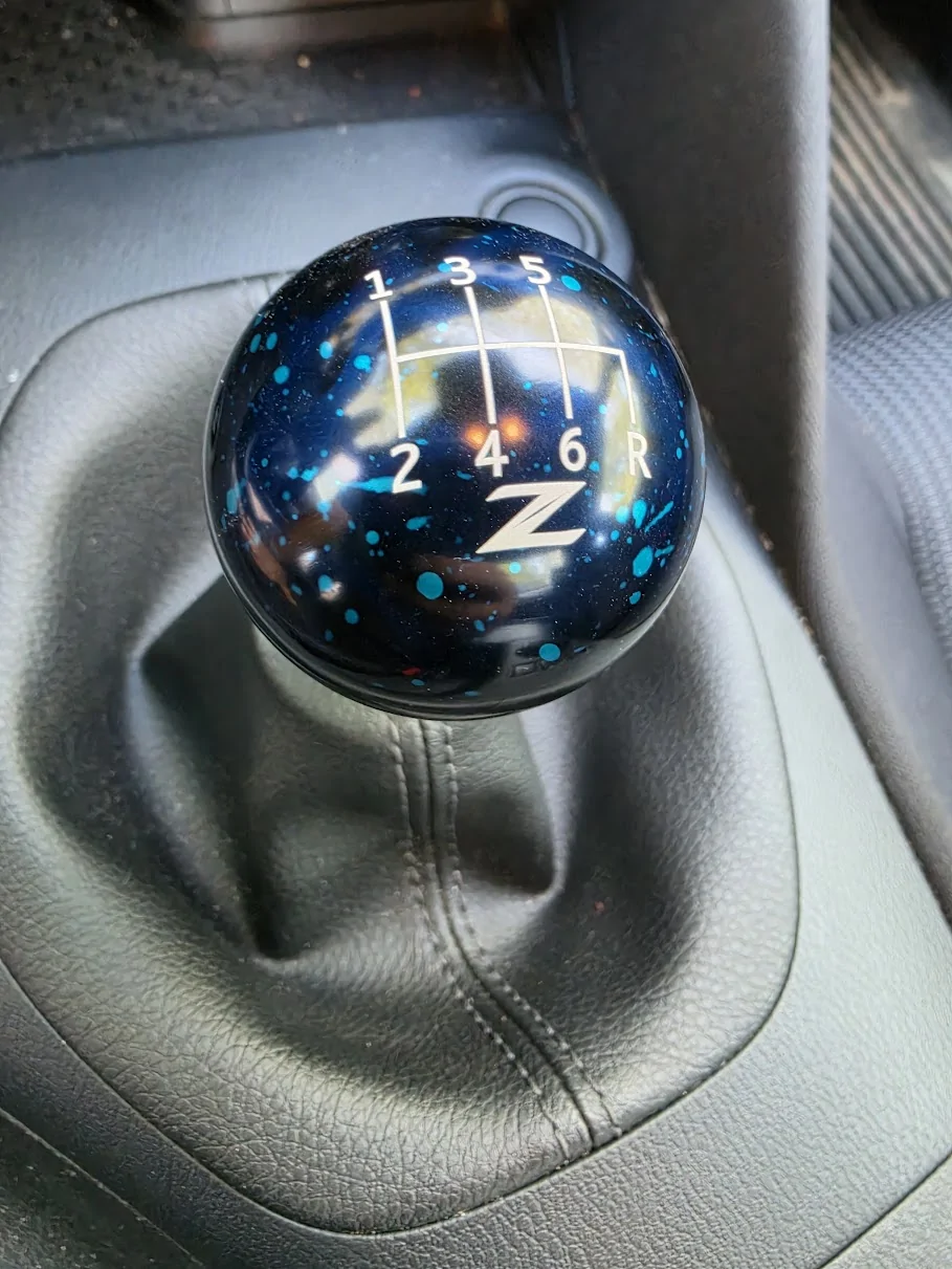

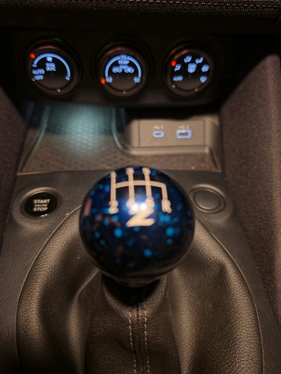

I replaced mine, it was a PITA but vise grips did the trick, also do not just pull on them when trying to break loose, keep one hand in the center as to not bend or break the threads off as I seen some have done, you need to keep the force centered by keeping a hand on the center and using one to break it loose. go slow and it will come slow but surely. I did straighten it as i know it is crooked in the picture. uploaded the final results straight.
