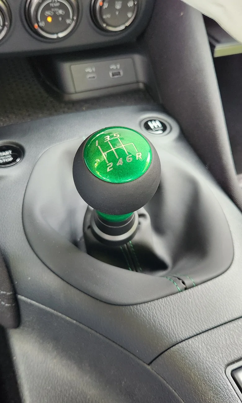

Holy hell. I read elsewhere this thing was tough to get off, but I wasn't prepared. Multiple people, multiple pairs of vice grips and a pipe wrench later, we were able to get it off. The stock knob didn't make it out unscathed, unfortunately.
With that being said, this knob from Z1 is really great. I was worried I wouldn't like the stick style, but I do. The weight isn't significant compared to the stock knob, so if it's weight you're after, this isn't it. You feel a lot more of the transmission given it's straight metal, which I think is my biggest compliment to it.

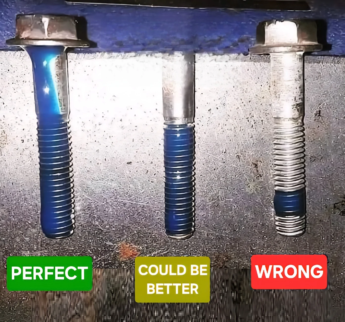

Nissan blue locktite training 101 🤣
