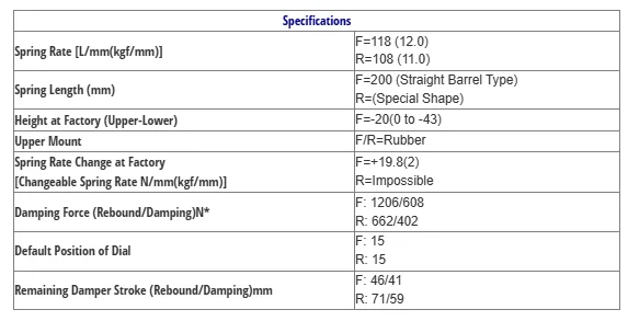

HKS Hipermax R is definitely worth the money, they have revised so many little details and lots of new technology has been put into this R coilover. It is not that stiff for daily driving, but definitely much stiffer then stock. HKS has claimed it to be the "All Arounder", capable of daily & track.
These would replace the factory Z-NISMO setup, so that's why I am considering them over the S-series.
Always err on the softer side especially if you are running a 300/200 tw tire. I would stay away from the HKS R for the RZ34, the spring rates a crazy stiff at 22/26k thats insane. they are for a R compound tire and a aggressive driver, you not ready for that.
As far as HKS you can go wit the Hiper S (12/11k) for the RZ34 or the Hiper R for the 370Z (16/18K )they are a bit softer but still too stiff imo.
What is the stiffness of the factory Z-NISMO setup? I don't want to get the Hypermax-S and be a downgrade.

The RZ34 spec HKS R has a 22kg front spring, thats 1230 lb spring, and a 26kg rear spring, thats 1450 lb. Thats insanely stiff, thats dedicated track car running slicks with a pro driver stiff. Dont do that to yourself, you will need a kidney belt for every drive.
HKS R for the 370Z is slightly less aggressive at 16kg / 900 front and 18kg / 1000 rear but still too stiff imo unless you are a track rat.
They will both fit the RZ34. Im planing of going 14 f and 10r.

Thanks for the advice. The HKS Hipermax-S seem to be closer to your recommended range.
