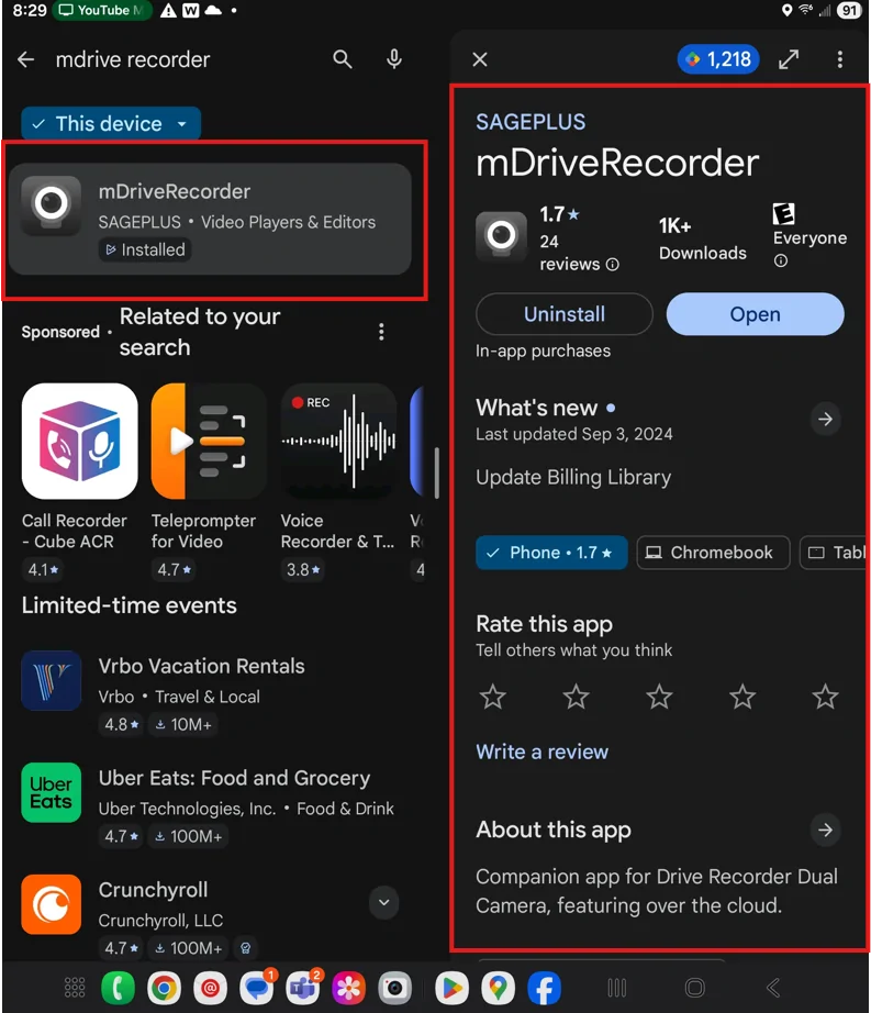

  1. Install the mDriveRecorder app from your app store.

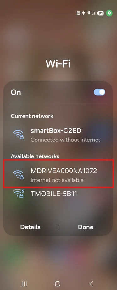

  2. Start the car and connect to the camera’s Wi-Fi. In your Wi-Fi list, look for something like MDRIVE***********
    PASSWORD: 0123456789
    • Your phone will probably warn you there’s no internet—just confirm you want to stay connected.

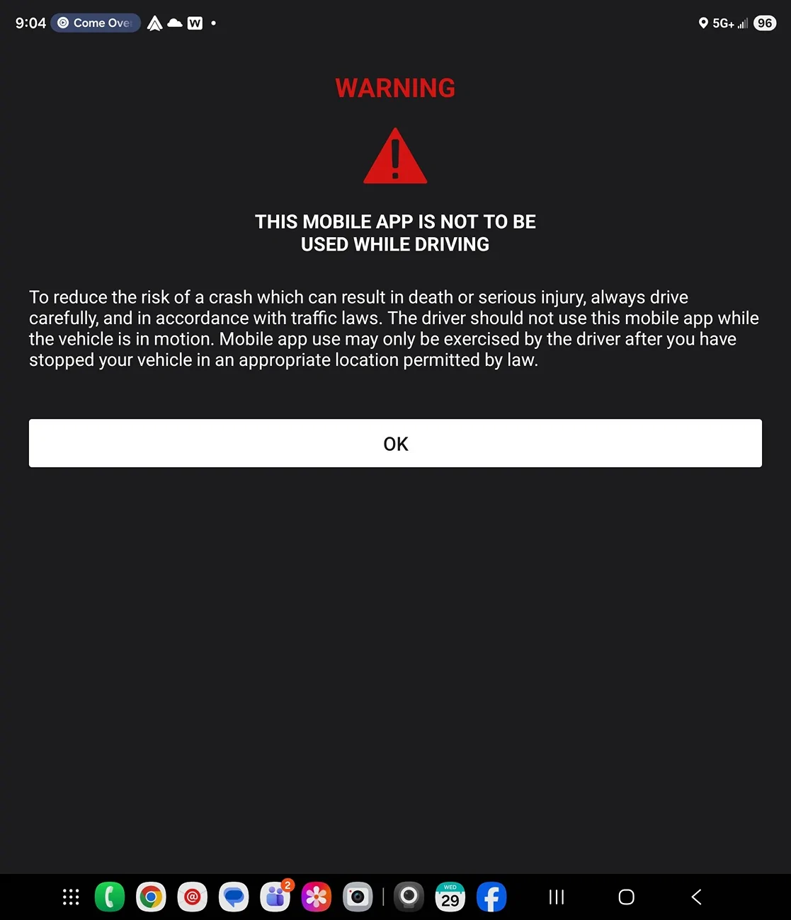

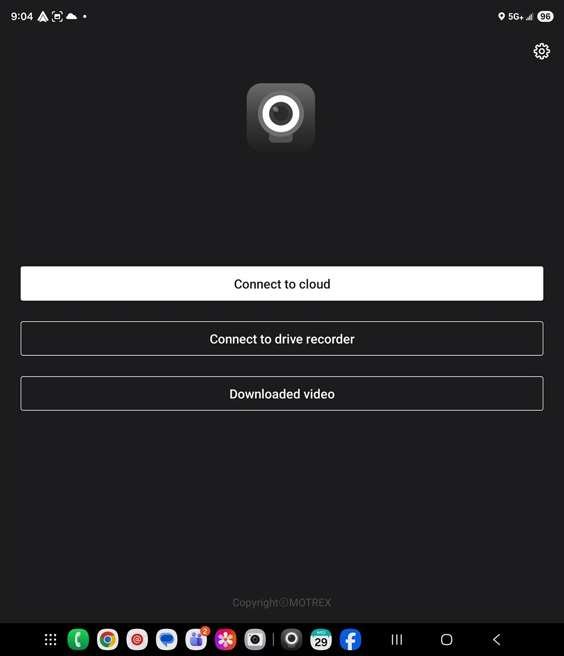

  3. Open the mDriveRecorder app and acknowledge the warning.

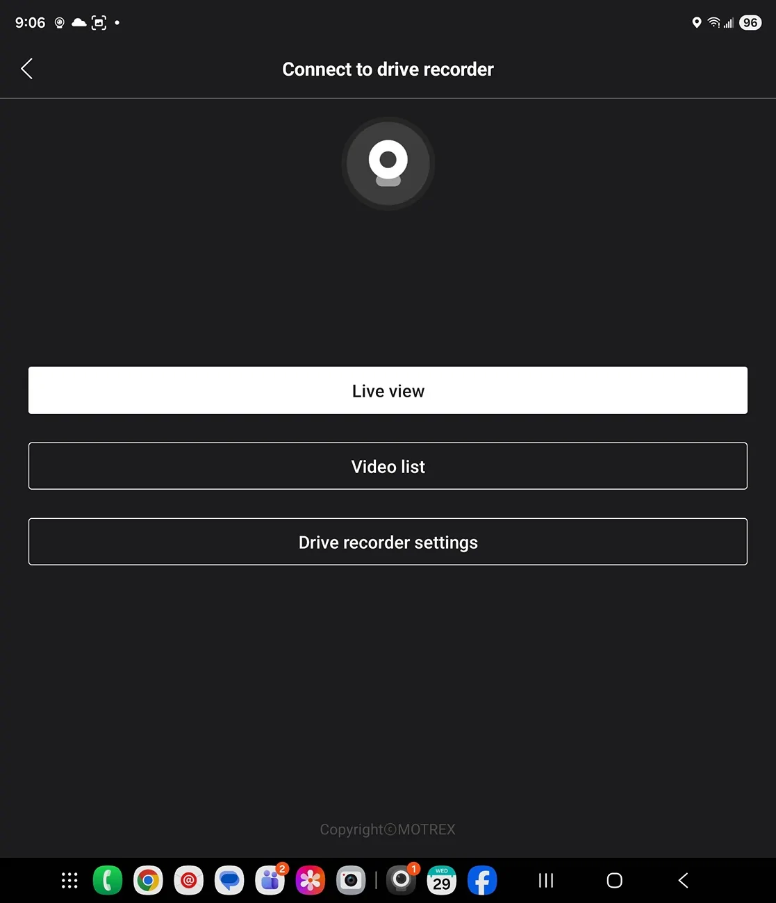

  4. Tap “Connect to Drive Recorder.”

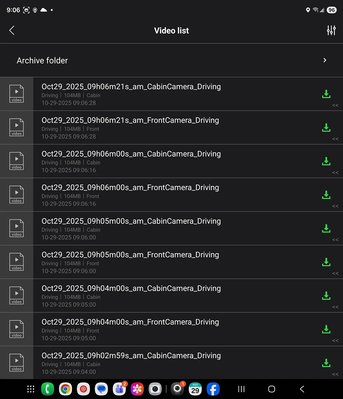

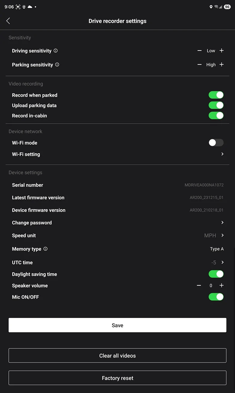

  5. From there, you can access Live View, Video List, and Drive Recorder Settings.

1. It has forward facing and rear facing (in cabin) cameras with audio.
2. Yes, very easy with the app. Or you can pull the SD card and load it up on your phone / computer.
3. Picture quality is average. Not great, but not terrible either.

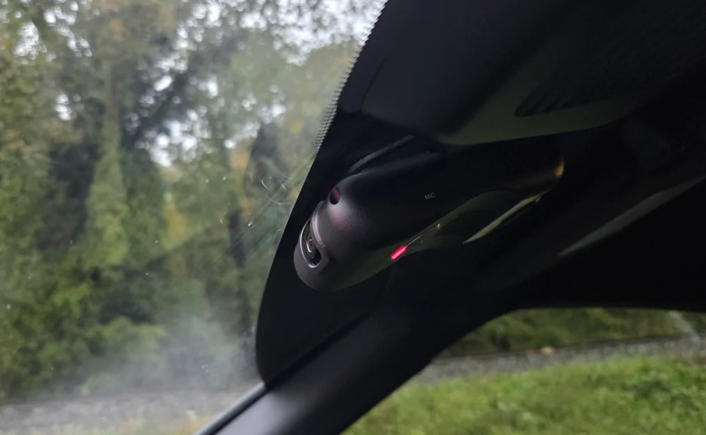

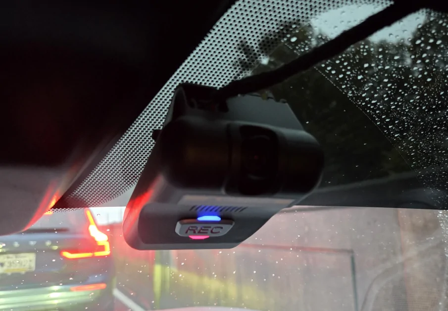

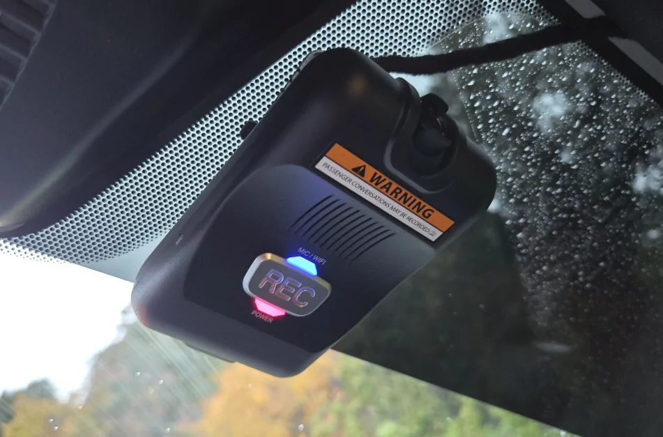

Could you include a picture of the dashcam? I bought a used 2024 Heritage, and I have been unsuccessful at getting a copy of the original factory window sticker to know what is or is not on the car. The Nissan Owner's web site has a "My Garage" page, which has an option to display the window sticker, but it errors and I spent hours on the phone with folks from Nissan only to be told to ask my dealer to get the sticker. Super frustrating, the manufacture can't provide me the window sticker. I read someplace that all the Heritages came with the same options in either MT or AT. I doubt my Z has a dashcam, but I thought I'd ask.
Here you go!
