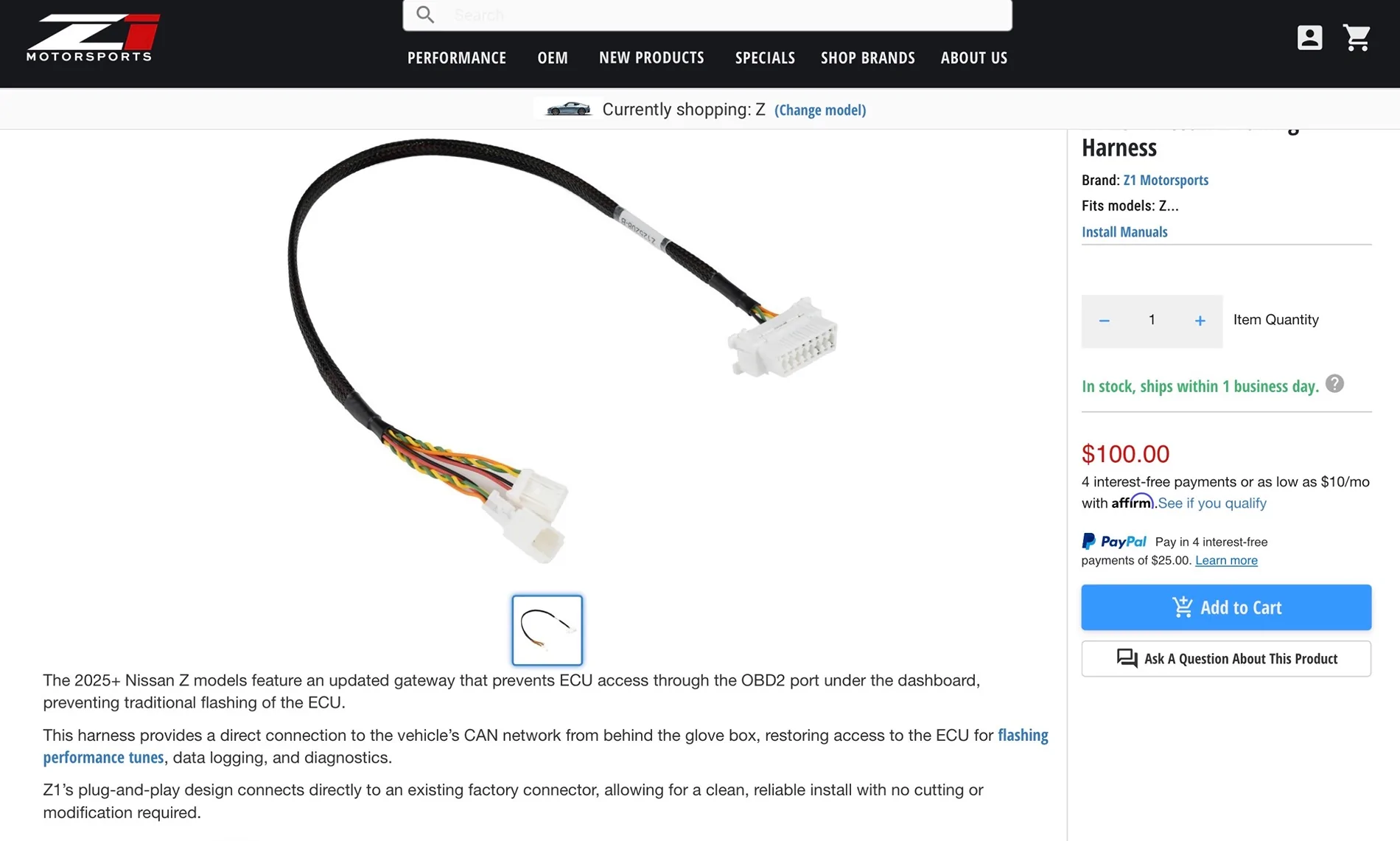

Z1 has released their harness - this is the one my tuner is using. It installs behind the glove box and the ecutek‘s obd module will stay in the glove box for the iPhone app features.
