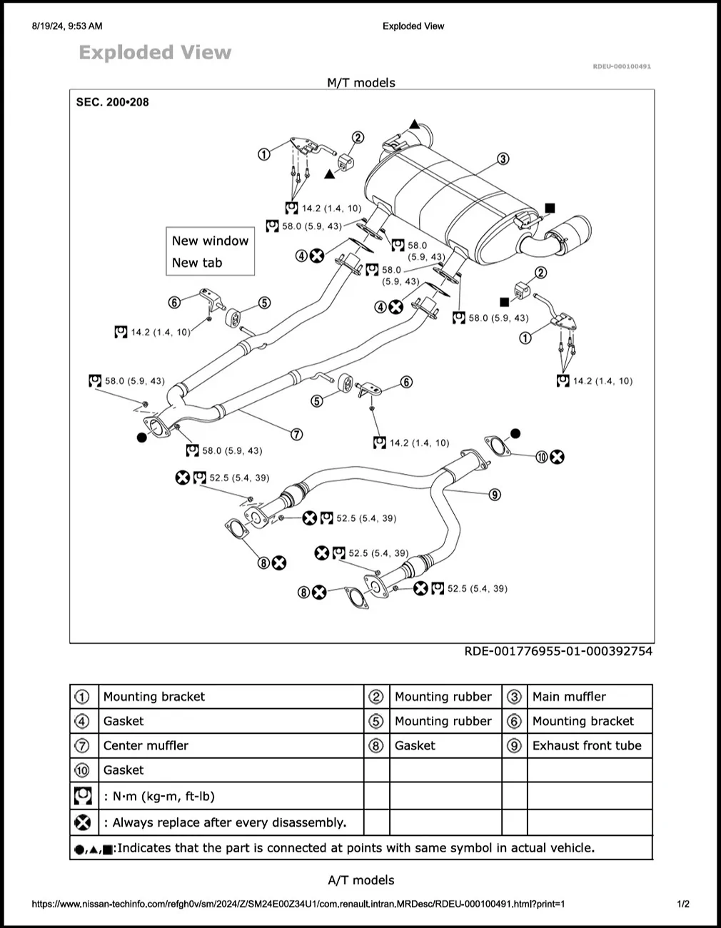

Kind of a nerdy question, but anyone know the torque ratings for the bolts that attach the flanges between the muffler and the midpipe, and the midpipe to the Y pipe?
Of course if no one knows, then I'll just eye ball it as it's prolly not serious as long as there isn't a leak.
As a side note, how tf do people normally get torque specs for their engine rebuilds and stuff? Like in this case, a quick google search isn't enough, nor will "AI" be enough. This is stuff locked behind some manual nissan secretly keeps behind closed doors.

There is a link to the service manual in this forum. I dont remember where, otherwise, I would share it. Here is a screenshot of the torque specs of the axle back and hangers.
