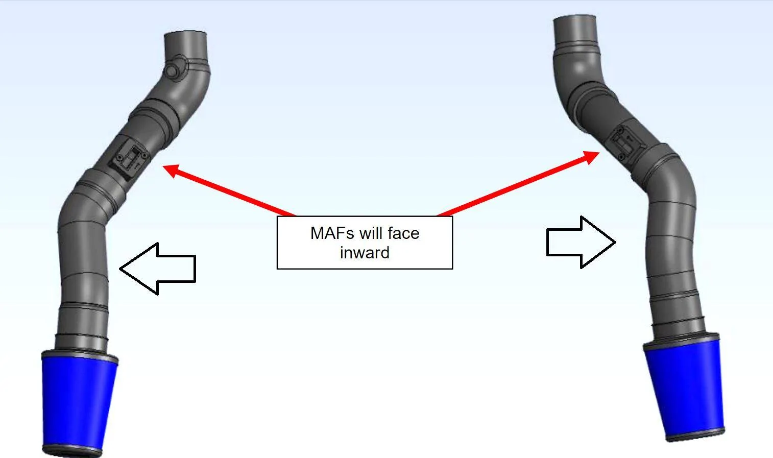

I fully agree.
AMS A2W intercoolers, heat exchanger, Z1 pump + controller, Air intakes is like $4k+ plus install.
I would get a A2A kit and the rest towards bigger turbos and never have to deal with all the heat soak drama.
And for the Z1 A2A kit I think you don't have to cut anything if you don't install the silicon parts between the MAF and filters (white arrows) and install the filter directly on the MAF housing in the engine bay.
Based on their install instructions that seems to be the case, though I couldn't say how it would fit, likely better than hacking up the rad support. Z1 makes a habit out of designing parts 80% of the way for whatever reason.
