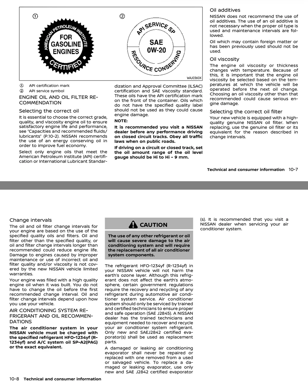

Here's a couple pages from the owners manual for a 2017 Q60 that included the temperature / oil weight range.
You'll notice 0W-20 wasn't even included. Long term, I don't trust 20 weight oil on this motor, I switched to 30 at 10k. When I do the next oil change at 15k, I'll have the oil tested.

I’ll keep on-going with analysis, worth the health checks over time. Long term will stick with 0W30 for all season, will switch temporarily to 0W40 for track days. Warmer climes here.
