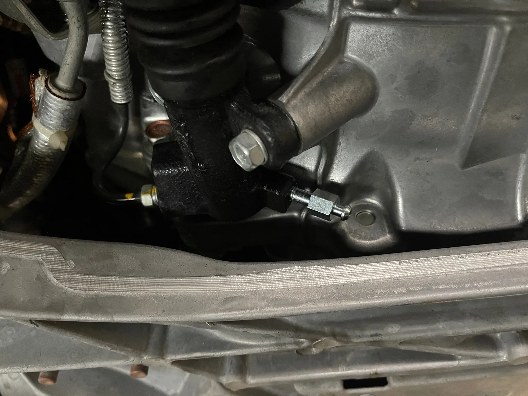

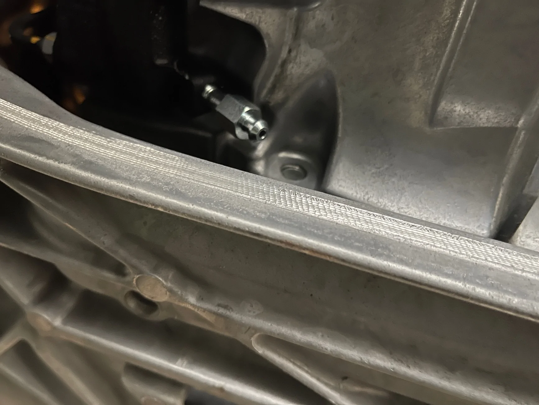

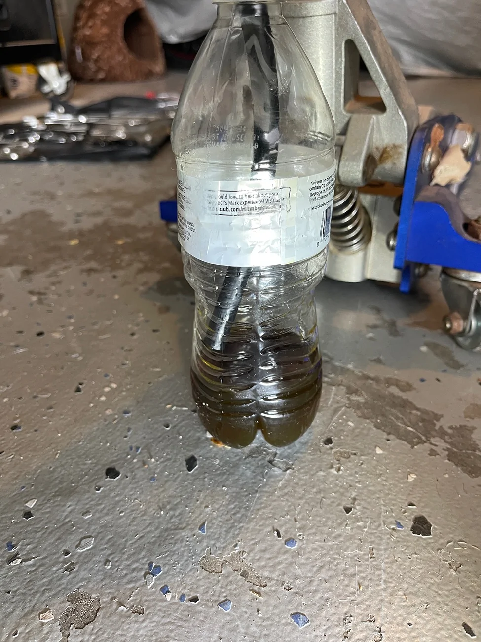

I finally got around to changing the clutch fluid on my 23 Z performance. It has about 16K on it. I was surprised how dirty the fluid looked so I’m glad I did it. I used MOTUL RBF 600 which a lot of 370Z owners recommend. It was pretty straightforward and I filled and emptied the reservoir three times. The method I used was pump the clutch slowly five times then hold it down and then drain it out. There was one slight difference from the YouTube videos of the procedure on older Z’s the bleed valve was 10mm instead of 8mm and there wasn’t a rubber cap on it. This is the list of what I used to complete it 10mm wrench, 3/16 fuel line, MOTUL RBF 600, turkey baster, shop rags and empty plastic bottle.

I'd put a cap on that puppy, just to keep the dirt out and make it nicer for the next change.

I fabricated a cap out of the hose for the time being.

This is the same as the brake bleed nipples. You should be able to buy a pack cheap at any auto parts store.

Good god that fluid is disgusting. I had no idea it would get that bad that quickly. Looks like I'm adding in a fluid flush for the clutch and the brakes for my 20,000 service.
