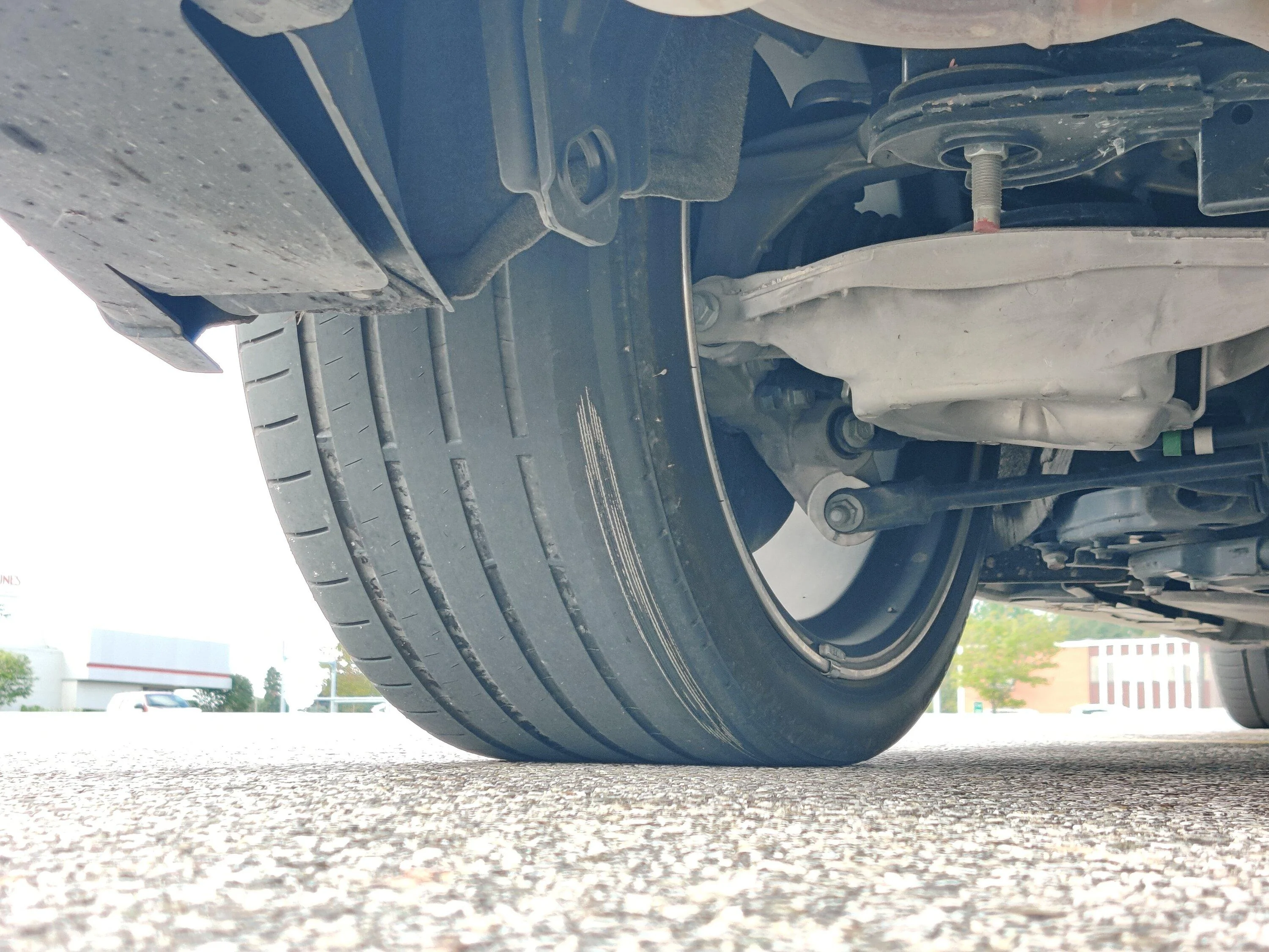

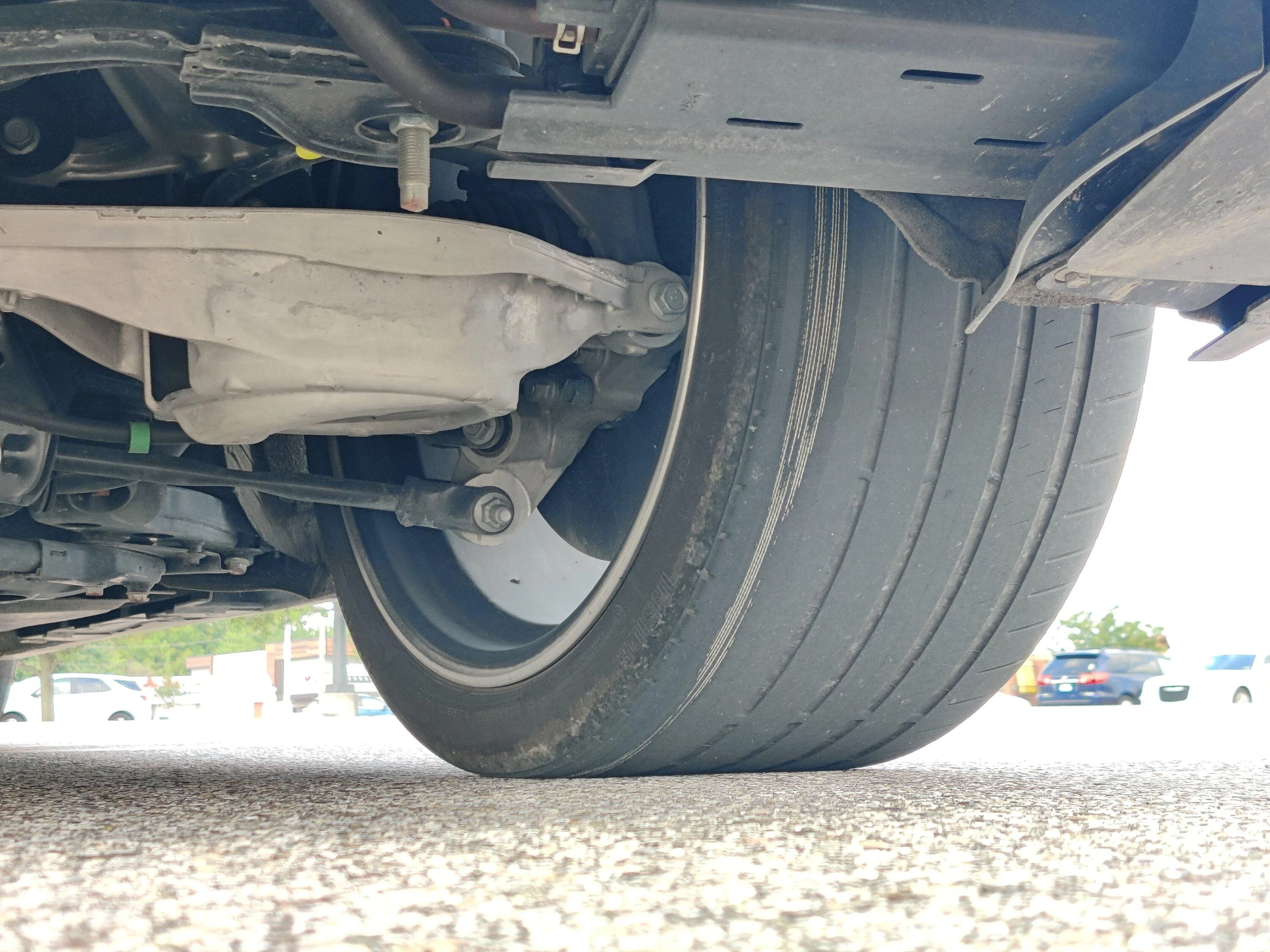

Is this normal? The rear wheels are cambered in (not sure to what degree), so the tires are wearing through on the inside. I know it's a sports car and a slidy boy, but I don't drive like a mad man. I don't do burn outs (don't think it'll let me), I don't do powerslides or drifting. It will occasionally step out around a corner, but nothing crazy.
I knew that the tread was getting kinda low by hand-checking it, so figured "oh, summer tires must wear faster." But one time it was wayyy too easy to step out around a corner. After that I hand-checked again. But this time I felt all the way around the tire... The pictures show what I saw when I looked.
Is 14,000 a bit soon for this wear? I think I'm going to talk to my dealer guy.

Impressive. Could your tyres have been under inflated giving increased wear on the edges? That combined with a bit of camber might do this.

The factory alignment is crap.
new tires and an alignment and you will be better off.
but it’s also a performance car so yeah going wear quicker than a stock car.

The alignment is not good. The tire should wear evenly across the tread. Even if they were under inflated both sides would wear not just the one. But, the "sportier" the tire the less life it will have.

This reminds me of my 2003 350z ,they also used bridgestone tires and they did the same thing.There was a recall at that time for this and if I remember correctly it was due to no camber adjustment on the 350z.They would just keep replacing the rear tires during the warranty period.Wonder if it's the same on the new Z.

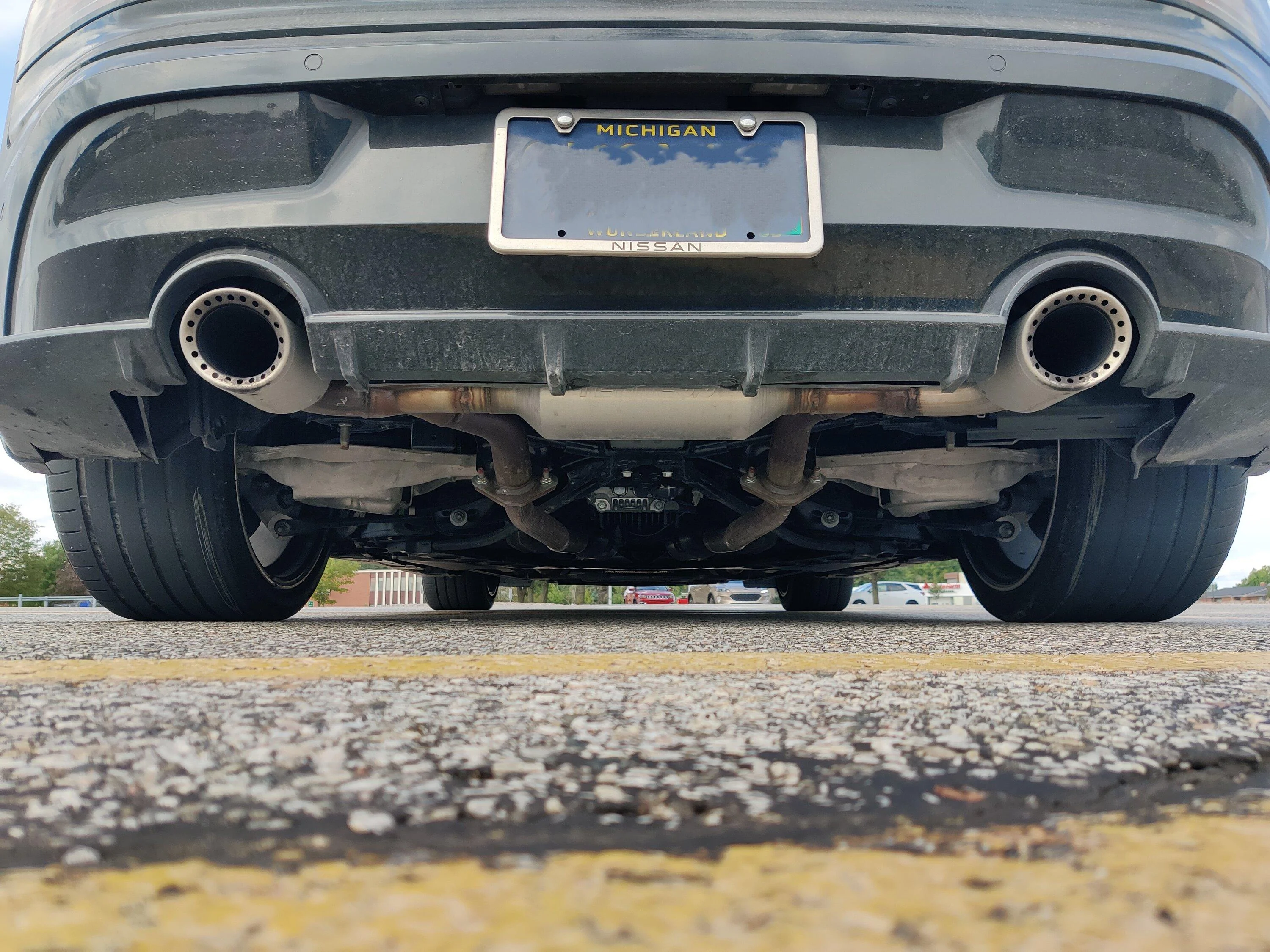

Is your Z at factory ride height, i.e. not lowered? Those LCAs sure looked angled like more neg camber at those rear tires. Or, you're carrying more weight back there? It's camber wear and soft S007s, nothing else.
