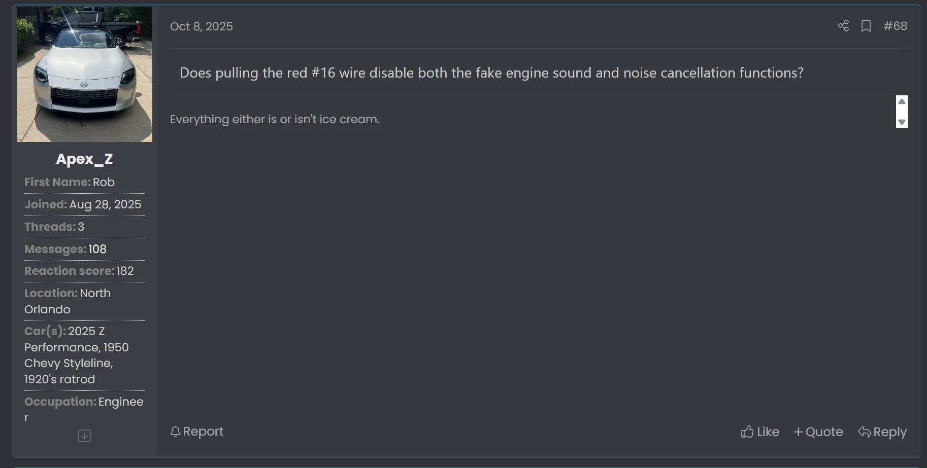

I’m trying to track down that thread again. The pinout diagram wasn’t very clear about which wire needed to be removed. If anyone has a link to the thread—or the how-to guide—I’d really appreciate it.
I did disable the ASE/ANC myself, but I’m still getting what sounds like some residual noise from the subwoofer.
44

I thought so, found that one after my post ... I remember posting it was way too invasive to go all the way to the chassis :) ... a pinout diagram at the subwoofer itself, rather than at the amp, would be much better.
Trying to remember something about pin 16?
I don't have to cut it, I have the proper tools to remove the offending pin.
Original post ... zero response :( @Apex_Z
