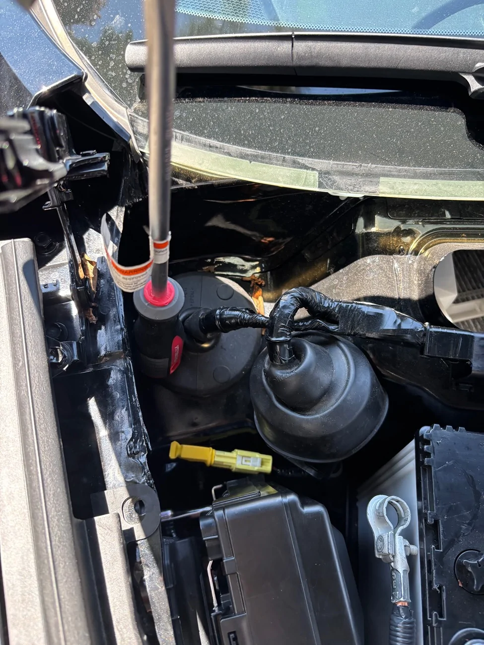

Anyone seen these hood risers & know how to get them down. Spun the Z on wet roads and caught back wheel on curb. These popped the hood open - can’t open or close hood

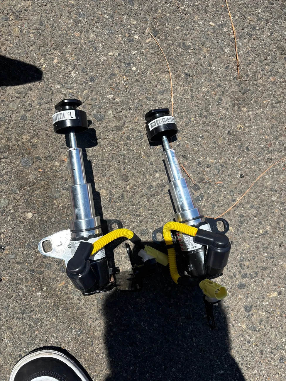

I was able to get them plugged in and swapped but for some reason my hood light stayed on as if it’s open but it’s closed. If anyone knows how to get rid of the hood open light, let me know.

No you can’t just remove them. Your car computer will detect that they are missing or unplugged and you’ll have an error code.
If you remove them you need to plug in something that fools your computer into thinking they are still there.

If I had to guess, I'd say the delete/bypass harness that makes up that kit is nothing more than a resistor in a case attached to a male version of the plug that goes into the cars wiring harness. If someone was willing to open the case and look that might make things a lot easier.

yes its just a resistor saw a guy on facebook make a set super cheap

For something as important as the SRS system (which I believe this is tied to given that its yellow), I'm pretty sure its all the same. Otherwise the company selling that kit would have no idea how to make them fit for each individual car.
Question is what resistor would be needed.

Yeah, I've seen that kit a few times. What I'm getting at is its likely a ten cent resistor inside a fancy case that is connected to the male end of the plug to fit into the cars harness. If someone would be willing to take the case off it may likely make it easier and far cheaper for people looking to delete the hood pop system by just purchasing a few resistors from digikey, etc rather than paying $150~ usd for two ten cent resistors.
