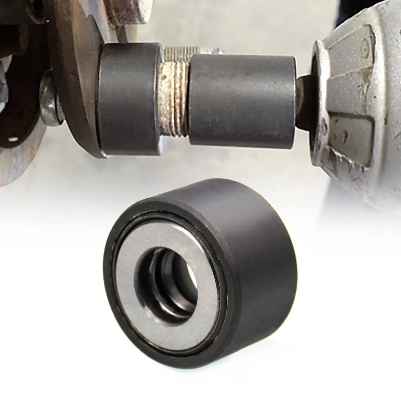

Would it help to knock the studs free, or at least partially, before removing the hub assy? Not sure how much force it takes to knock them out, and prefer not to be banging on 60 lbs of oddly shaped expensive gear on the bench.
D2M
Jun 14, 2024
266
400
NJ
Nismo Z, Veloster N, Ram 2500
Yes, knock them out first, they are not in that tight and you can get the oem studs out with the hub still on the car. The aftermarket studs are usually a bit tighter fit. I put a dab of WD40 on the knurled ends to help them press in using an impact and a stud installation tool, get one they are cheap and work great.
46
1,598
2,024
ā€˜24 Z NISMO
10-4. Looking as the Lisle installation tool.

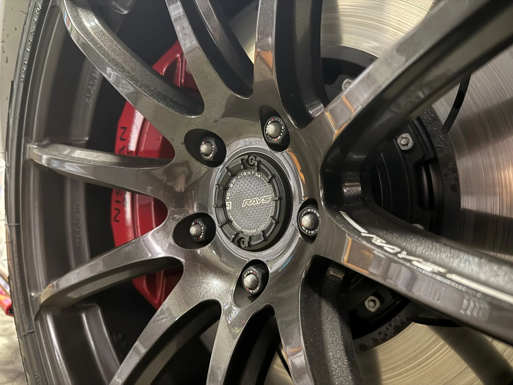

I just did my 2024. Took a minute to figure out how then the other side was like 30 minutes. I used z1 15 mm spacers and ARP extended studs. Definitely use the tool for them because it really is inexpensive. So what I learned is just pull the calipers off then pull the rotor off. In the front there is a small hole or notch towards the front of the car to slide them out and in. That backs were tricky. Find the deepest area and the longer bolts fit in but kinda at an angle not straight. Turn the hub and they slide right in. No hub removal was needed. I watched and read everything I could about this job and this is what actually worked.

I run the 61 mm Nismo Sports Long Hub Bolts with no spacers, only offset, just because I like the look and the added security of 100% thread engagement.
