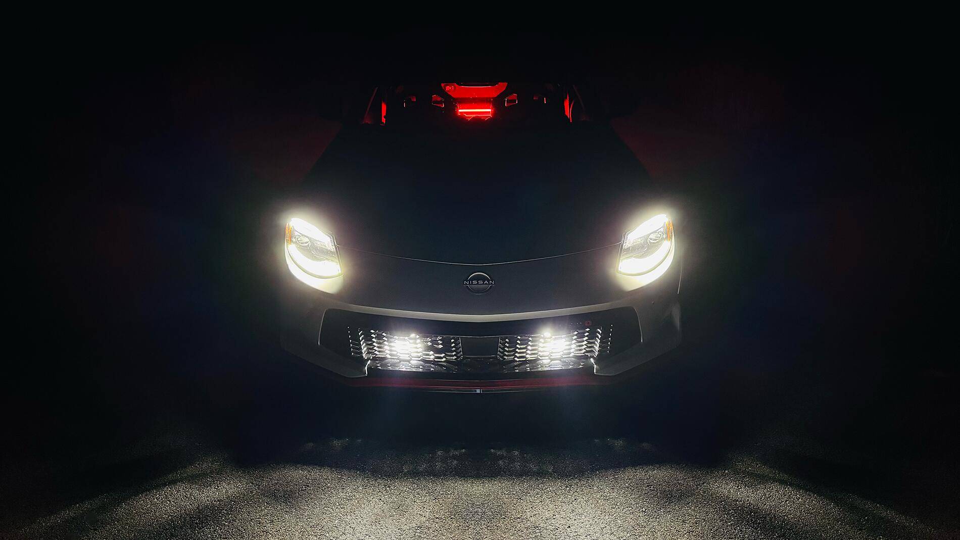

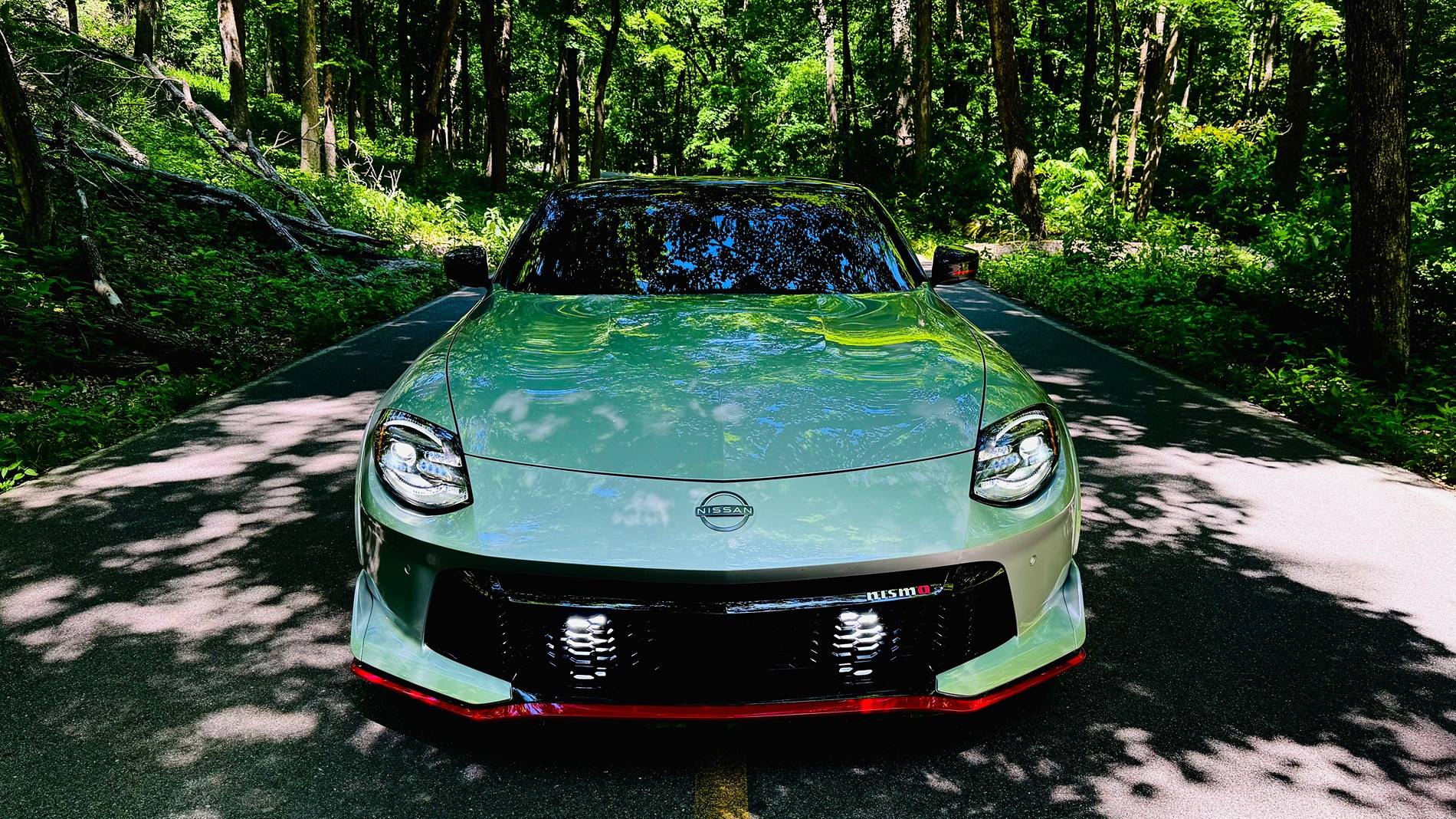

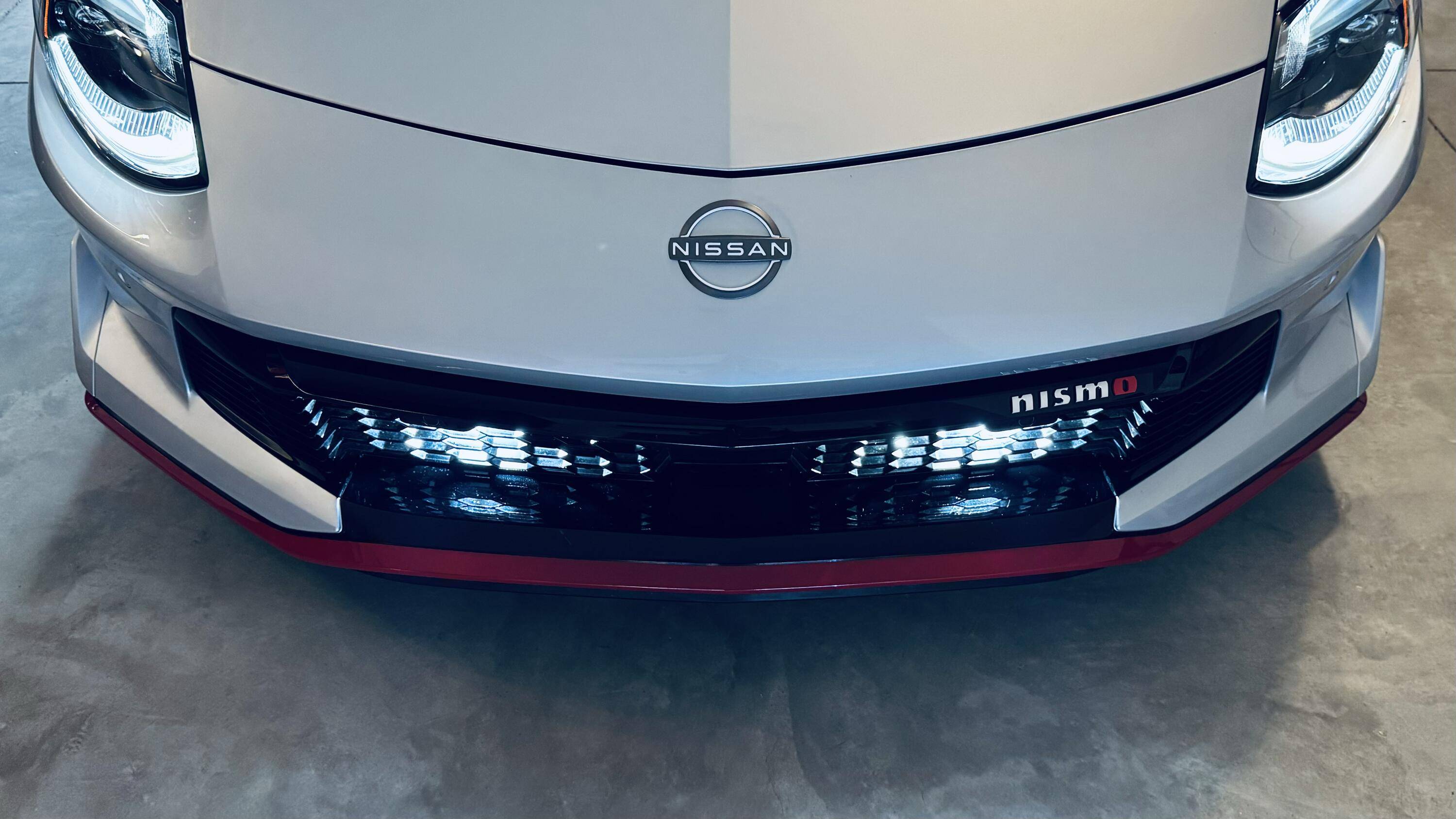

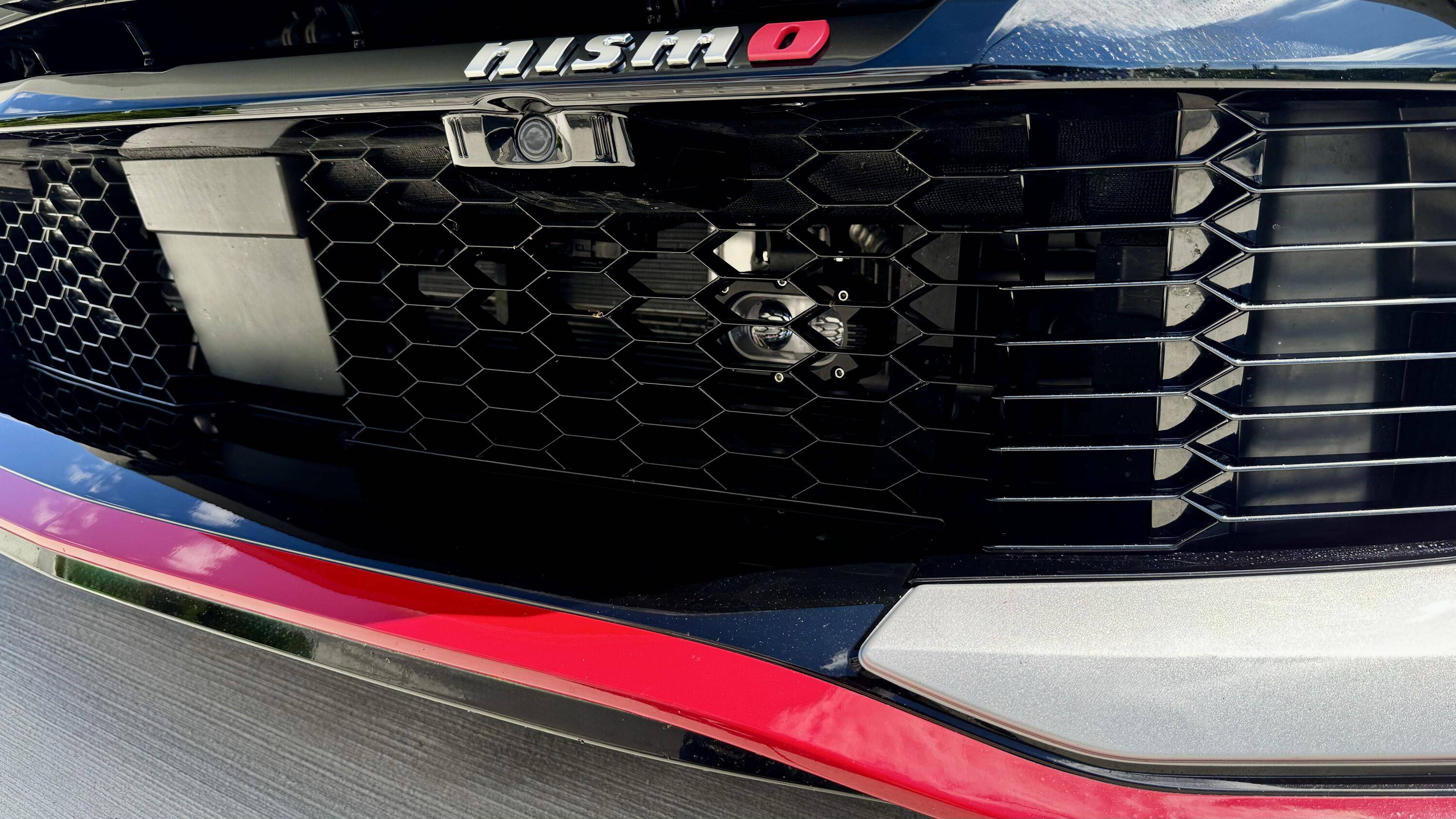

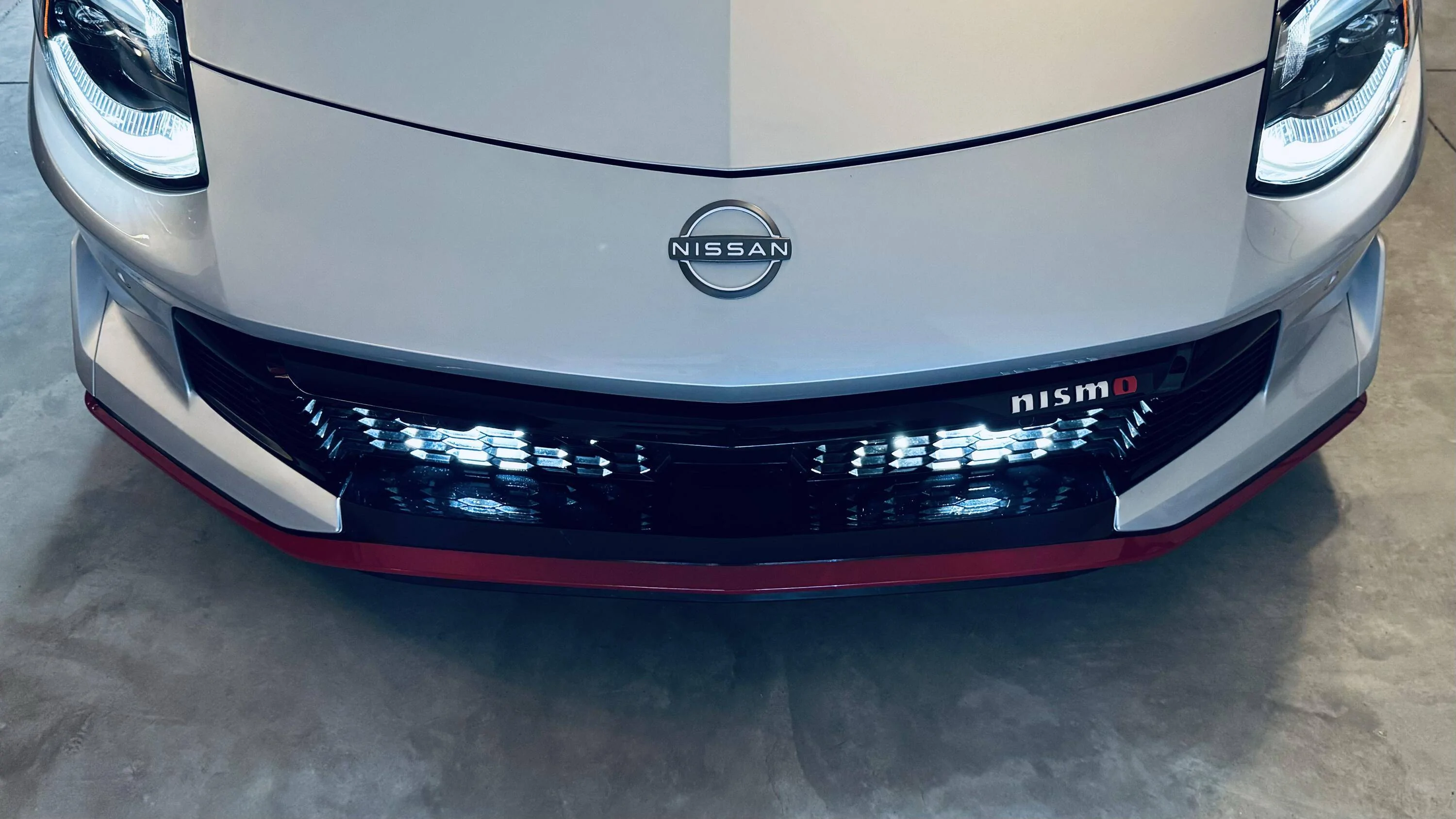

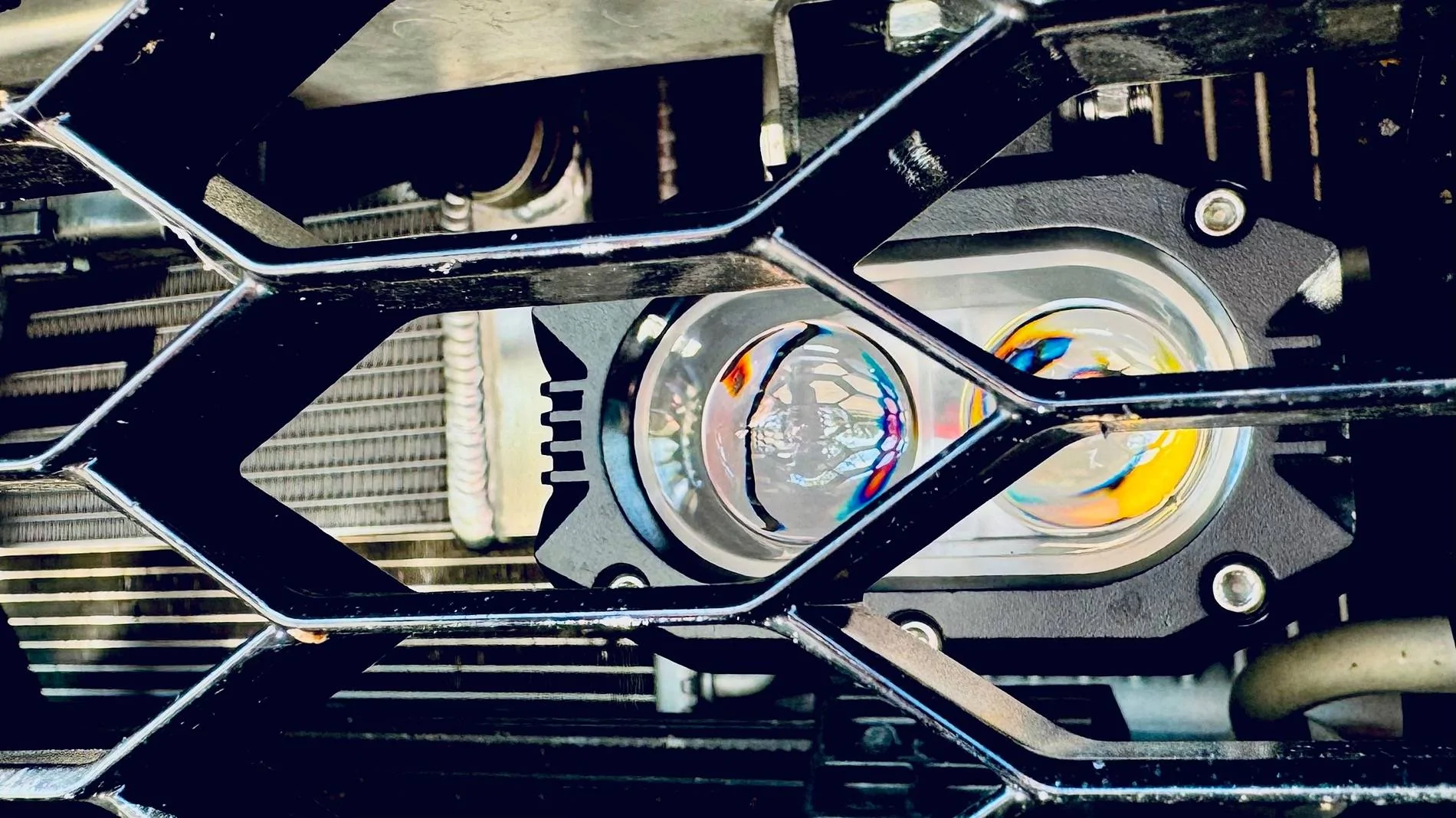

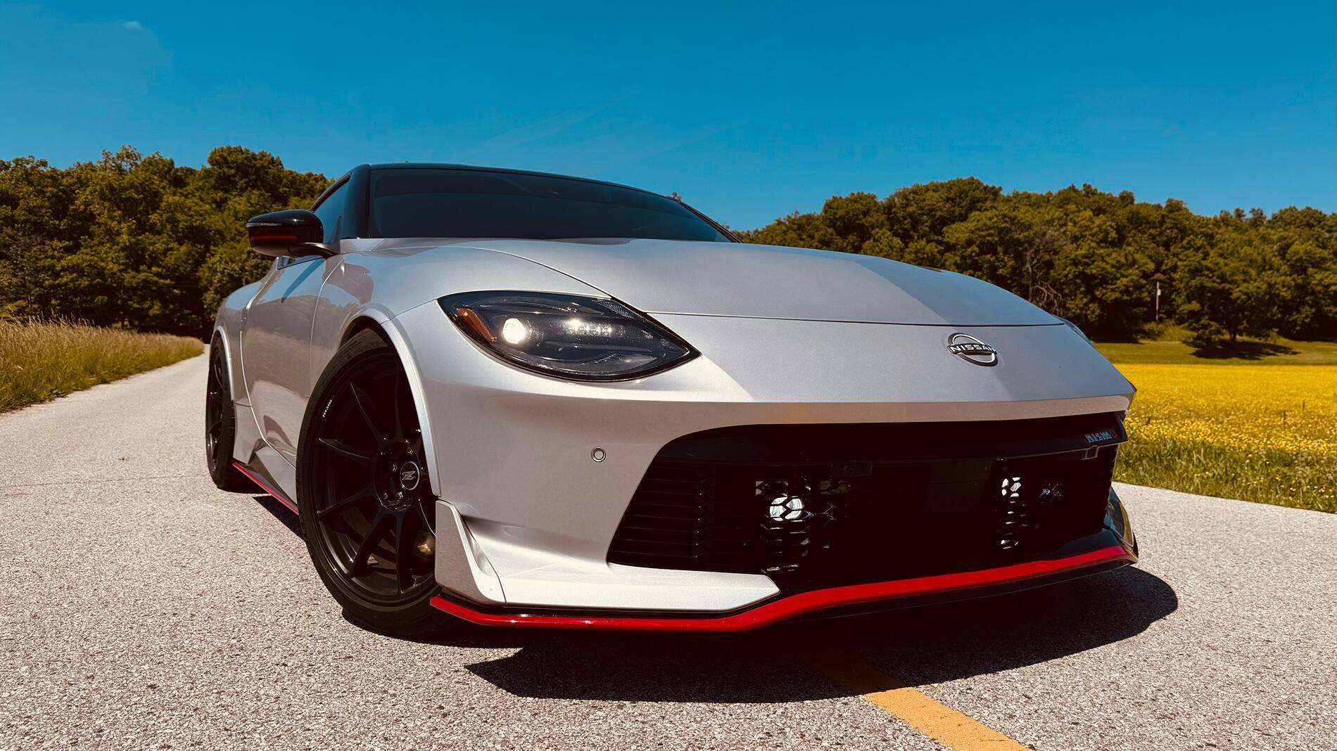

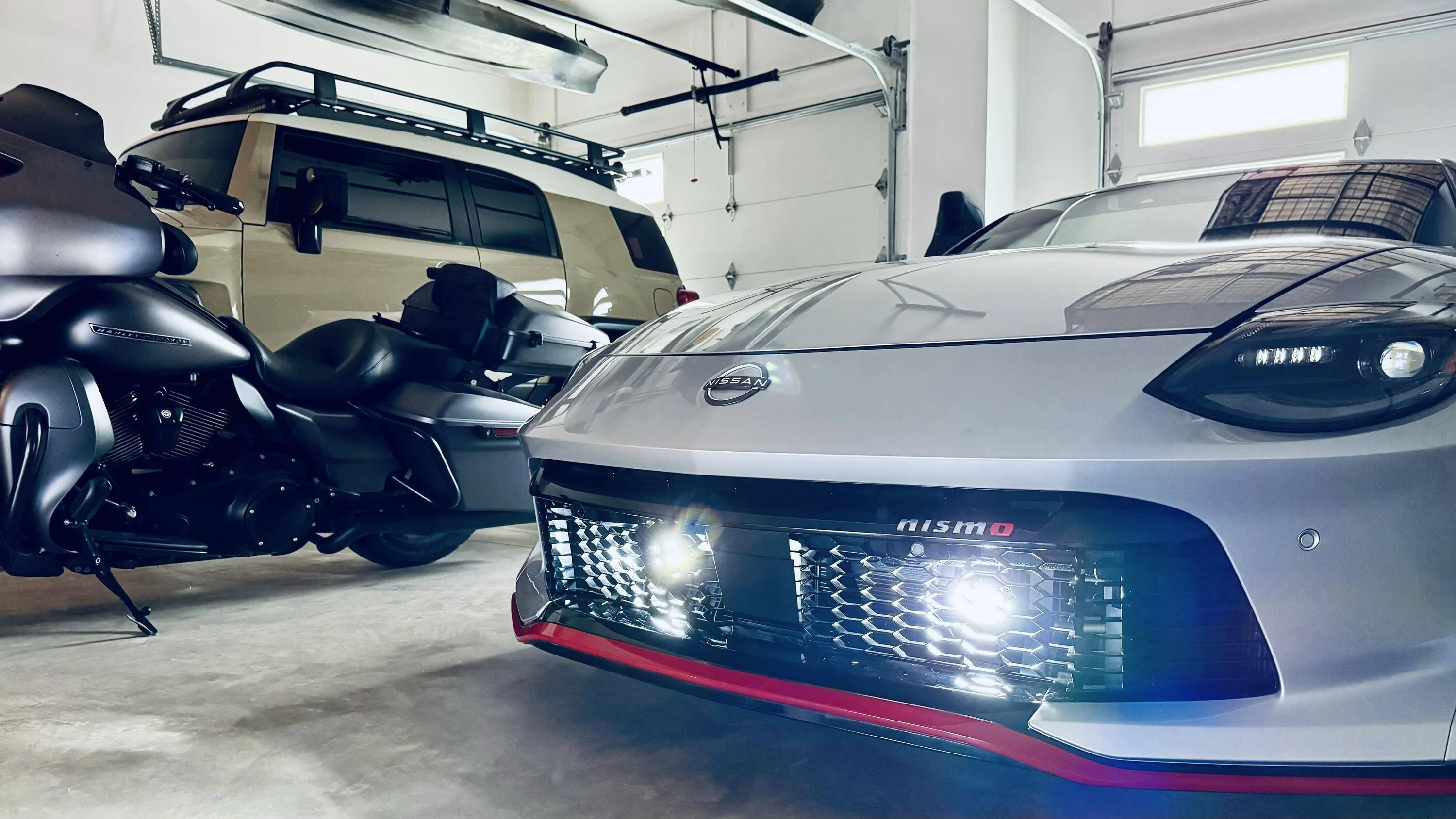

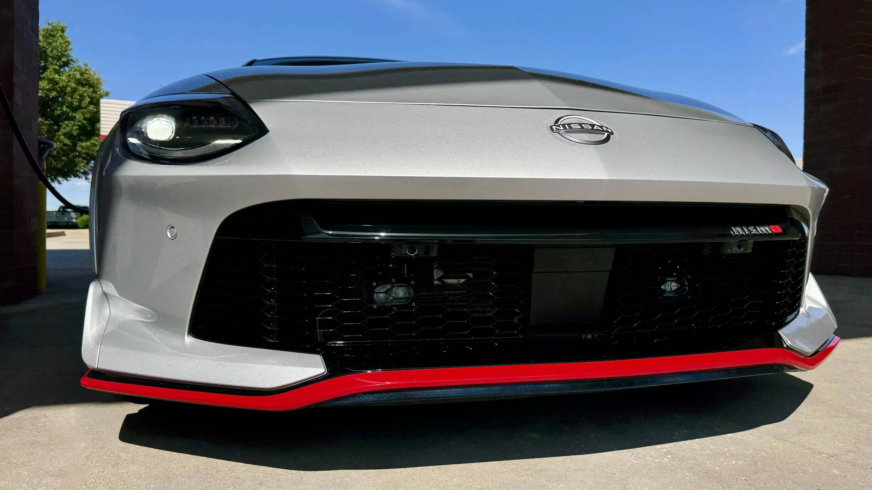

Mounting LED projector pods was handled by installing flanged aluminum threaded rivnuts to bottom of large horizontal OEM support/crashbar located behind the grille mesh. Then routed wiring to a waterproof relay (fused of course) hidden under hood and controlled by temporary switch under steering column. I say 'temporary' because I'm currently trying to find an OEM switch to control driving lights that will install in center console where there two factory switch blanks where seat heater switched normally go on Performance model because NISMO has Recoro seats instead that don't have heaters.

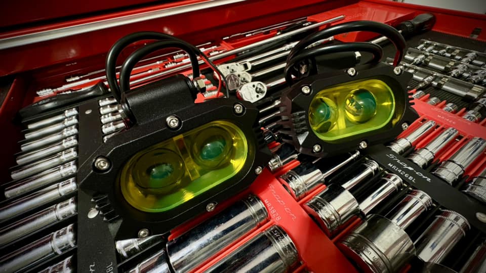

PS: Here's the particular LED pods for anyone interested. They are available in both white and yellow, as well as spot and flood versions for white. I have the yellow ones too, but running white/spot for now. Can always easily swap them later if wanted as I installed waterproof Deutsch connectors for simple plug n' play.
White: https://www.amazon.com/dp/B07W9KQCQW
Yellow: https://www.amazon.com/dp/B08M3DBJ6K

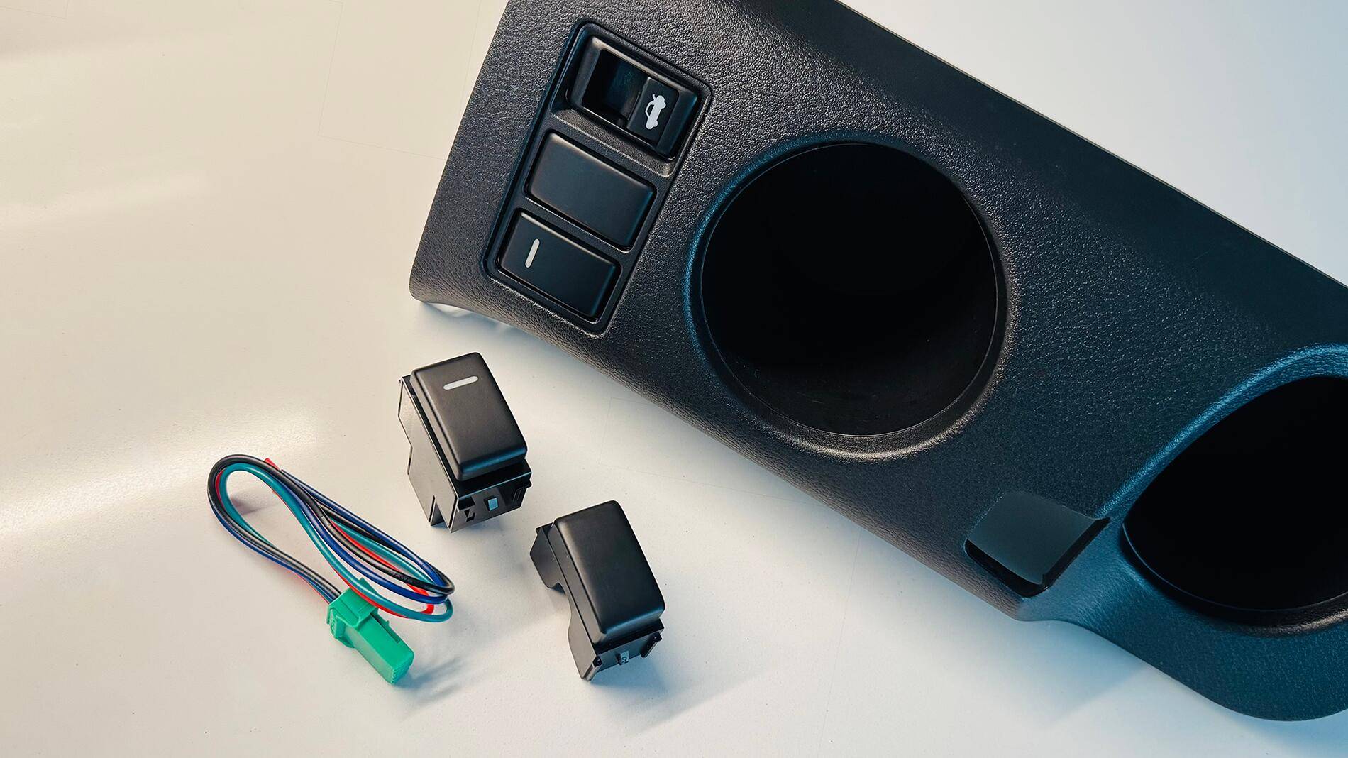

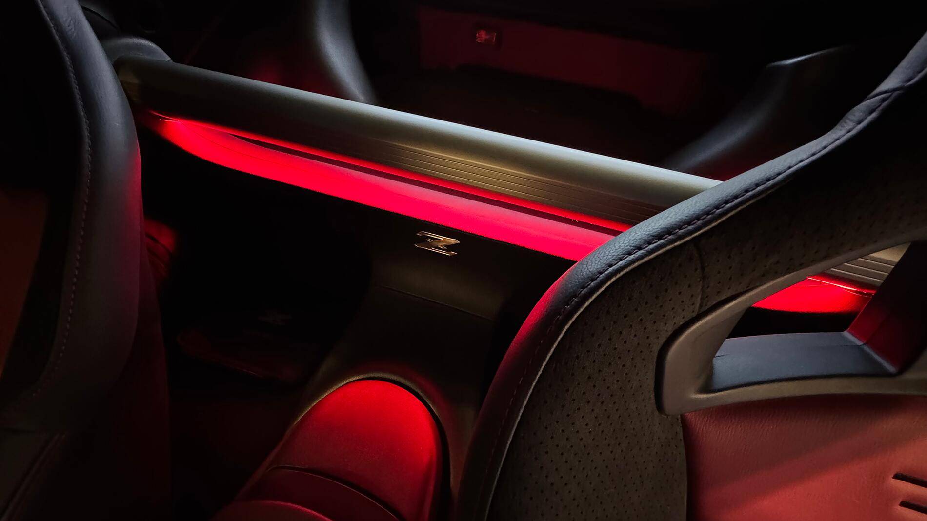

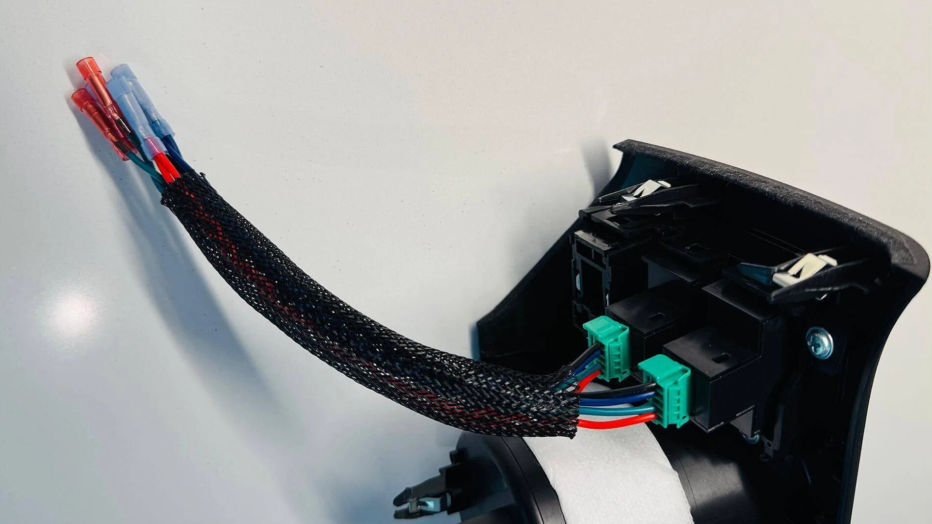

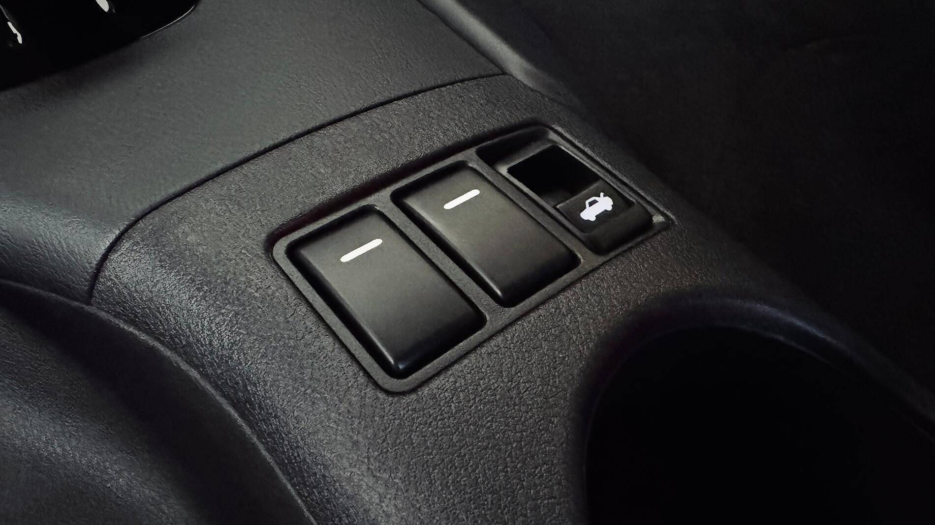

Update on switches found to control aftermarket lighting: Air On Board offers true OE-style push button switches that mate perfectly to the NISMO's center console, replacing the factory blanks where seat heater switches normally go on the Performance version Z. Really like these too because they are clean without any unnecessary text or icons on them. Switch on left controls the LED projector pods stealth mounted behind front grille. Switch on right controls a homogenous red LED strip I mounted hidden underneath the rear strut support brace that provides just the right amount of indirect ambient interior lighting at night without being distracting (it has a hidden dimmer control as well to dial in the desired brightness level).
Here's the link for switches for anyone interested: https://www.aironboard.com/online/w...h-12v-nissan-oem-replacement-green-amber.html

How did you remove the center console? I bought a switch and want to install it. Don't have any plans on what to wire the switch for just yet though.
