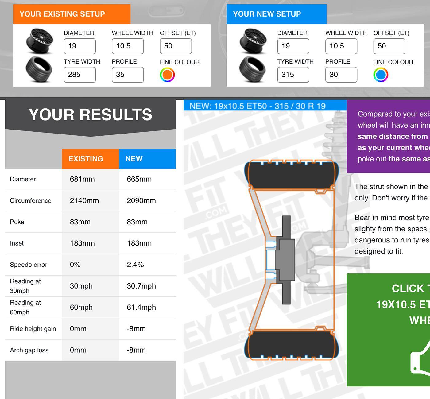

Anyone know if you can put 19x10.5 back wheels with the 315/30R19 tires? I lowered my Z to a 1.2"
If you can fit 315/30R19 to 19x10.5 wheels, would the tires stick out a little because of the width? The tire wall would not look flat to the wheels.
Not a problem for the wheel size in general - i would check the recommended wheel width for the tires that you are looking to buy. For example Michelin pilot sport cup2 wheel width requirement is 10.5 - 11.5, so 11” is ideal but 10.5 will work. No idea if the tire will fit your lowered car…
