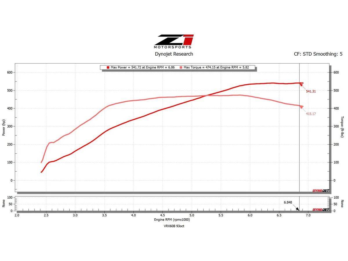

Speaking with Z1 about the VRX60 or VRX70 turbos, they indicated that 60 would be ideal for pushing power through turns on track, while 70 would be ideal for flat-out straights on the track. Makes sense, larger turbo=more lag, but more power when lag overcome.
My concern between 60 and 70 is the turbo speed. I can hit the power requirements I have with the VRX60 but Z1 stated on the top end I am hitting the turbo rpms I would like to avoid hitting consistently. I'm probably overthinking it. :clap:
Also looking for feedback is anyone is running these VRX60s!
If you look at the torque line on the graph you can get a sense of when the boost comes on.
The VRX60s seem to fit my bill for street use. I've seen this graph as well. Torque is flat from 3.5k and power doesn't drop off at 7k. The gearing in the manuals at 3.6 and 1:1 being 5th I bet it's fast

Z1 said with fuel mods and proper fuel it could achieve 700whp with the smaller 60's
The would probably be pushing the compressor efficiency or if would like to see the compressor curve
That looks pretty...not great..honestly. Am I missing something here? For upgraded ball bearing turbos, that seems really anemic. Torque comes on at 3.5~ and you see drop off well before redline.
The factory turbos have better response and taper off close to the same time.
The average torque is quite high and peaks at 5.8k... that's pretty impressive for a street car. Hp peaks at 6.8k. This set up with AVG torque above 400rwtq throughout the curve will feel fantastic. I think the hp curve says it's about tapped without more boost or fuel

It doesn't seem to address what I'd find more important, maintaining early response and no top end fall off, despite being ball bearing.
There has to be a decent set of EFR's out there that would allow those to have their cake and eat it too.

Z1 should have overlayed all turbos with similar boost targets
all tuned Z's push at least 1.3 bar of boost on stock turbo's tapering off to 1 bar from 6K
which is why top end on Z just dies off
The stock turbos avg HP and Tq above 4k is suffering.
