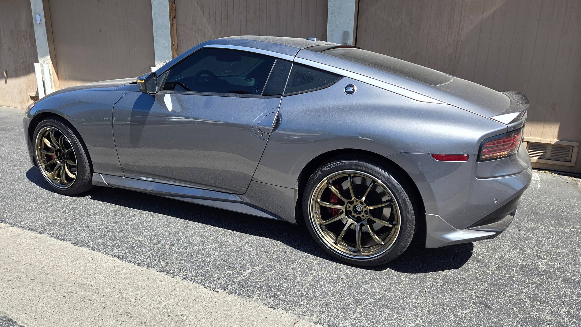

326
‘24 BDP Z NISMO
Compared to the NISMO fitment:
Front should fit fine. Same size, but shifted in 2mm.
Rear is a different story. Inner lip sits 34mm further in, and the outer lip tucked 20mm.
Running a 30mm spacer on the rear might work, but I’m not certain.
With a 30mm spacer the outer lip would sit like a NISMO with 10mm spacers (or a Perf with 23mm spacers). The inner lip will still be 4mm further in, about 1/8”, and I assume there’s more than 1/8” of suspension clearance on the stock NISMO.

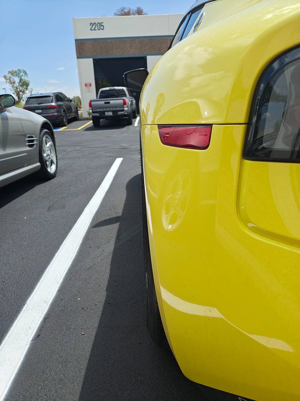

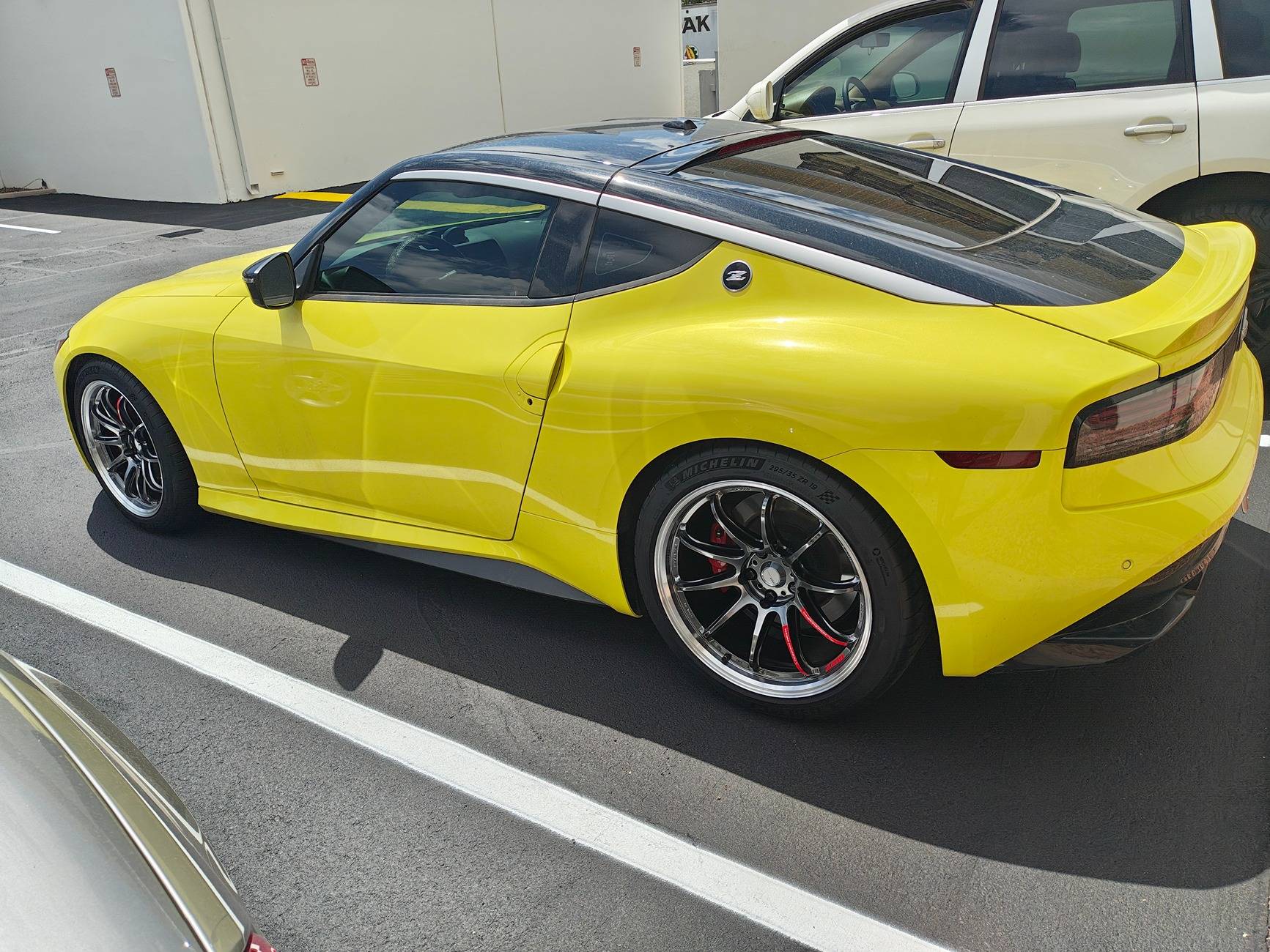

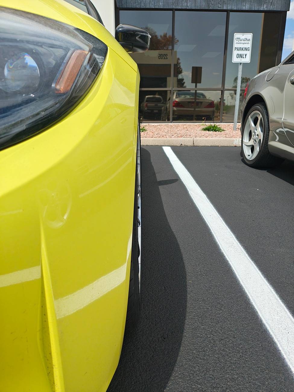

ForSale24
Ron G.
Apr 11, 2024
71
51
Phoenix
Work Wheels ZR10 19x9.5 +23
Work Wheels ZR10 19x10.5 +15
Michelin Pilot Sport 4S 265 & 295
This is my set up, it's kinda an aggressive fit with no room to "push" out or in. You can almost see the "tire hairs" poking no spacers... A +50 offset just sounds all wrong. Stock is +23 in the rear

Front practically identical to the stock NISMO front. That would be 13mm further out than a stock Perf. To get the same look as @ForSale24 on the front you would need 12mm spacers.
Rear would poke 6mm further out than a stock NISMO. Almost indistinguishable from ForSale24’s rear (2mm or 3mm inset). Inside clearance is unknown. Inner lip is 7mm or 8mm (0.28” to 0.31”) further in than the stock Performance rears. I assume there’s 1/3” to play with back there, but zero guarantees from me.
