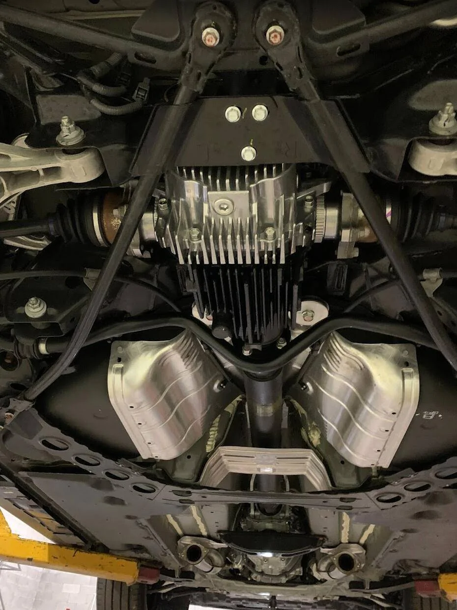

Pic of my New-from-Nissan LSD with the Z1 cover on it:

Heck yeah! Looks great 🙌🙌
