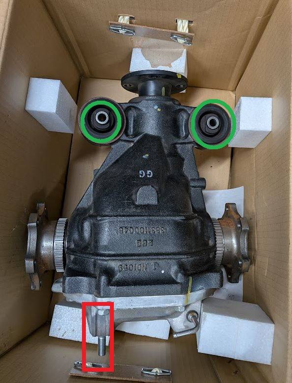

Here's the point I was trying to make;
The Z1 diff cover is not handling more torque. Same mounting point. Same positioning of the rear stud. Same torque transferred. Yeah, it probably has more meat around it to grip that stud better. But the torque goes from the cast iron of the diff, to the 10ish bolts on the cover, to the cover, to that one stud that is inserted in to a bushing.
My concern is on that stud being the sole point that handles the twist torque.
The pic is looking down on my old open diff.
The green points are bolted from below upward. That makes them a hinge point.
The RED spot is the stud that goes through the rubber liquid-filled bushings. The axles twist, causing the diff to rotate upward and downward. That means the force is on the top and bottom of the stud.
So the stud is pushing against the bushing. Does that mean those liquid filled bushings are softening/evenly distributing the torque over that stud? Do urethane bushings allow for some softening of the torque load on that stud's side? What if ALL the rear bushings are SOLID? Does that mean that there is absolutely no hinging from the green OR RED, and there's no side load on that stud?
Questions for a mechanical engineer, and not a guy that stayed at a Holiday Inn Express a few months ago.
NOW, does that mean that the stud is a ductile metal to allow some flex inside of the rubber bushing? Sure, grade 8 is harder, but not as ductile.
Many things to go over here, firstly the torque is distributed amongst the entirety of the rear end, the 10mm bolts arent taking the grunt, that’s your differential on the inside, the cover, the axles, and the driveshaft. The cover and housing of the differential is meant to evenly distribute it the stud you are referring to is simply; “A” an axis to keep the suspension geometry and differential in check, and “B” is more so about keeping the differential in check in relation the the differential cover location and keeping it on rather than taking the torque load if that makes sense. For the rest, a quick run down is rubber < urethane < solid steel. The harder the bushing the less flex, which means that before that flex it can handle more of a load, so while increasing the bushings rigidity will make the stress a lot less, it’ll just in a way put more stress on the bushing itself and subframe- but remember the torque is already managed by the differential itself so it’s really a matter of chassis rigidity and stiffening the car, the bolts don’t see the true grunt of everything.
a quick run down sorry it’s not too to in depth.
