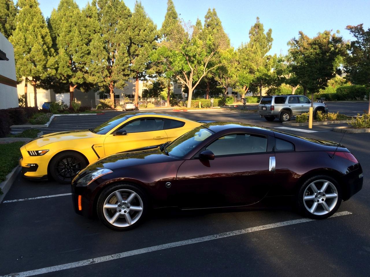

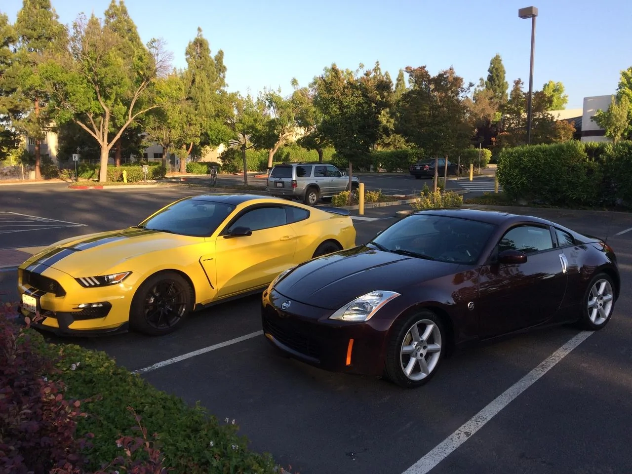

Here are a couple shots of my 350Z and GT350 before I sold the Z (damn I miss that car).
