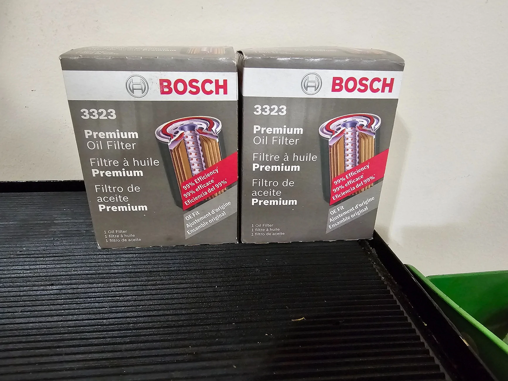

Speaking of oil pressure, I picked up a couple of these Bosch oil filters. I have been running Mobil One M1-110A but when I was researching, a lot of people liked the Bosch over the Mobil. One person even said the start-up/idle oil pressure was a little higher. I DESPISE the low oil pressure/solenoid system of the Nissan. Ironically I think Bosch is the one who makes the solenoid lol...
These filters are also half the price of the Mobil One. I mean $13 for an oil filter isn't life-altering but I also think it shouldn't cost THAT much.
But I just changed my oil so I'll have to wait until probably the end of the year to report back

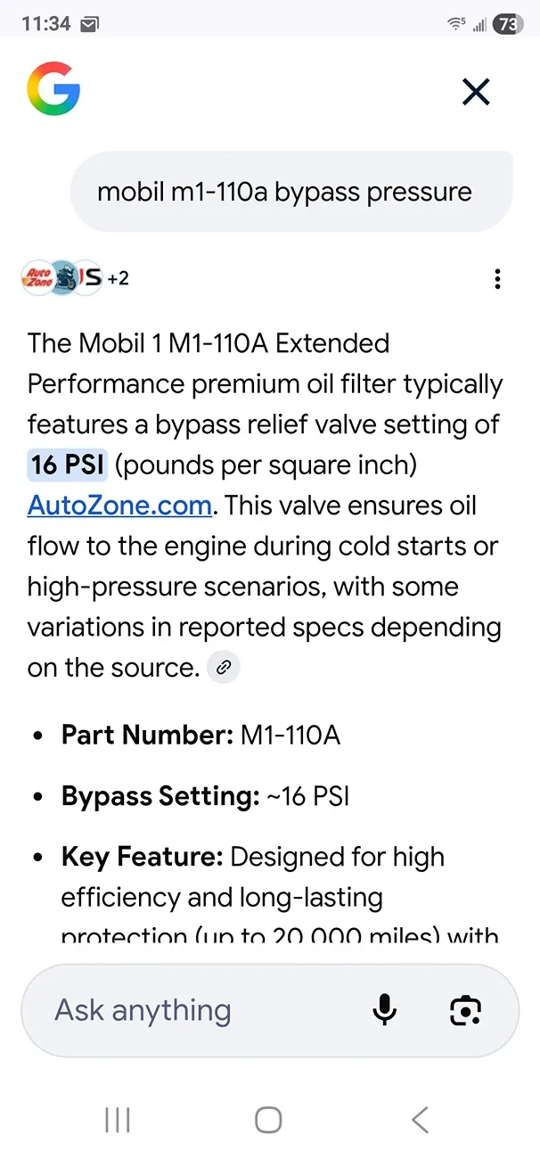

Have you verified the bypass pressure rating on these filters?
***EDIT***
I just looked them up and those filters do not have the correct bypass psi rating. They're listed as 14-18psi while the OEM Nissan filters are about double that.

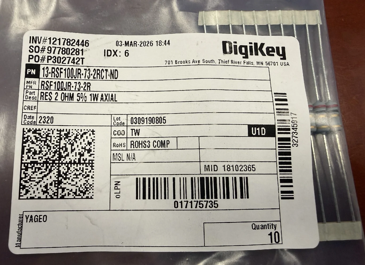

Got resistors to try out the hood popper delete. Next step is to get a couple of connectors. My plan is to try it out on my car for a bit. Assming all goes as planned, would anyone else be interested in a set? I got 10 resistors, so unless I screw something up I'll have enough to do mine + 4 more sets.
I haven't...I didn't think about it since it's supposed to be the equivalent to the M1-110A...but I should probably do that lol
I just looked them up and those filters do not have the correct bypass psi rating. They're listed as 14-18psi while the OEM Nissan filters are double that (36psi).

M1-110A is the same as that Bosch. I have yet to find an acceptable aftermarket filter, which is unfortunate.
I wonder what gives. I know people are using the m1-110a on their GTRs...but then I see this.
Possible Google is wrong tho...
I never looked up the bypass PSI. If a part number is listed as the proper one, why would I think I have to look up all the specs to make sure? Damn that's aggravating. I've always liked Mobil and Bosch stuff.
OK so I need to get OEM filters...do you have a good source? I read that whole thread about Japanese vs Mexican made filters...I don't remember the consensus.
To clarify, the question isn't directed at you...just venting my frustration out loud lol
I have both the Japanese and Mexican filters, and actually prefer the construction quality of the made in Mexico filter after doing a mini comparison! It also had better internal louvers. You can buy the Japanese ones on eBay or the Mexican ones at any Nissan dealerships.
I guess I'll take a trip to the dealer while I'm off work today. I went back and edited my original post. I don't want to mislead anybody. But this is frustrating.
Added the eBay link above if anyone wants the Japan F1B.
