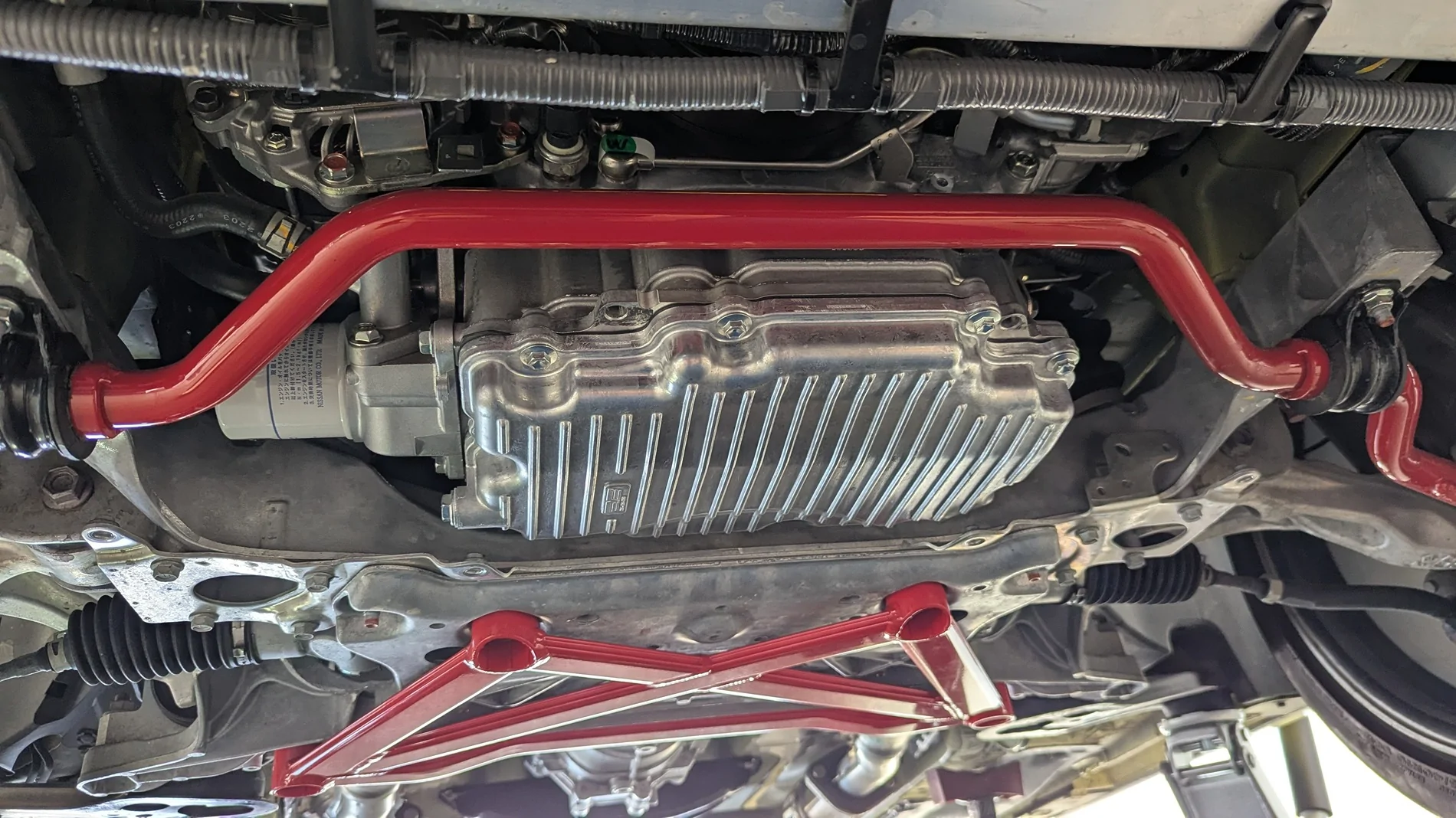

Starting changing my transmission fluid but ran about ½ qt light... Luckily O'Reilly stocks Redline!
Change #2 with Redline MT-85 to fully flush out all the old factory stuff.

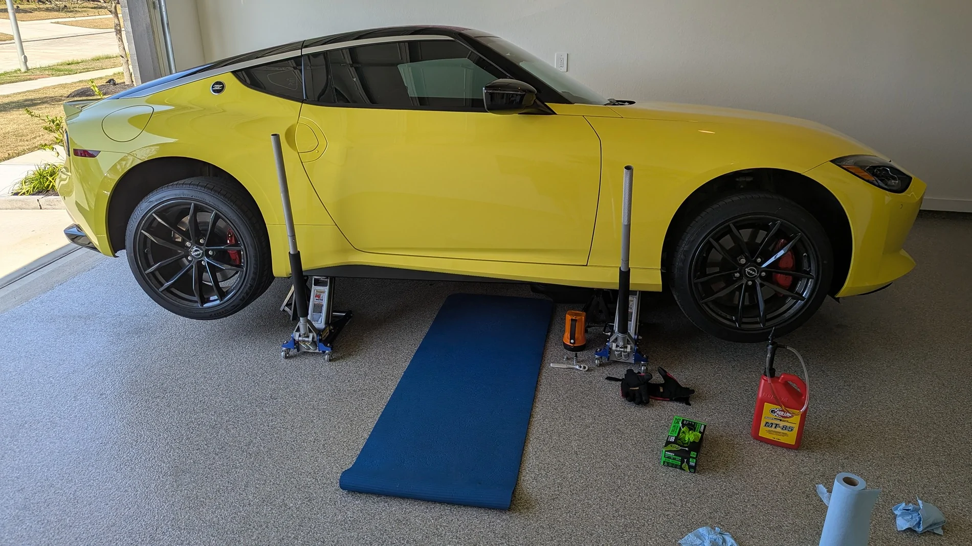

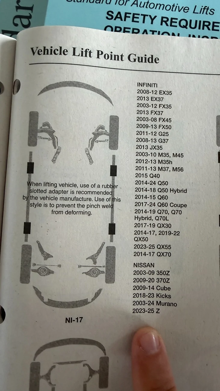

Boxes for my Quickjack are arriving on a daily basis. 4 boxes came on Thursday, 1 yesterday, and 1 more on Tuesday. The main box with the hydraulic came with a "Vehicle Lifting Points" book from the American Lift Institute. When I looked up the Z, I found this note about recommending pitch weld adapters interested. No wonder the Z creaked like crazy when I lifted it with a normal Daytona jack... Of course the Quickjack pinch weld adapters are coming in the final box next week.

Jacking my car yesterday and getting the jackstands situated....the whole process is a little unnerving. After seeing your pic, the obvious answer is 2 jacks. I guess I just never put any thought into it.
Agreed with this. The few times I’ve had my Z lifted, I ended up using the scissor jack from my wife’s Volvo instead because it hugged the pinch weld better. When I initially used my Daytona jack with a rubber pad, the car absolutely creaked and moaned the entire time. Incredibly unnerving.
FYI it looks like Harbor Freight is selling a pinch weld adapter for their jacks now. I’ll probably grab one once it’s available locally.
DAYTONA Magnetic Universal Jack Pad Pinch Weld Adapter - Item 70888
You'll want at least 2 jacks + 2 jackstands. I also have 4 ramps.
https://www.harborfreight.com/magne...&utm_medium=app&utm_campaign=app_product_page
I need this! I've been just using hockey pucks.
Funny you mentioned the scissor jack, HF has one for $23. I texted the wife and told her when she gets home, I wanna go out and get that jack. I'm glad we haven't left yet bc now I know I need to get a couple of those pinch weld adapters too. I have some rubber ones on my jackstands but they're kind of thick...I was afraid they'd damage the side skirts so I took them off and let the pinch weld sit in the middle of the jackstand.

Awesome! Your posts last year talked me into buying one too but haven’t installed it yet. I’ll do it on the next oil change.
I started with 6.5 qts; I'll let you know what adjustment is needed from there.
