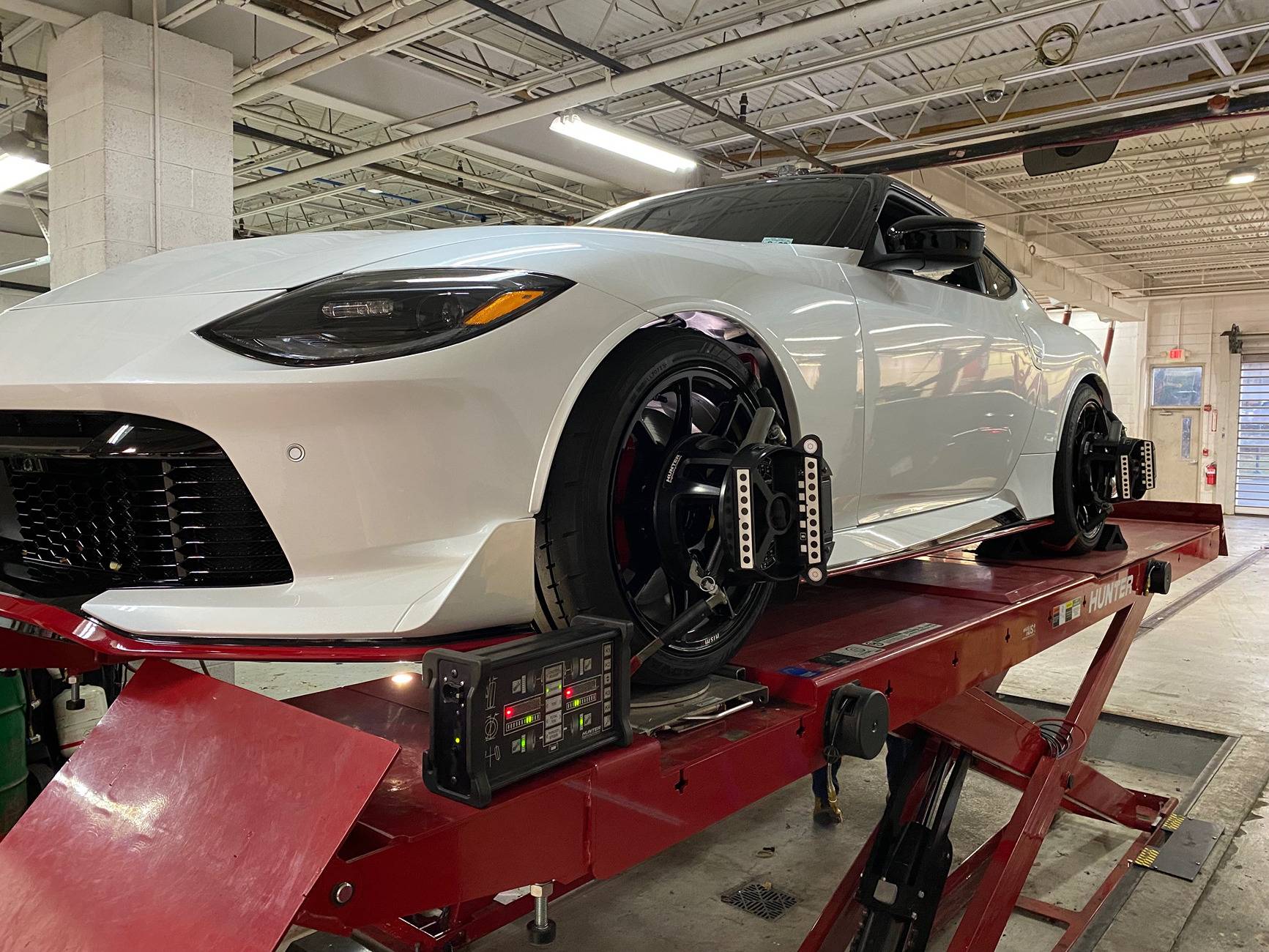

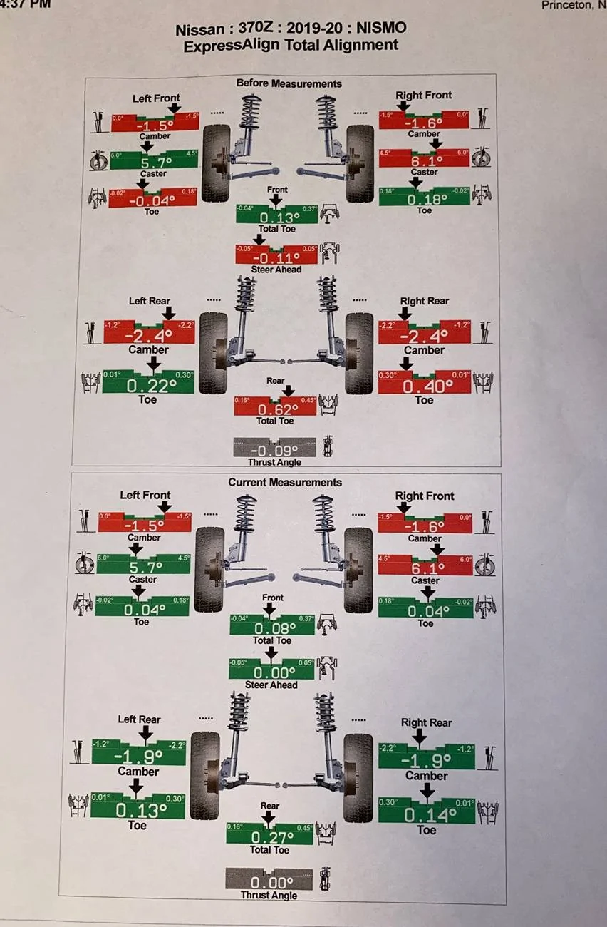

My friend invited me to his shop today so I took the opportunity to do an alignment. The shop has a state of the art in ground alignment rack. For reference my car is a Nismo Z and is set 10mm lower than factory height.
This car is super easy to align. I was able to pull out .5° camber from the rear using the maximum available travel in the stock eccentric bolts. All 4 bolts were near the center of their travel before I started so I would say total amount of available adjustment is a little over 1° from min to max . The front doesn't offer any adjustment but toe, I am pretty happy with the front spec. The -2.4° rear camber was killing my tires. I decided on a slight toe in setup front and rear. I will try this for next season and see how I like it. Any further adjustment will require aftermarket arms or bolts.

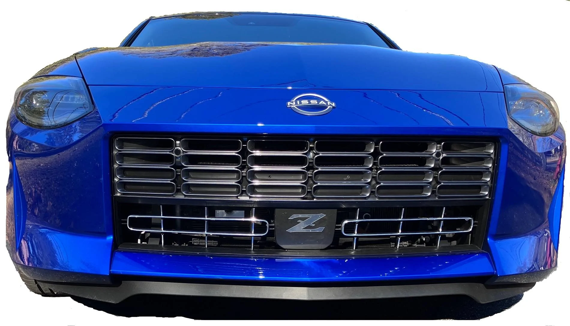

Here is what I did to fill the front end void on a new Z. I would like opinions on this inexpensive and easily reversible modification made to my 2024 Nissan Z. If there is significant interest I might consider providing the materials to others who like this new look to the front end.

I think it lools great - does it interfere with the sensor

Initially I printed the Z on a 3D printer using silver plastic and that caused the car to throw a warning if it was not placed high on the sensor. This current Z emblem is made from very thin waterproof material and has not triggered any warnings.
The backside has a reversibly sticky glue so it can be carefully removed and placed back on.

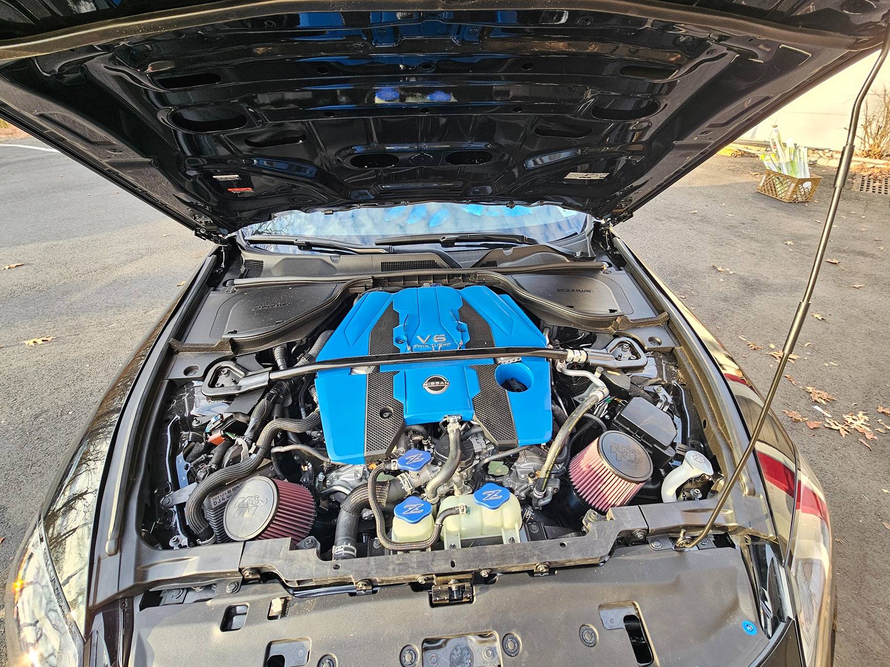

Installed RAE Motorsports CAI Titanium 3". Easy install about 1.5 hours, makes all the right sounds on downshift and acceleration. QUALITY product - any questions hit me up. HAPPY NEW YEAR all. Won't let me upload video with sound - says too large - only 19 seconds - sorry.

Youtube link? I'd be interested in hearing it
