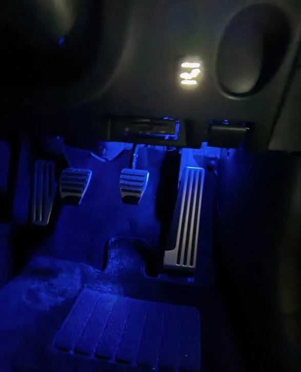

I finally got the T99F3-6GP0A kit installed at the dealership. The lights are incredibly faint. Especially the ones in the footwell area; you can barely see them. Absolute waste of money.

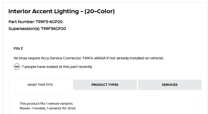

One thing that I just found, is that there is a second variant available: T99F3-6GP20
So, now I'm wondering if this variant has more intensity. Anyone know?

Here's what I can tell you. On my install, when I picked up the car (during the daylight), I couldn't tell they were on. So, I made sure they were active and I could see them by looking directly over the cup-holders, but while I was under a well illuminated space, I couldn't notice they were on. Sadly, it was the same story on the footwells. I could see some faint reflection on the tip of my shoes, but it was definitely subpar.
I suppose that if I go to a fully dark space, then I will be able to see their effect, but I can tell you they certainly don't look like their promo videos.
These promo videos show how bright the lights are on the other cars, but NOT the Z's.
That's why I'm beginning to think the other model T99F3-6GP20 is much more intense.

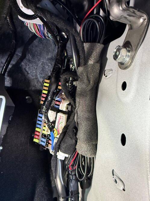

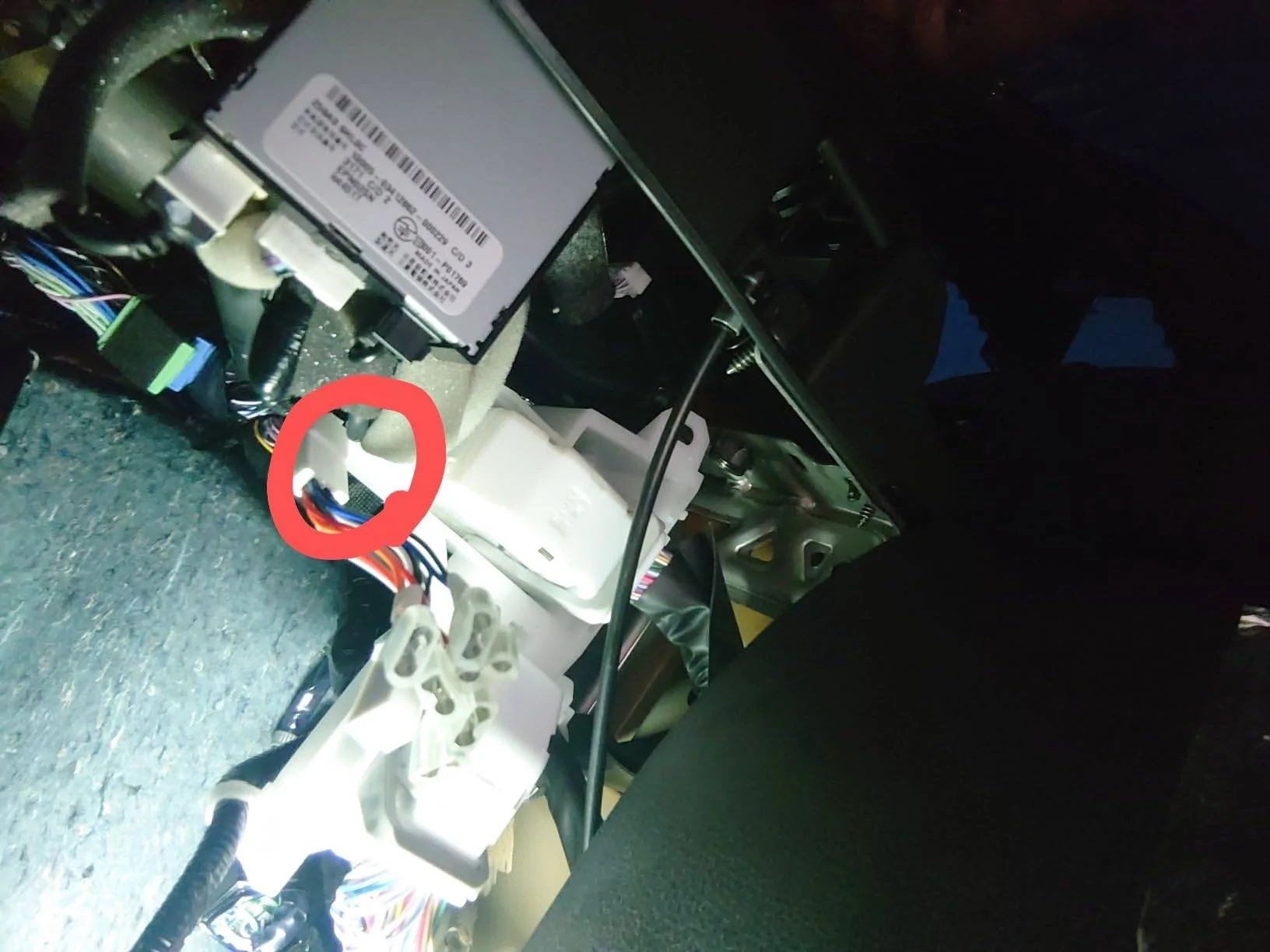

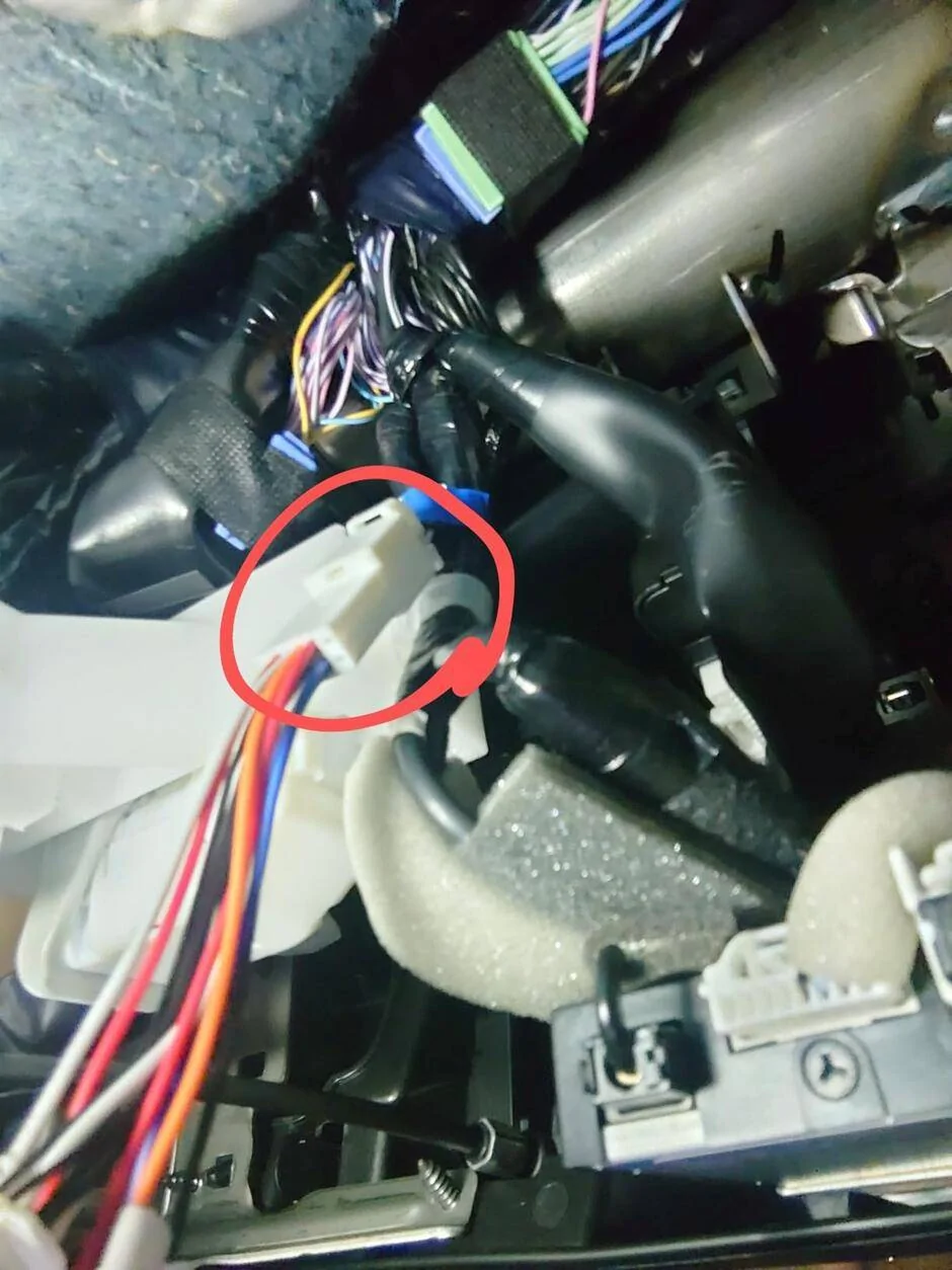

Australian Z and from what I can gather the Japan does not have it… I found a connector as per photo below…
This is a male connector on the right hand side of drivers side above the fuse box. The D-opt connectors from Nissan are male as well however these are for the USA market as the harness connector are different.

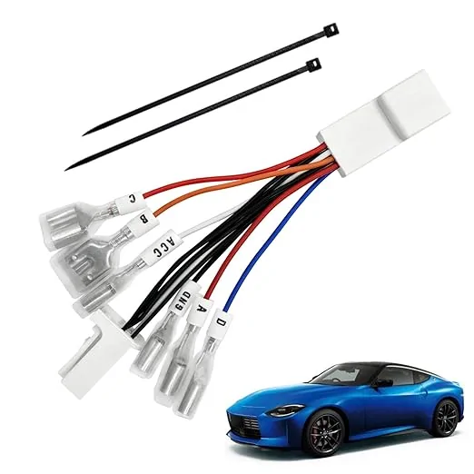

Then I got looking on google, I bought two different harness a Japanese website world shopping
Fairlady RZ34 Optional power supply BCM coupler harness ZCAR ZERO original, one single and one interrupt style, these are female type. I could not find a connector on the left hand side however did find 3 slim rectangular connectors, one near the BCM and two taped together above the BCM. I did tap into one which was lavender red and lavender pink was above the BCM and it seems it was the same wires from the door connector. This was not case. Unless I am blind, could not see any service connectors on the passenger side.
Also jumped on amazon Japan and bought two OTORAM Power Wire Harness / Nissan Fairlady Z Series / Model: RZ34 / Year: R4.4 ~ Coupler / Easy Installation. I have now got 6 wiring harnesses. Hopefully I can make use of two and then sell the other 4.

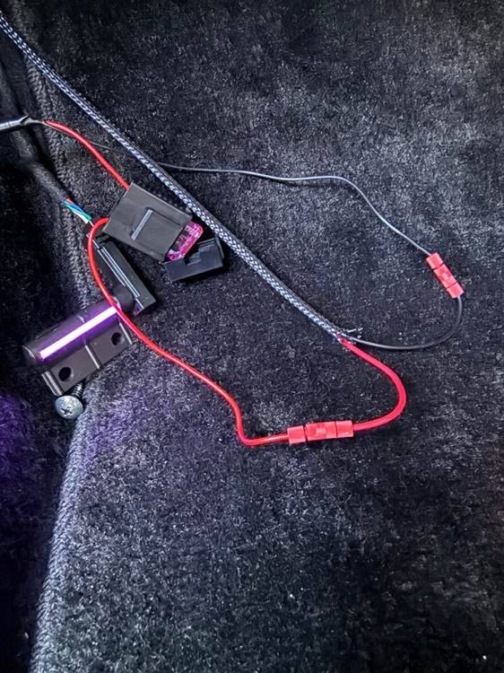

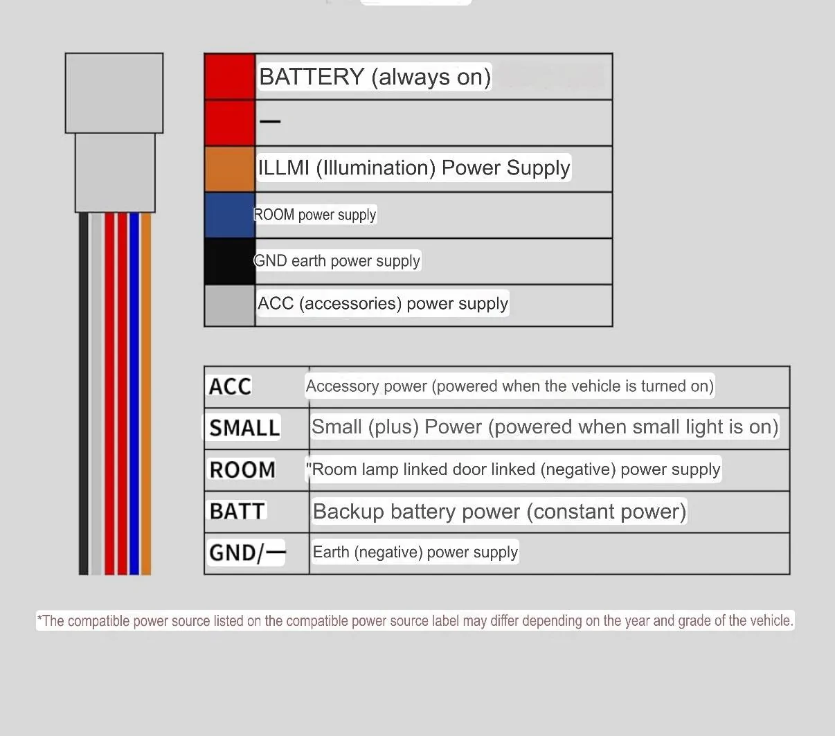

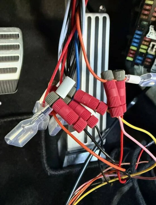

Kick plate install :So could figure where to connect the black and red wire kick plate wires I connected used a multimetre to test the wires as there are 6, as mentioned the blac, was ground the white/grey wire was acc, tested that wire for 12v current after hit pressed the start stop twice to fire up the screens. Then I tested the two red wires and can confirm both wires were hot with constant 12v on both. That left the blue lamp and orange wire Illmi wire.
Could not get any current out of these was coming out of these wires but maybe I missed the timing of when the door light switched off, best way was to turn your head lights on. Found out the black wire from the kick plate needs to joined to the blue room wire with the posi connector and the red wire to orange illumination then bingo that worked. This then gave me the answer how to connect the OEM footwell lighting as I then knew where the yellow (room lamp) and pink wire to the orange Illumination. So wired them up while I was in there with the posi connectors

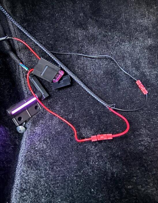

For the left kick plates, only need the Room lamp and Bat-saver connection. However there is no connectors for accessories. This is passenger / left hand side for right hand drive just to make sure there is no confusion. Glove box was removed and searched everywhere as mentioned. So when to jay car electrical and bought 3 metres of red and black wire and two metres of braded sleeving for a cleaner install. So what I did was connect this to the right hand side connector, so used the large white cable tie that came with the lighting kit and taped additional wire I put through the braded sleeving and fed it under dash behind the air ducs as it had a gap behind there.
Tested everything and then it was time to button everything up.

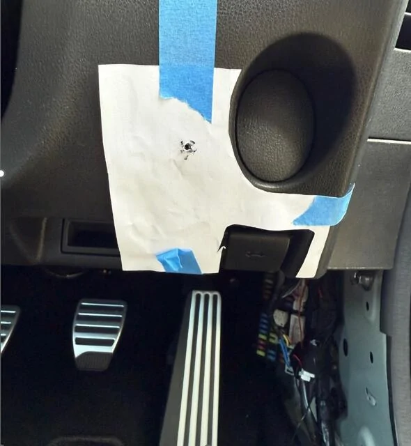

Some random pics below. Me reversing the template for the light on off switch.

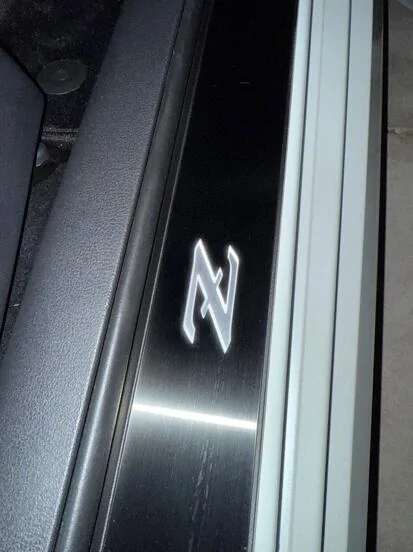

Testing below light, and there is some of additional wire for the kick plate that was sleeved.

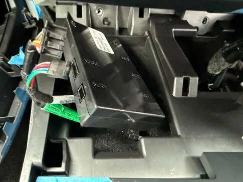

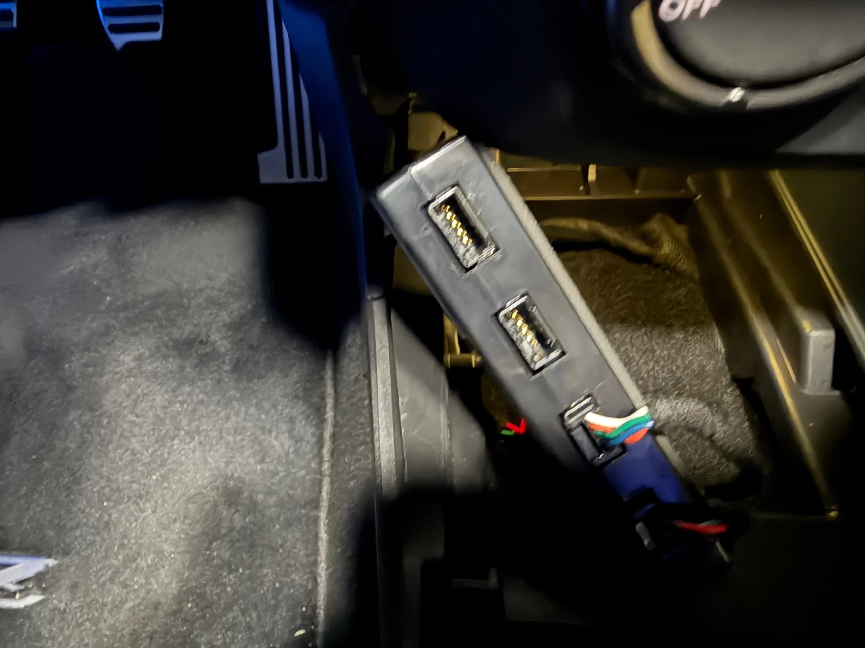

This is where the light control box need to go, after you double side the tape, connect wires slide that box down about 3 cm into the pocket so it does not impend the phone tray when you put that back in.

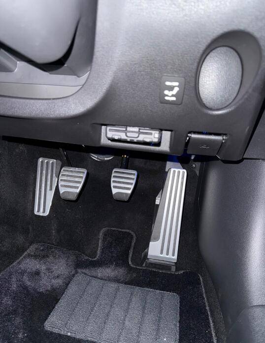

Note that bundle of wired was some of the oem accent lighting kit however the bulk of it was a fun little addon, I installed a Japanese ETC card reader for the bit of fun. Note I used the card holder slot to mount it, as the card holder slot can be removed with two screws and I assume Nissan made that slot for a ETC reader,
ETC Reader install, Panasonic CY-ET926D ETC Onboard Car Device. removed the card holder that basically does nothing and it the perfect spot for that nice welcome at startup ?.

^Mine is AUS delivered and I've ordered the OTORAM connector that fits between the existing plug connection, leaving the tails for the accessory connections, otherwise I'd take you up on your offer.
