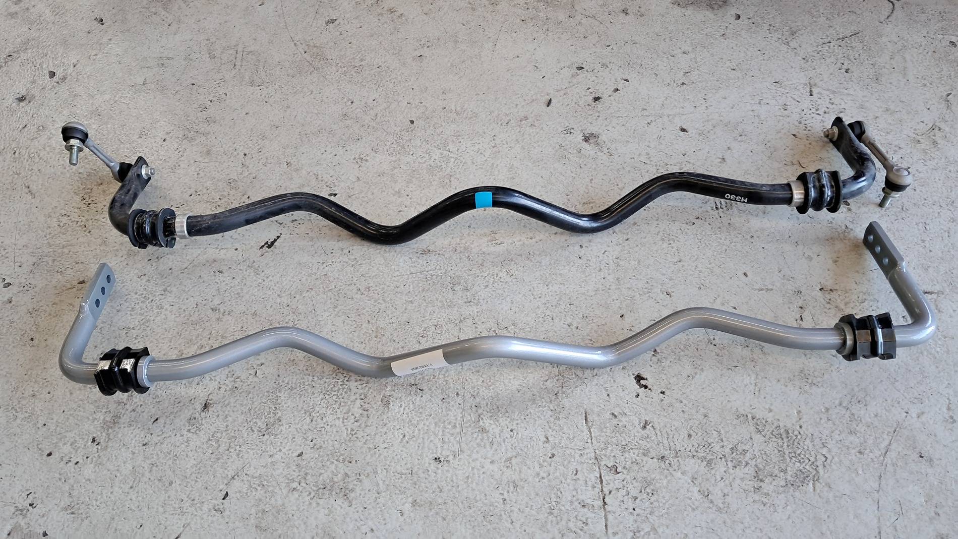

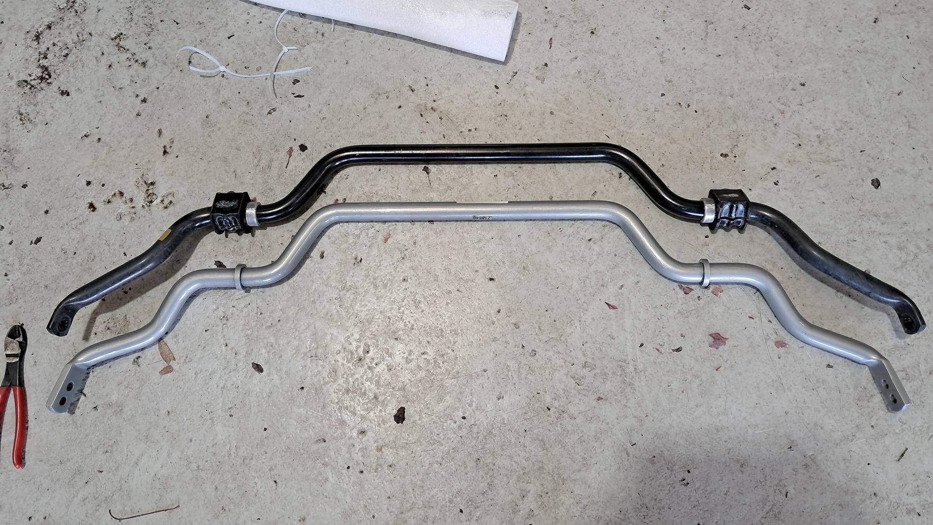

Hi all,
Just some feedback from a set of Whiteline Sway Bars I had fitted today on my 2024 Nissan Z. The original Sway Bars from factory are hollow inside. The Sway Bars I had fitted are solid steel, much heavier than the original Sway Bars. Close to double the weight. Set them on the softest setting and now my Nissan Z corners beautifully with minimal body roll. The way it should have been from factory. I absolutely love the car now. Completely satisfied!
Happy days to all, Paul from Sydney Australia

Good feedback @Paul useful actual experience. I'm still evaluating, a recommended Hotchkiss is also hollow, although only one setting. I'm not sure if Stillen's is solid or hollow. Weight is also consideration. I'm doing step-wise since not 100% sure the Z will be my track car (Cayman S is the current). Streetability is important too, i.e. not too stiff at softest setting but better than OEM. Whiteline is also a proven brand, used it on my track STi years ago.

Hollow vs. Solid is only an apples to apples comparison when they are the same size in diameter, in which case - solid is the better option.
If the hollow option is a few more mm in diameter, the actual performance is the same, while having a reduction in weight, which some people find more valuable - both in a weight savings perspective as well as the cost perspective, as a hollow, larger diameter bar would cost less to make and sell.
