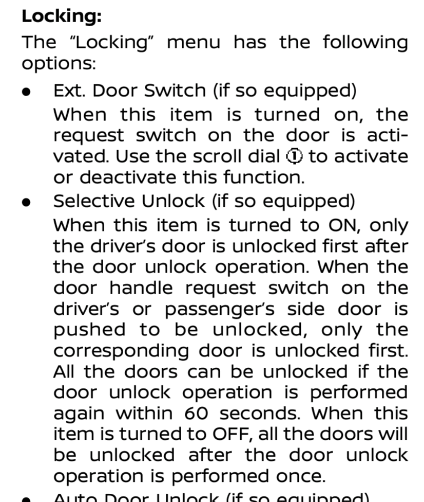

What other features are available when tuning? Example.. can I change the door unlock logic? I want 1 button press on the door or key fob to unlock both doors.
If so, anyone found anything interesting or worth changing?
Does your car have "selective unlock"? It's mentioned in the owner's manual.
It's doing the "selective unlock" behavior now. I imagine I have it.. didn't see it in the menu's before.
Found my problem.. it's accessible from the steering menu, not the center menu.
Also.. I don't see how you can access the menu from the "sport" tach.. gotta be in normal or enhanced. :rolleyes:
So from the steering wheel.. push the waffle (shortcut menu button you use to change displays)
Settings > Vehicle Settings > Locking > Selective Unlock (default on, I wanted off)
