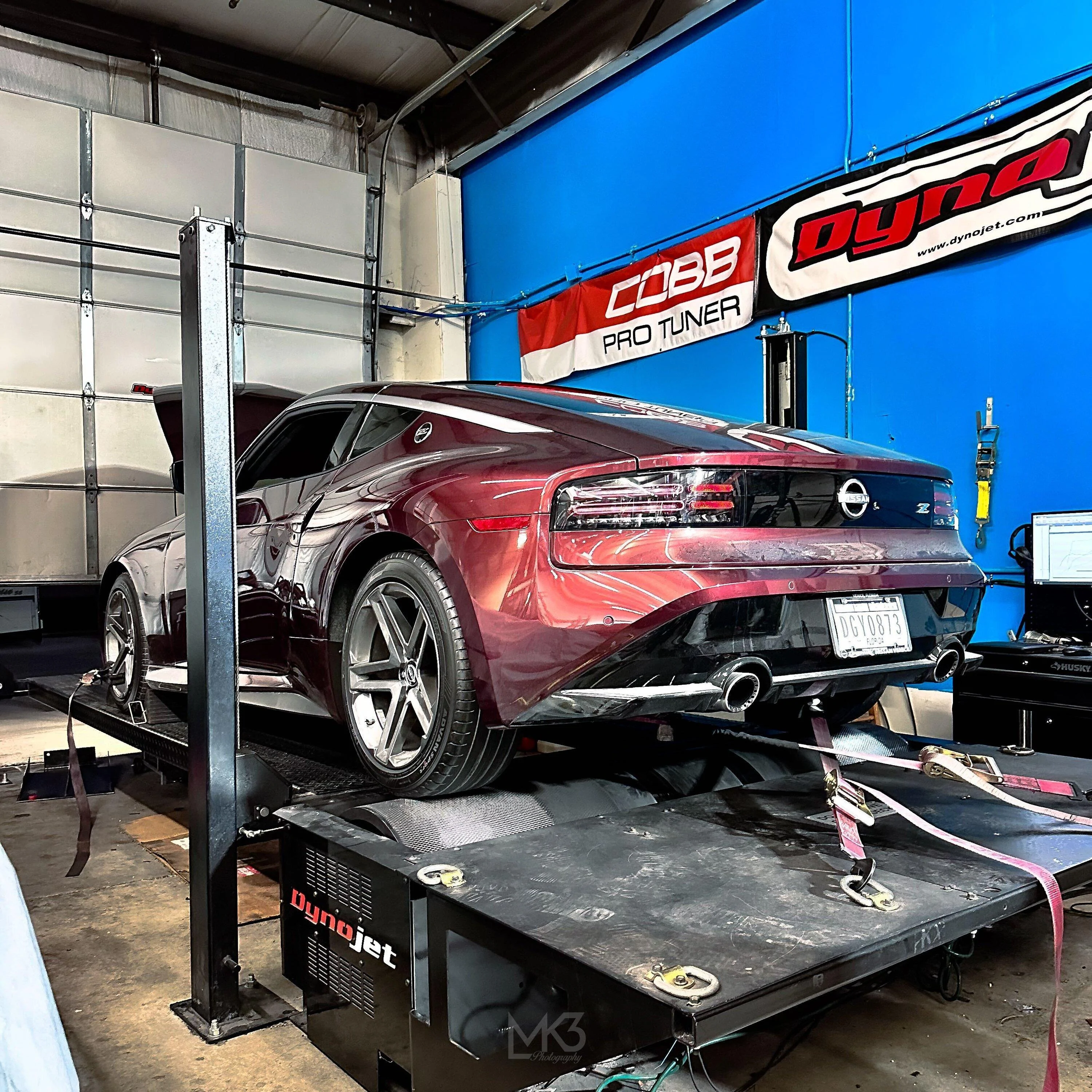

Right off the bat, we encountered an issue where we could not take a data log of the stock file within the EcuTek software. Because of this we had to capture a data log of the stock tune file with another device to get the information we needed. Once we got that information and reviewed it, we were finally able to flash the car with EcuTek and begin the tuning process!
After flashing the car, we ran into an issue where the torque converter would not lock up when doing a pull. We spent many hours trying to figure out if we had a defective part, dyno issue, or software issue. After discussing this with both EcuTek and AMS Performance, we were able to learn that there is an issue when flashing the car with EcuTek that has not been fully resolved yet. It is important to note that this will not cause the vehicle any harm, but rather the TCM is failing to reset after uploading a tune file to the car. (To our knowledge at this time) In the meantime, we have identified a workaround that has allowed us to move forward.

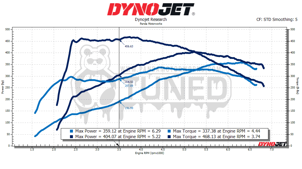

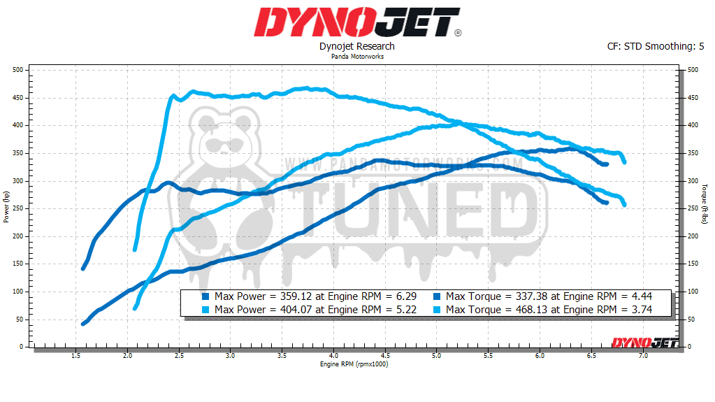

Our lead calibrator then started refining drivability concerns that we had found in the stock data. If you look at the dyno graph, you may notice that the torque curve on the stock run is wavy. In our stock data we noticed the the boost levels fluctuated as RPMs increased. This lead us to address this issue before adding more power. With this, were able to address the boost curve which gave us more consistent torque though out the powerband. This is a prime example of our use of the Three Pillars in our tuning R&D process.
After addressing the boost issues and making various changes to aid in reliability and drivability, we were then ready to start increasing power. When looking to increase power in DI Turbocharged vehicles, there are many different methods to do so. Before making big changes to the power of the vehicle, we decided to sample a few different methods before we locked in what we feel will be the best strategy to make power on the Nissan Z. When applying this strategy and upping the power, we found that this vehicle is octane limited as we find in many DI turbocharged vehicles. At the time of testing, our Z had 91 octane fuel and we were very limited on the amount of timing that the vehicle would accept in the mid to upper range. From our past tuning experience, we feel that this car will have very strong gains in the mid to upper RPM range when adding a higher octane fuel, such as an ethanol blend or race gas.
Our first sample of R&D that we are excited to share with the community shows significant gains throughout the powerband. We mentioned earlier that power under the curve is very important to us, and if you look closely at the graph, you can see gains of over 150 ft/lbs of torque in the lower rpm range around 3500 RPM. At this same RPM, we were also able to pick up over 100 wheel horsepower under the curve. Another exciting thing you will notice while looking at the graph is the average gain throughout most of the powerband. When doing the math, the average net gain of tq is 43.74% and hp is 30.57%! One thing our R&D seems to have uncovered is that the turbos past 6,000RPM are out of breath. It will be interesting to see if this is a restriction in a particular part or if the stock turbos just struggle past that 6,000RPM mark.

Was the car running on 91 during this pull ?
Did you make any changes to stock components?

Very nice toque gains down low and doesn’t dip until past 4k, great for pulling off corners! Notice any heat soak, and the pulls were on 93 oct?
chris@pandamotorworks
Chris
Dec 21, 2022
34
St. Louis
www.pandamotorworks.com
2023 Nissan Z
These were on 91 OCT
and nothing major from pull to pull but its winter here and cooler than normal. I expect some Heat soak in the warmer months!

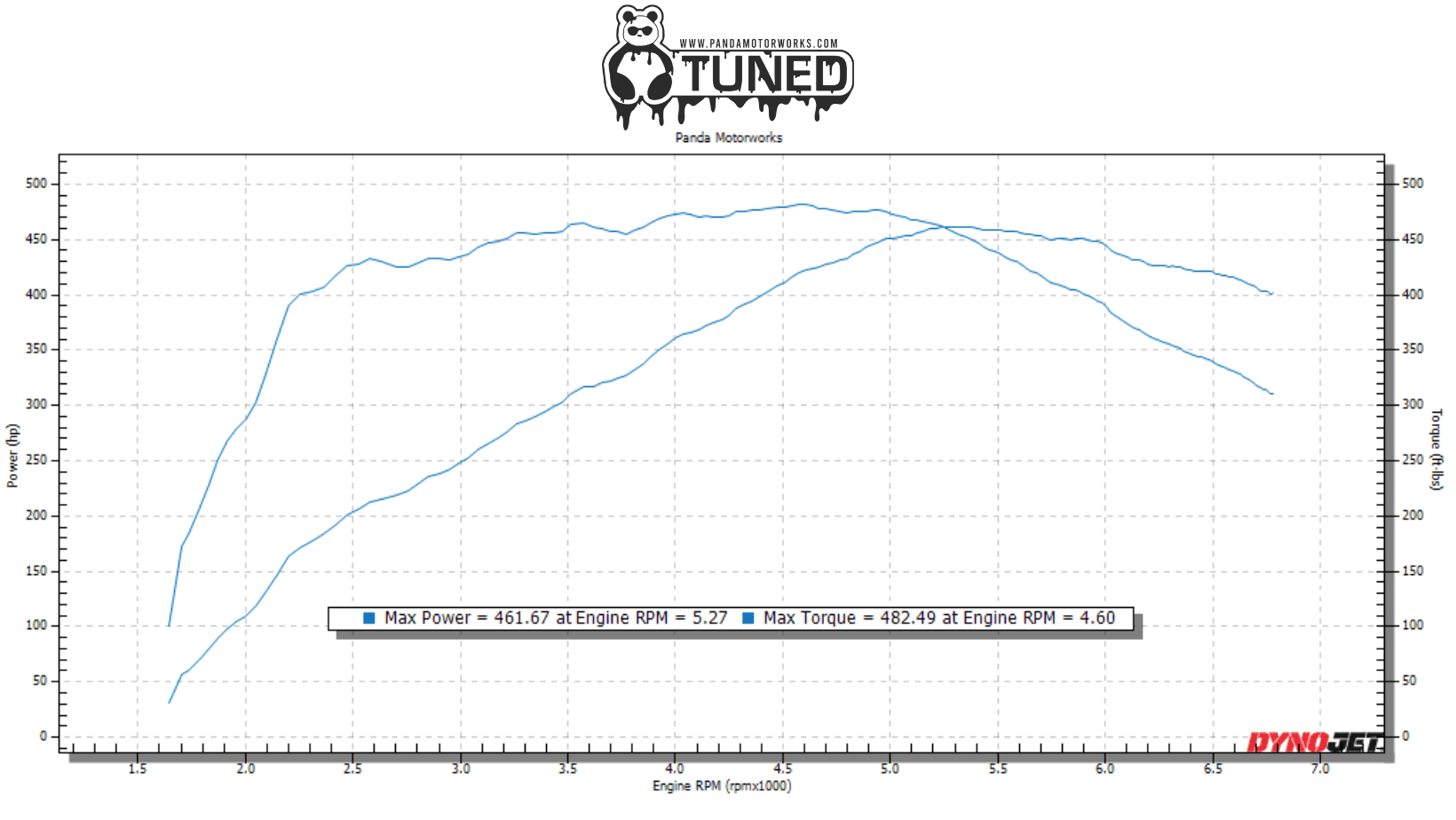

We Were Back On The Dyno This Week!
This time with a MAP Performance Tubo Back featuring GESI Catalytic Converts & E30 Fuel!
Check out the graph below! Let us know your thoughts on this configuration.
