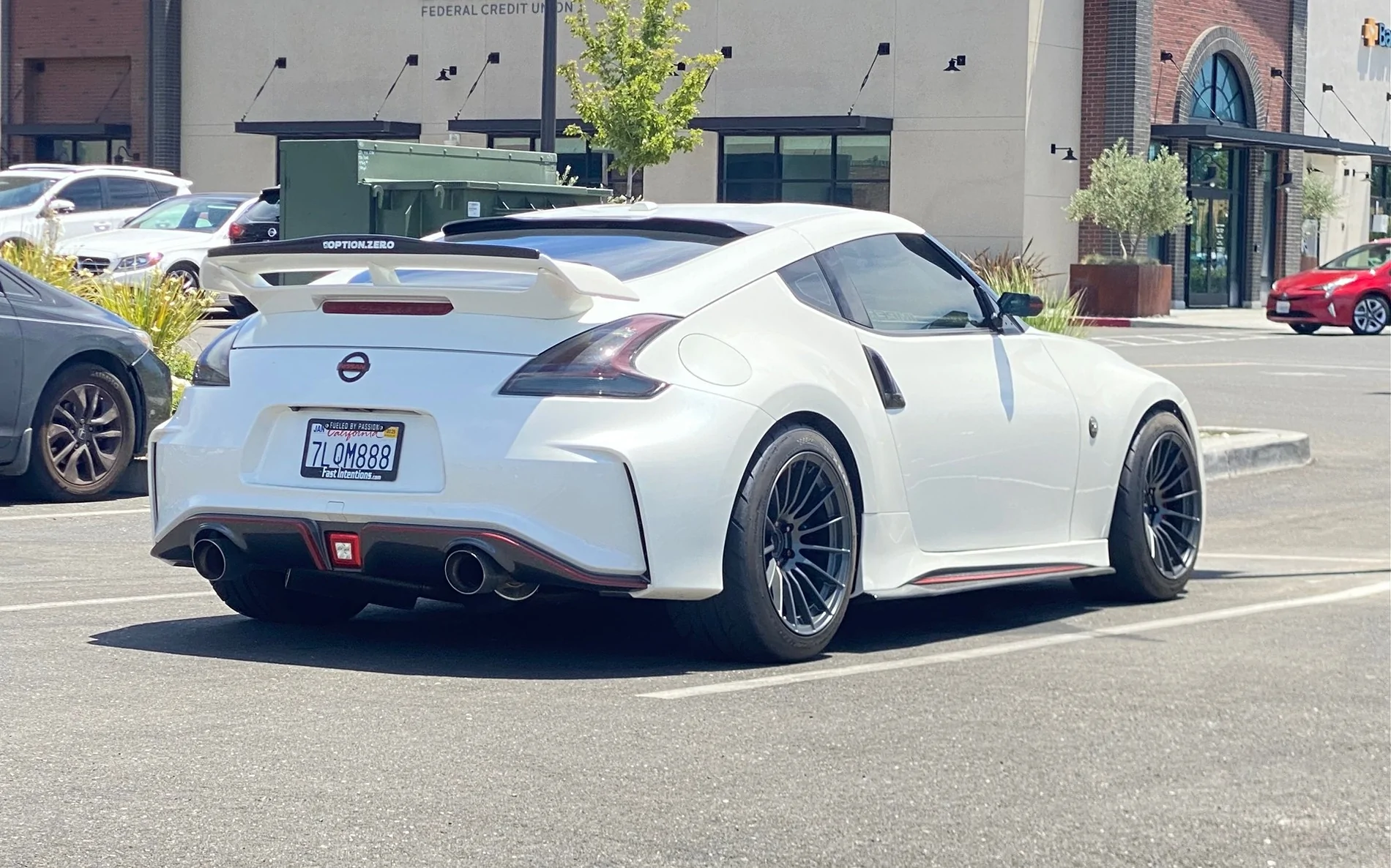

For width reference here is my 285/35 RE71-RS on 10.5" Nismo V2 wheel +23, my square set.

You said you were running 275/40 on an 11 inch rim. That would be quite stretched wouldn't it?
would not call these as stretched by any definition
pretty much all track tire makers are gonna lie and give you more width than they advertise
it is racing tradition to cheat afterall
