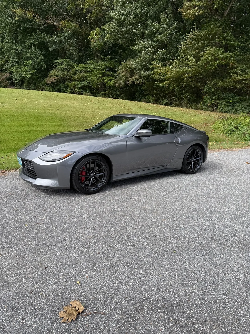

I am going with Michelin Pilot 4S in 265/40r19 and 285/35r19 on stock performance wheels. Car is on stock performance suspension. 24 Nissan Z Performance. Will this fitment work with out issues? TIA.

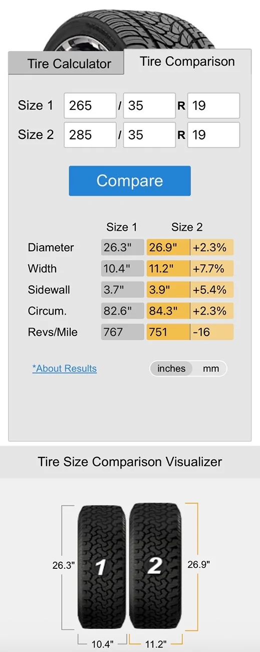

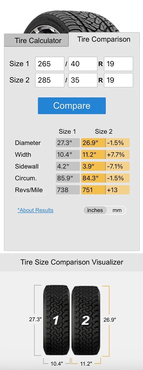

Do it, the stock tyres are too stretched
I would personally go 35 all around. If you go 40 in the front, you'll have a taller tire in the front, which I think looks pretty goofy.
It's not much taller though because it's a percentage of the width. 35 profile front is noticeably smaller

I personally would rather have a rear that’s .6” taller than a front that’s .4” taller.
