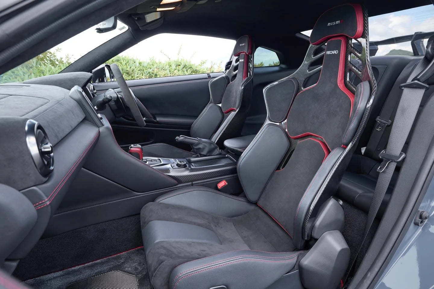

These are the dream
Nismo GTR seats on one of the final special editions. Upper half is styled like the Podium - i've seen them popping up in some limited edition cars like STI and GR variants.
Price is unimaginable, before figuring out how to fit them.

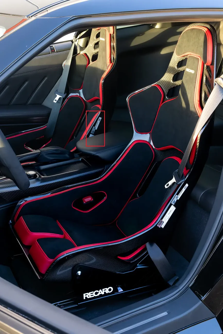

Here's the "full" Podium
Sadly I don't think i fit in them. Also they're probably $5k+

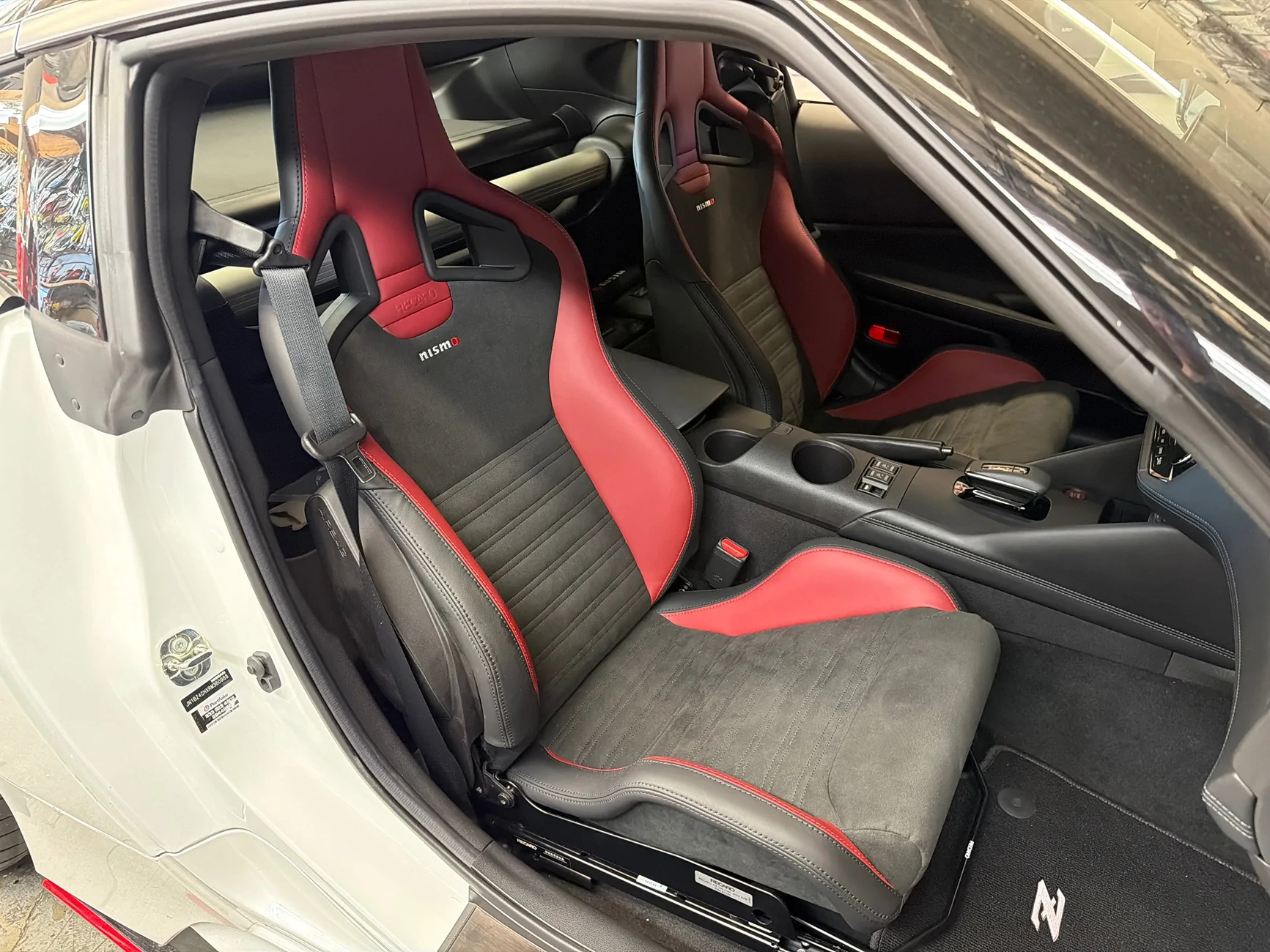

I performed this exact mod on my 370Z Nismo, transplanted Juke Nismo Recaro seats into them (you can kind of see them through the windshield in the picture below) and will attest that it’s a lot more involved than just going the full aftermarket route. The Juke has a taller, more upright seating position so I had to get a whole new base fabricated for the seat in order to make it work/fit on the 370Z. You will also loose the passenger airbag sensor because those are on the seat rails on the Juke and not imbedded in the seat cushion like it is in the Z.

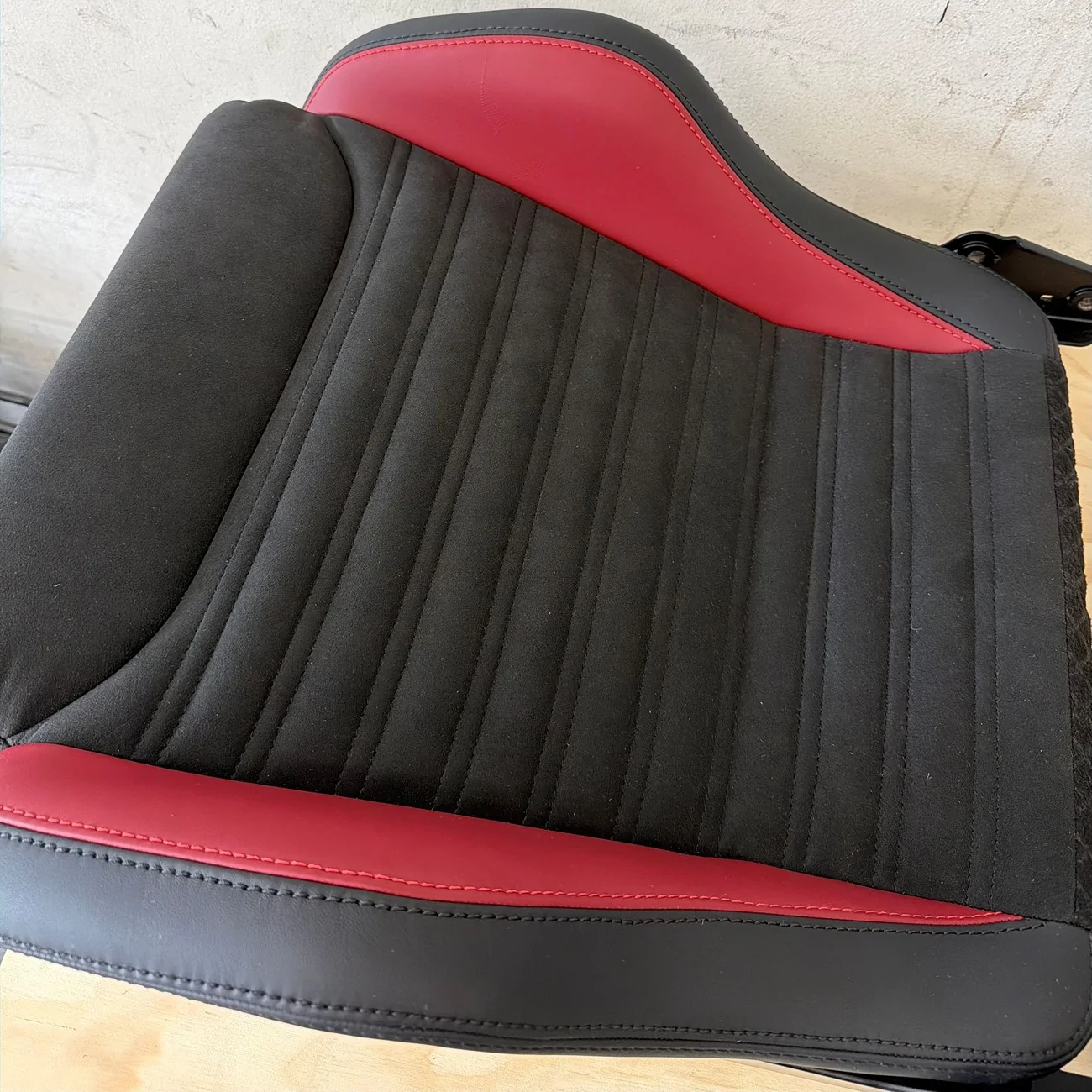

I'm starting to see bolster wear in a spot, and have modified how I get out of to try and slow it down.
Do people make replacement covers for the Sportster CS? Meaning, technically I guess, the upholstery itself, not a cover you'd slide over...like if I pull a seat, take it apart, remove/replace the factory alcantara/pleather, reattaching it to the seat frame over the factory foam.

I'm 6'5" and I fit nicely in the Nismo buckets. I know this thread is a little older, but to answer the original question... the Nismo Recaros are substantially more bolstered than the Performance. Well, the driver's seat is. The passenger seat has the same seat bottom as the Performance.

Both the driver and passenger seats have the OEM bottoms, only the seat back is Recaro. Compare them to true Recaro bottoms and the bolstering doesn't even come close.

Regardless, the seat bottom in my Nismo's driver side is different than the seat bottom on the passenger side. They both look similar (same fabric) but the bolstering is much higher and much more rigid. On the driver's side, I have to physically lift my leg over the bolster. On the passenger side, I can directly side exit with no fuss.
