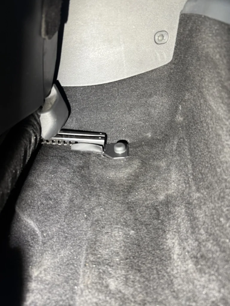

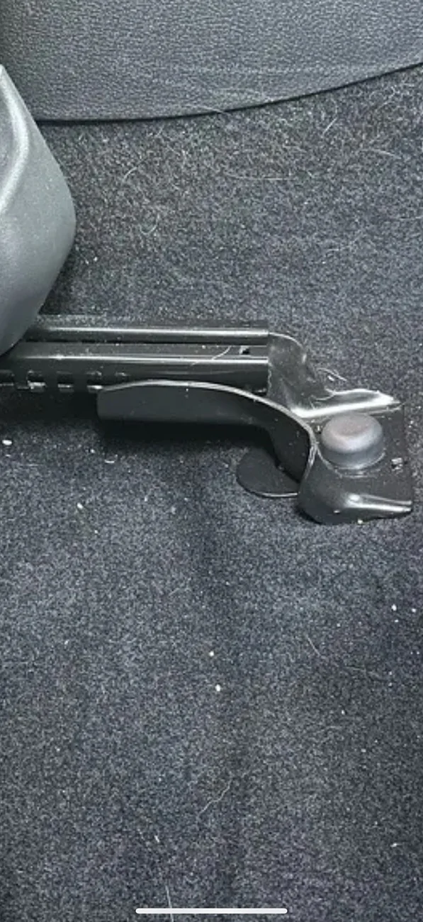

I found that I needed a few inches more headroom when I wear a helmet for track days. I noticed this bracket under the seat looked like it had a lot of room underneath it so i found a metal fabrication shop in my area and they helped make a new one
