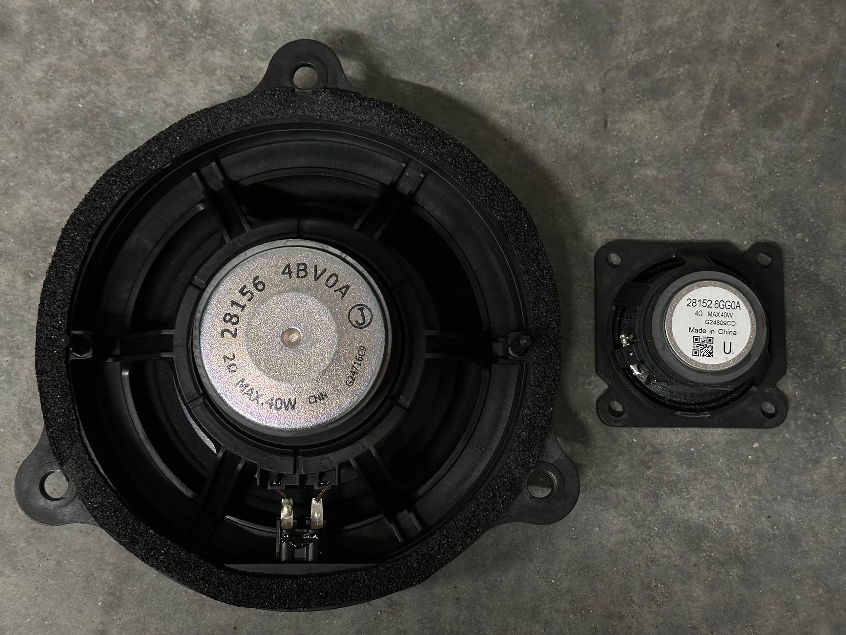

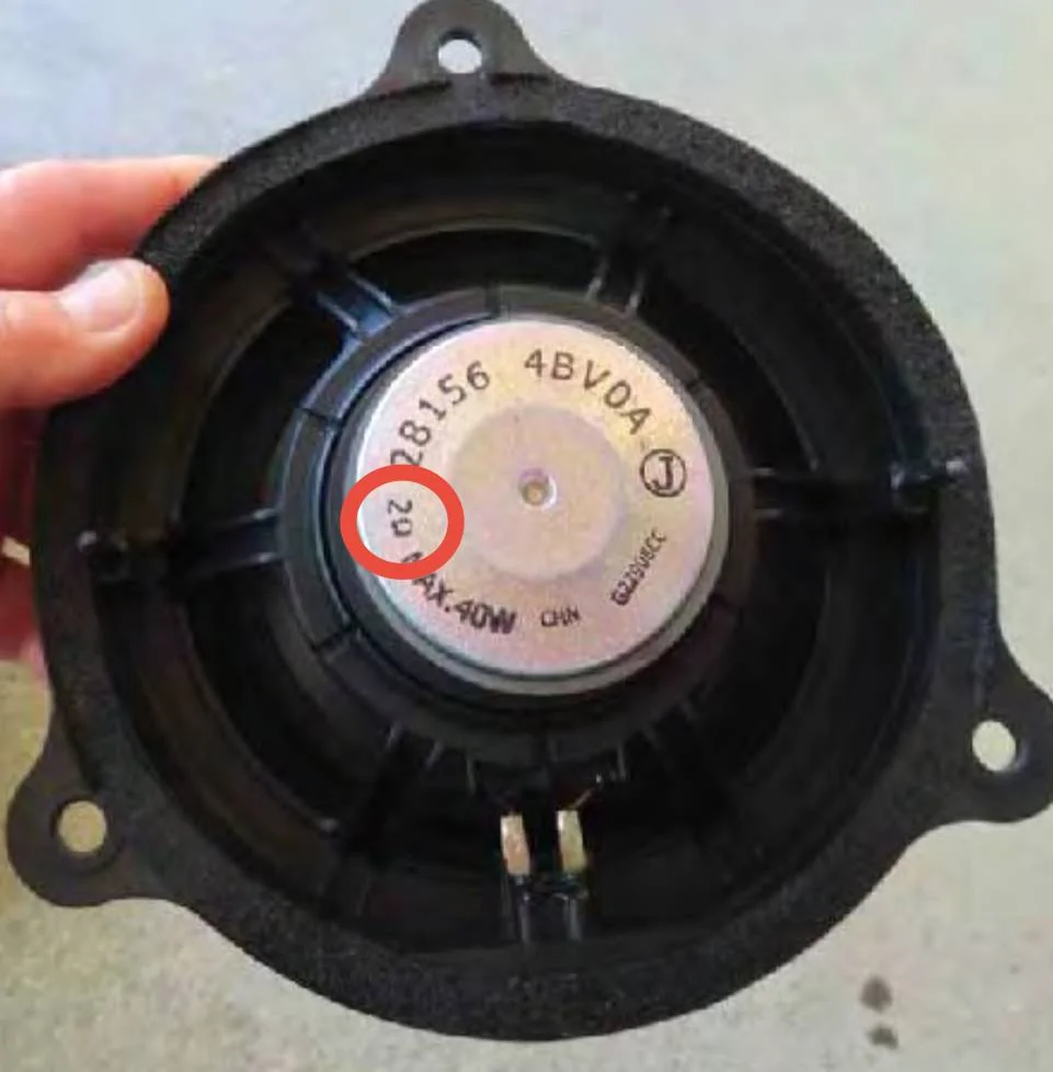

@Mugzilla, I was prepping for the install and made an interesting discovery… While the dash and rear speakers are 4 ohms, the factory door speakers are 2 ohm. Makes sense, since they would want most of the power directed to the biggest drivers, but I had never considered there would be speakers of different impedance within a single system. I’d imagine that’s why you weren’t as impressed with your door speakers as the dash ones; they are only getting half as much power as the stockers!
Unfortunately, the speakers I already ordered are 4 ohm. I’ll probably just hold on to them for when I add an amp down the line. Far fewer aftermarket options at 2 ohm, but I’ll see what I can come up with.

Do you still have the stock 3.5" speakers? Are they 2 or 4 ohm? (I threw mine in the trash 2 weeks ago.)

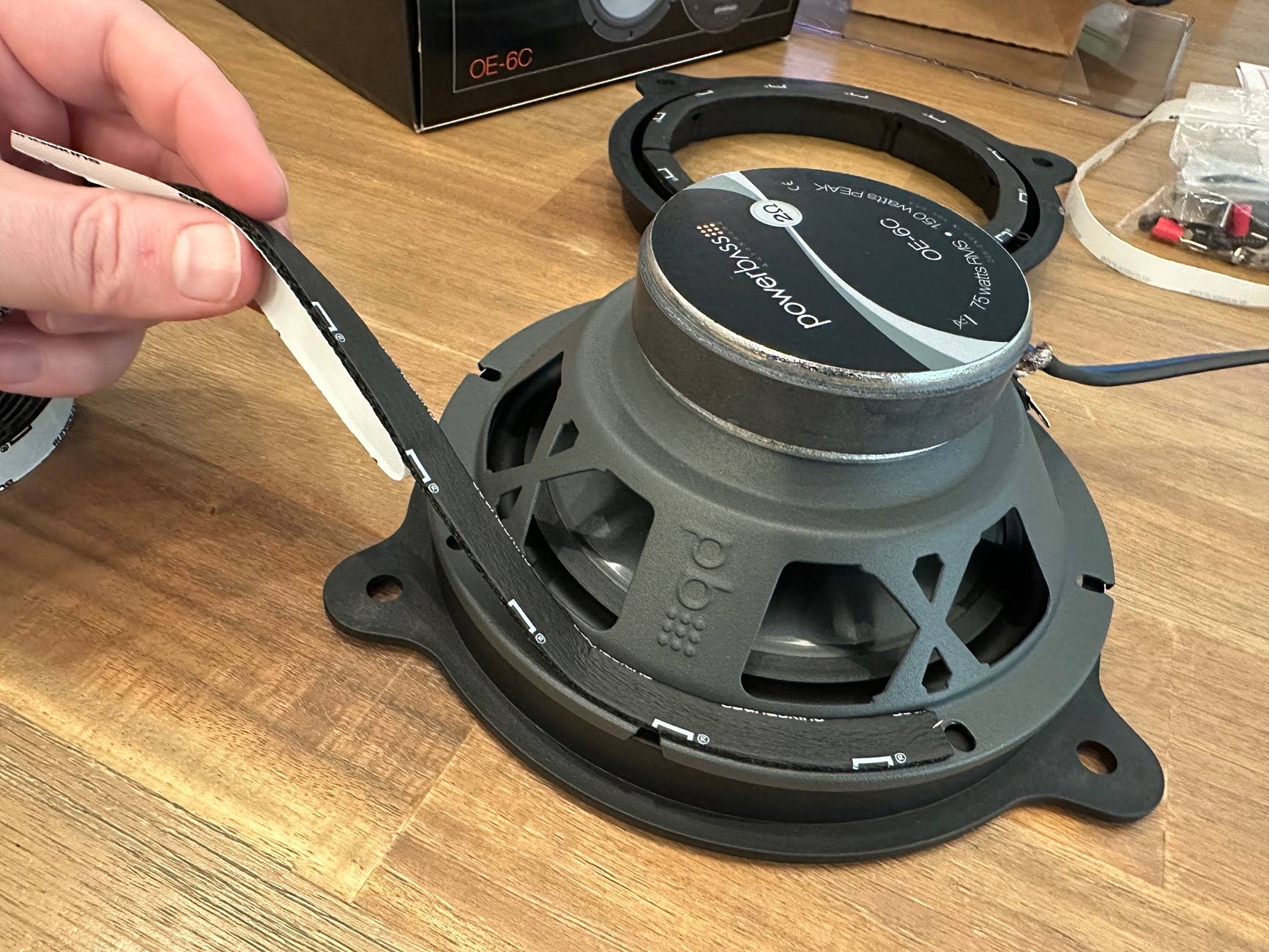

My goal for this project was to improve sound quality by replacing the cheap OEM paper cone speakers. I also planned to apply sound deadening treatment to the doors to reduce road noise and unwanted vibrations.
For this project I chose the Pioneer TS-A709 for the dash and PowerBass OE-6C woofers for the doors. I chose a two way over a tweeter for the dash because I prefer a much lower high pass frequency on the front speakers so I get as much of the high frequency directional content at ear level as possible, creating a better soundstage and leaving the door woofers to fill in the low end. The included HPF for the TS-A709 is at 850Hz. If I were running DSP, I’d probably go an octave lower down to 400Hz, again, to get as much of the high end as possible up at ear level.
I have “bypassed” the rear speakers by moving the fade on the head unit 100% forward. The rear speakers are practically useless the way they are mounted with no enclosure and I’m more interested in a proper soundstage than a tiny bit of rear fill, so I’m not addressing the rear speakers as part of this install.

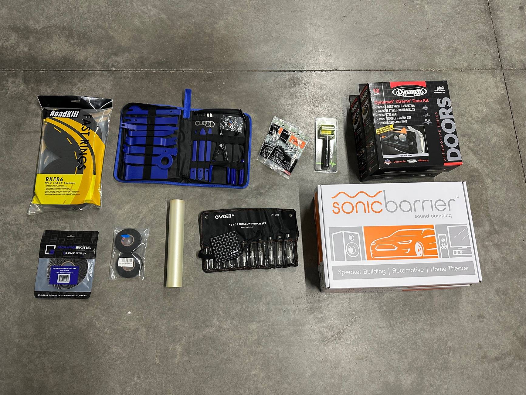

Here are the install materials (left to right):
  • Roadkill FastRings foam rings and rear reflection pad for door speakers
  • Dynamat trim removal kit
  • Factory speaker harness adapters
  • Roller for applying the Dynamat material
  • Dynamat door kit x2
  • Soundskins foam tape
  • Fabric tape
  • Clear transfer tape for transferring door panel outlines to the Dynamat sheets
  • Hole punch kit for cutting holes in the Dynamat to accommodate the various bolt and tab holes
  • SonicBarrier, a cheaper sound deadening alternative to Dynamat (not used in this project, I purchased for when I sound deaden the trunk area)

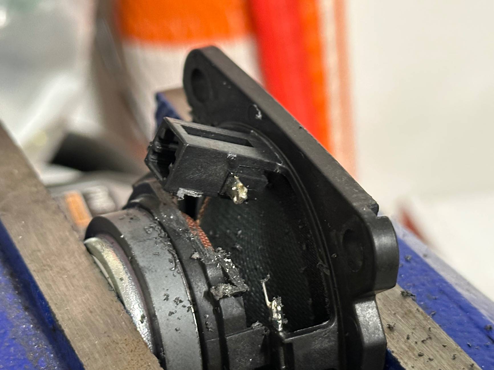

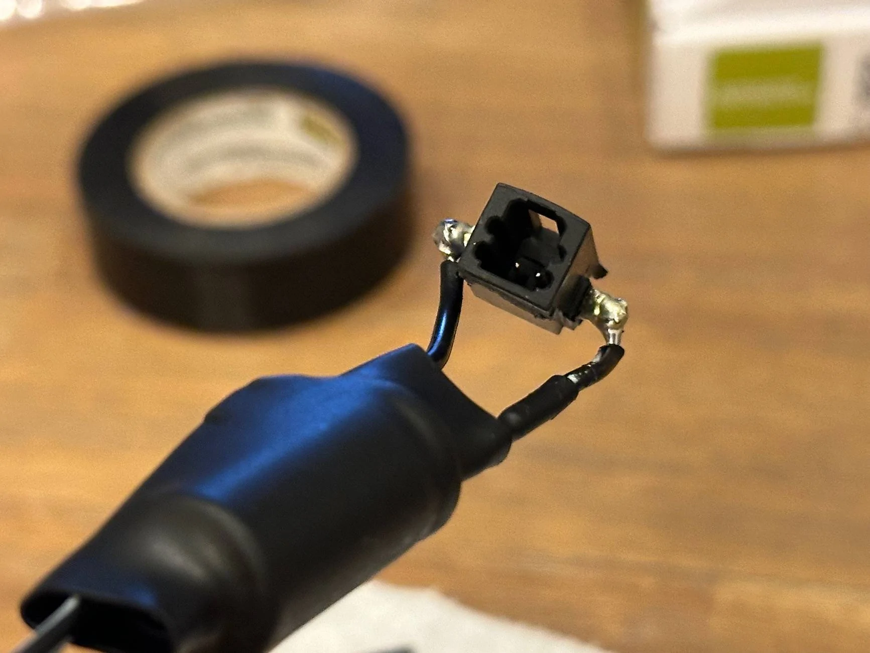

First step was to replace the dash speakers. I didn’t document much here as the process is already covered earlier in this thread. However, I ran into my first issue: the harness adapter I ordered was not correct. I don’t know if Crutchfield recommended the wrong thing, or shipped the wrong thing, or if the OEM harness changed for ’24 model year. But it wasn’t even close. I already had the car apart and all the audio equipment set up, so I decided to just roll with it. I hacked the female plugs and terminals off of the factory speakers to create my own adapter harness. The body of the factory speaker is soft plastic, so the hack saw cut through the top part like butter, and then I was able to cleanly snap the plug off of the rear face of the speaker from there.
And here is my new adapter harness with the crossover wired in. The terminals were covered and the whole end was wrapped in cloth tape before install.

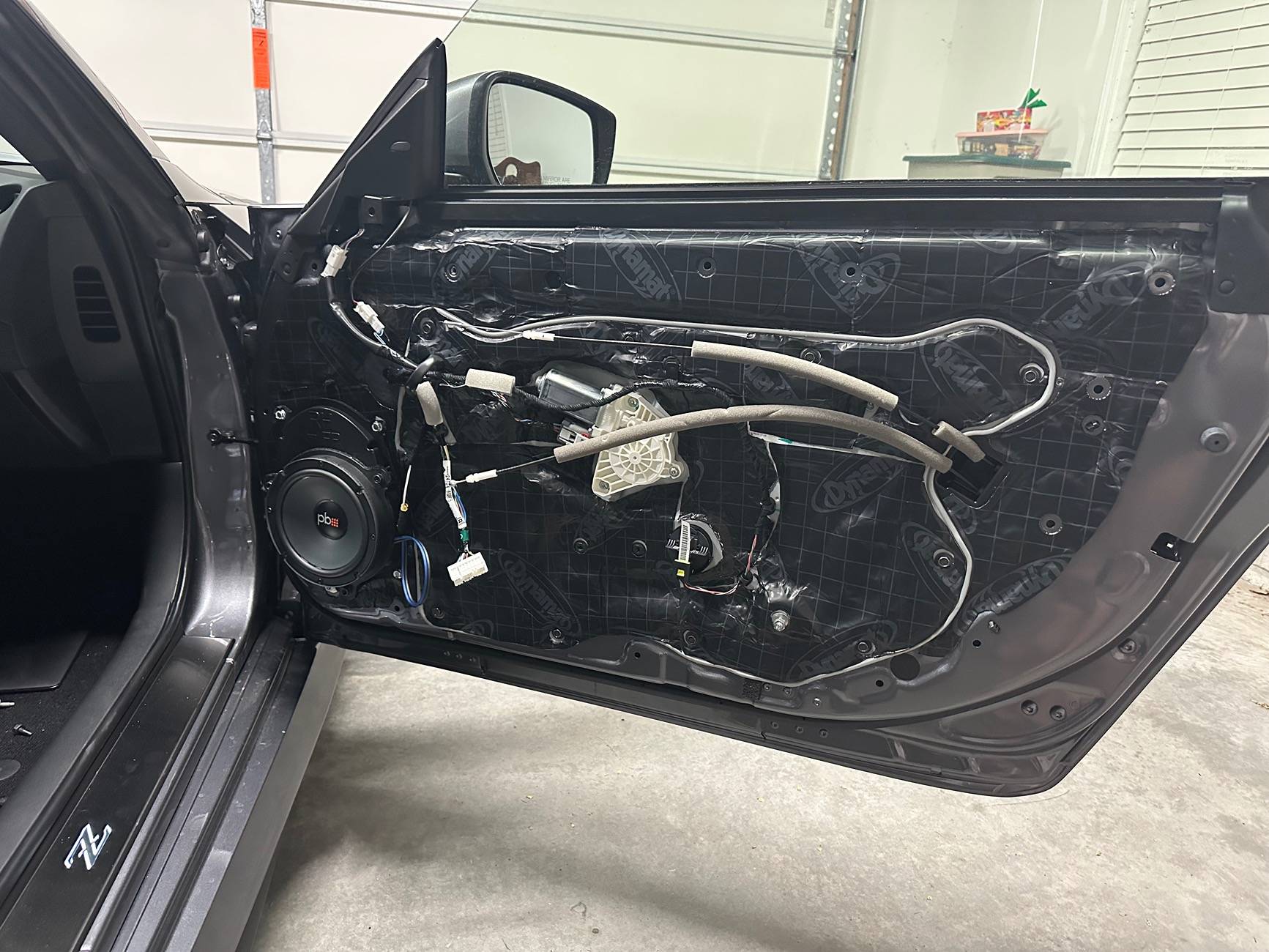

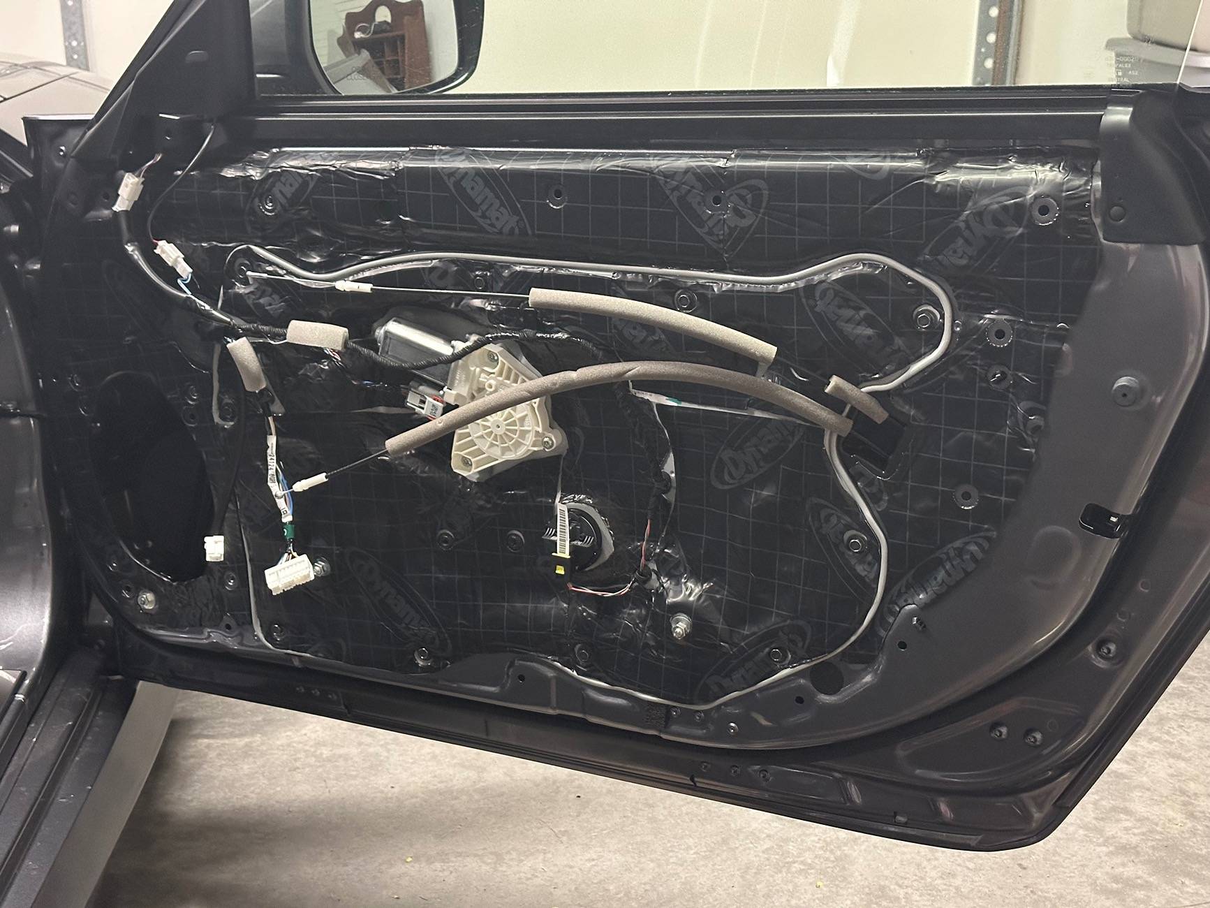

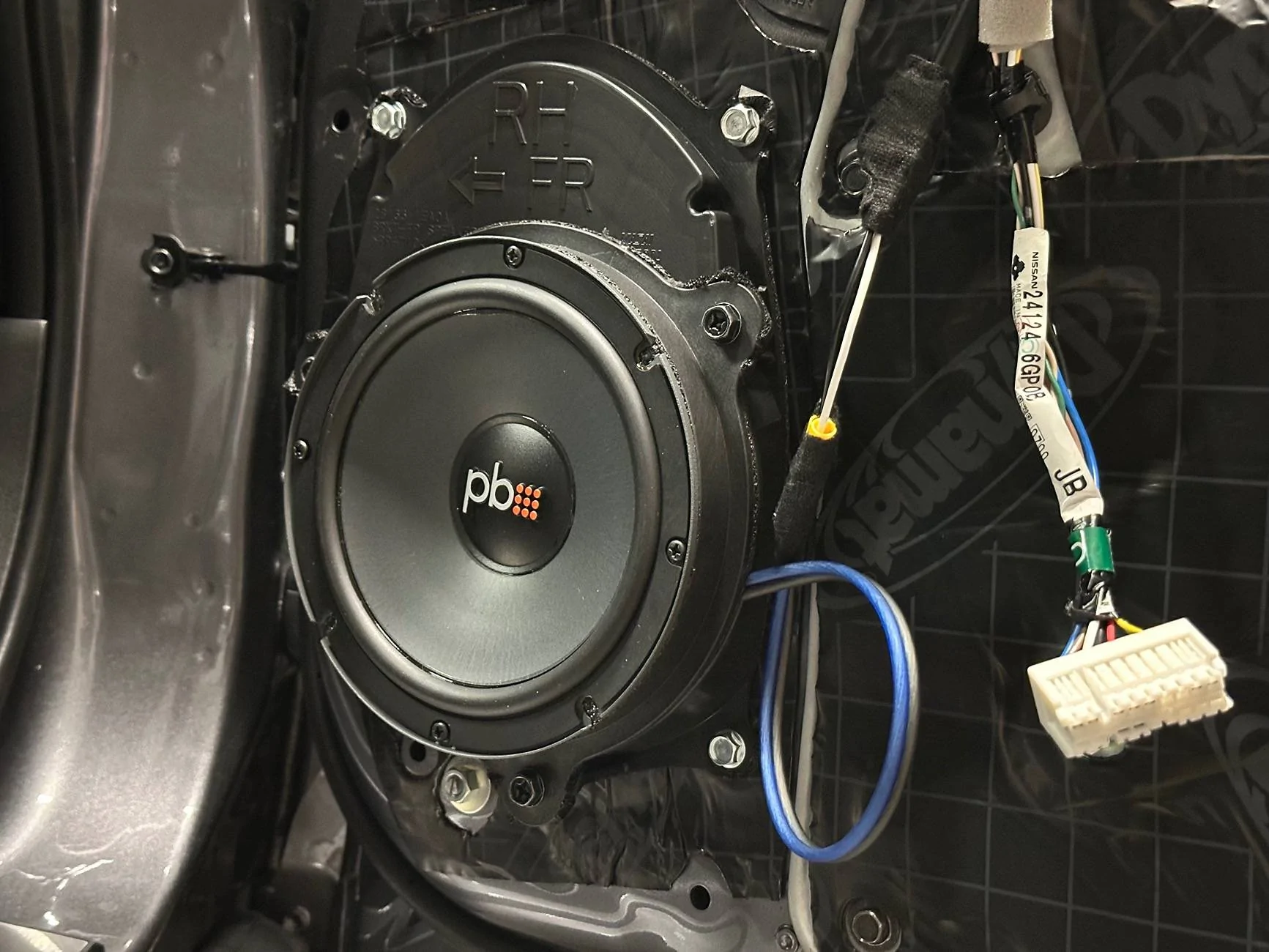

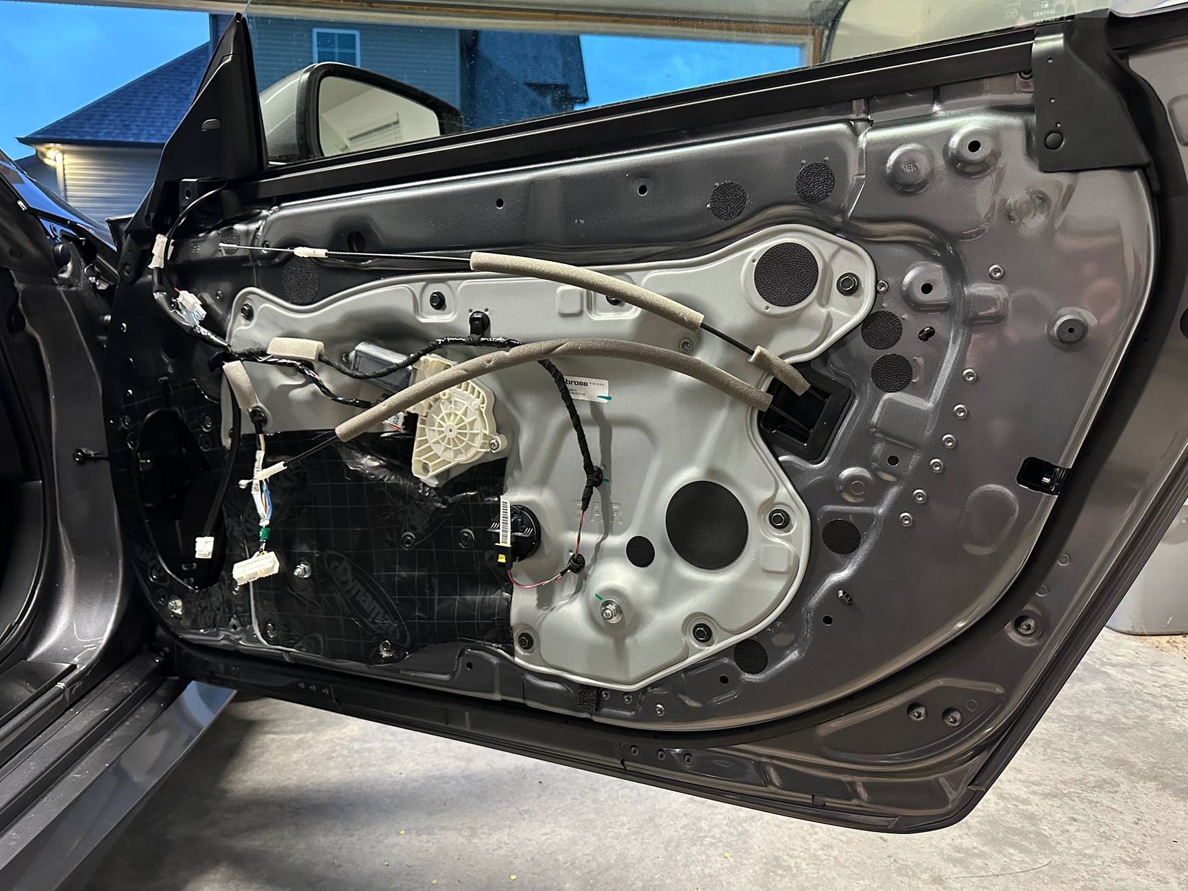

Next was the door treatment. Surprisingly, the factory door setup is actually pretty good. Typically a door will have large holes in the inner skin for access. A lot of the benefit of treating the door is to close up those holes so the door becomes an “enclosure” for the woofer. But in this case, Nissan integrated a cover (the silver part) that closes up the holes. It’s cool that they did this, but unfortunately means there will be less benefit to the sound treatment. But I decided to do it anyway because it could still reduce some road noise and resonances.
And here’s the finished door. This is BY FAR the most laborious part of the process and took much longer than I anticipated. You have to meticulously cut the Dynamat so that it fits to the section of the door, while also making cutouts for all of the holes and tabs, all on your hands and knees. Sounds simple, but it’s harder than it looks! Each door took several hours, but I’m sure you could do it quicker if you’re not being a perfectionist.
I didn’t get a good picture but I also put a strip on the outer panel right behind where the speaker mounts. Any more application to the outer panel would have required disassembling the door, and I didn’t want to tackle that job.

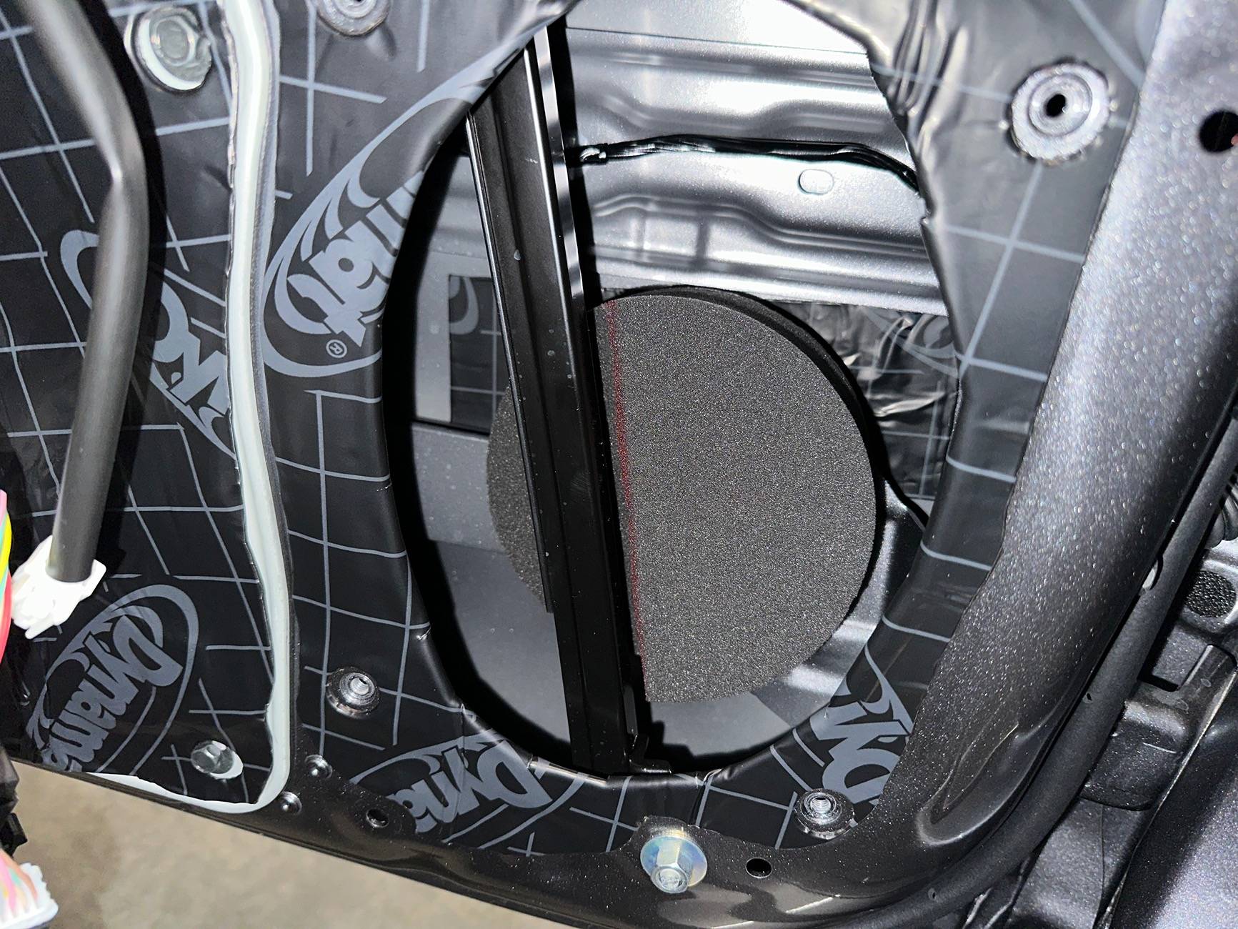

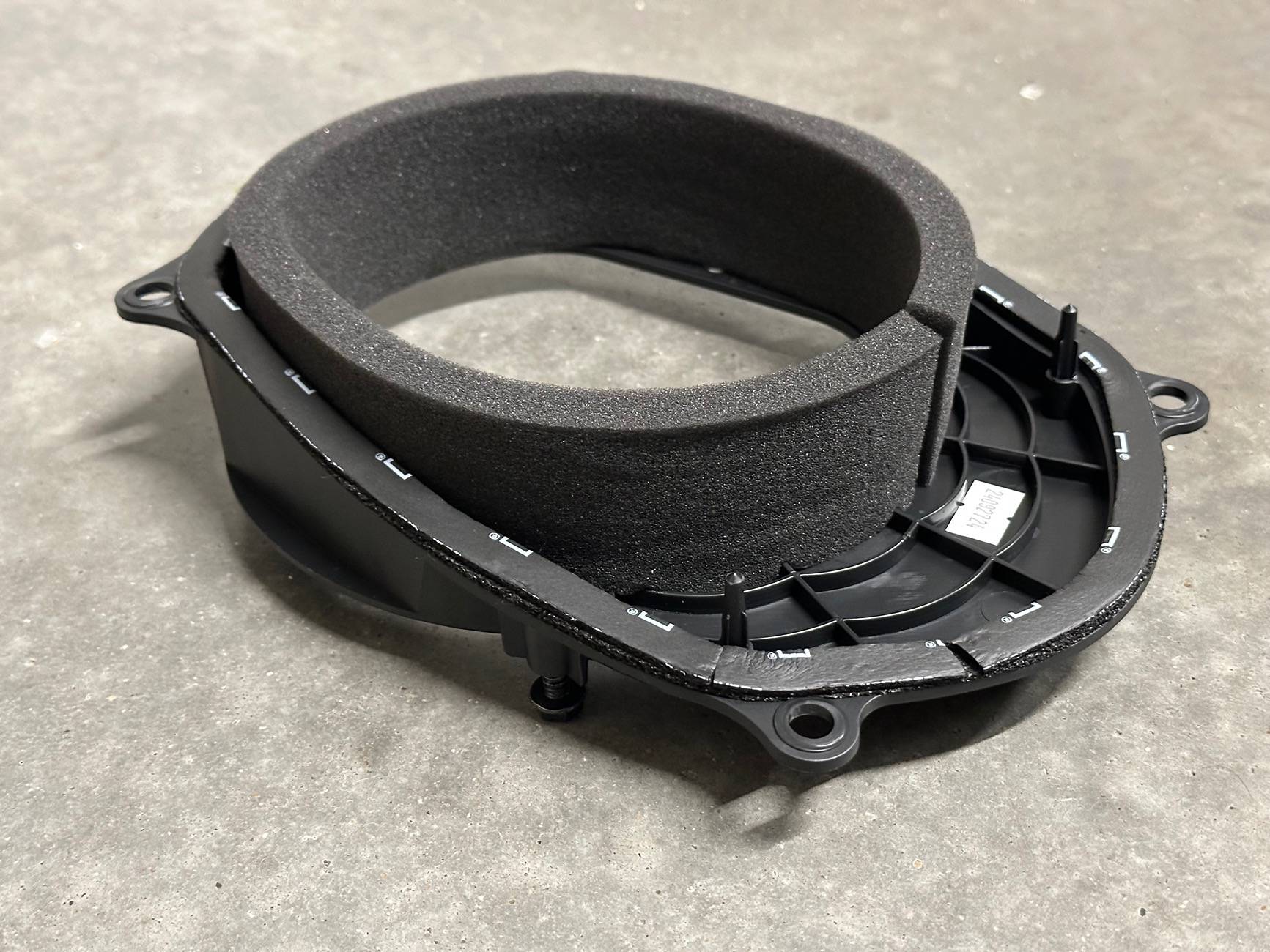

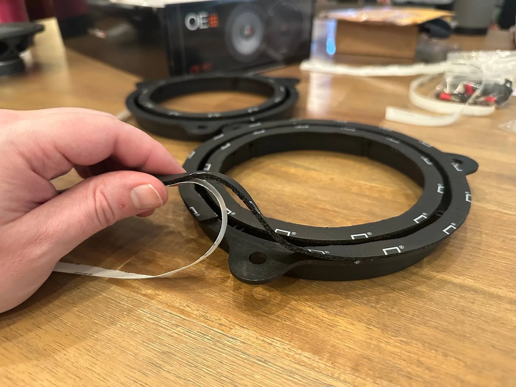

Next is the treatment of the speaker mounts. I put foam tape on all mounting surfaces and installed the foam ring surround that envelopes the rear side of the speaker.

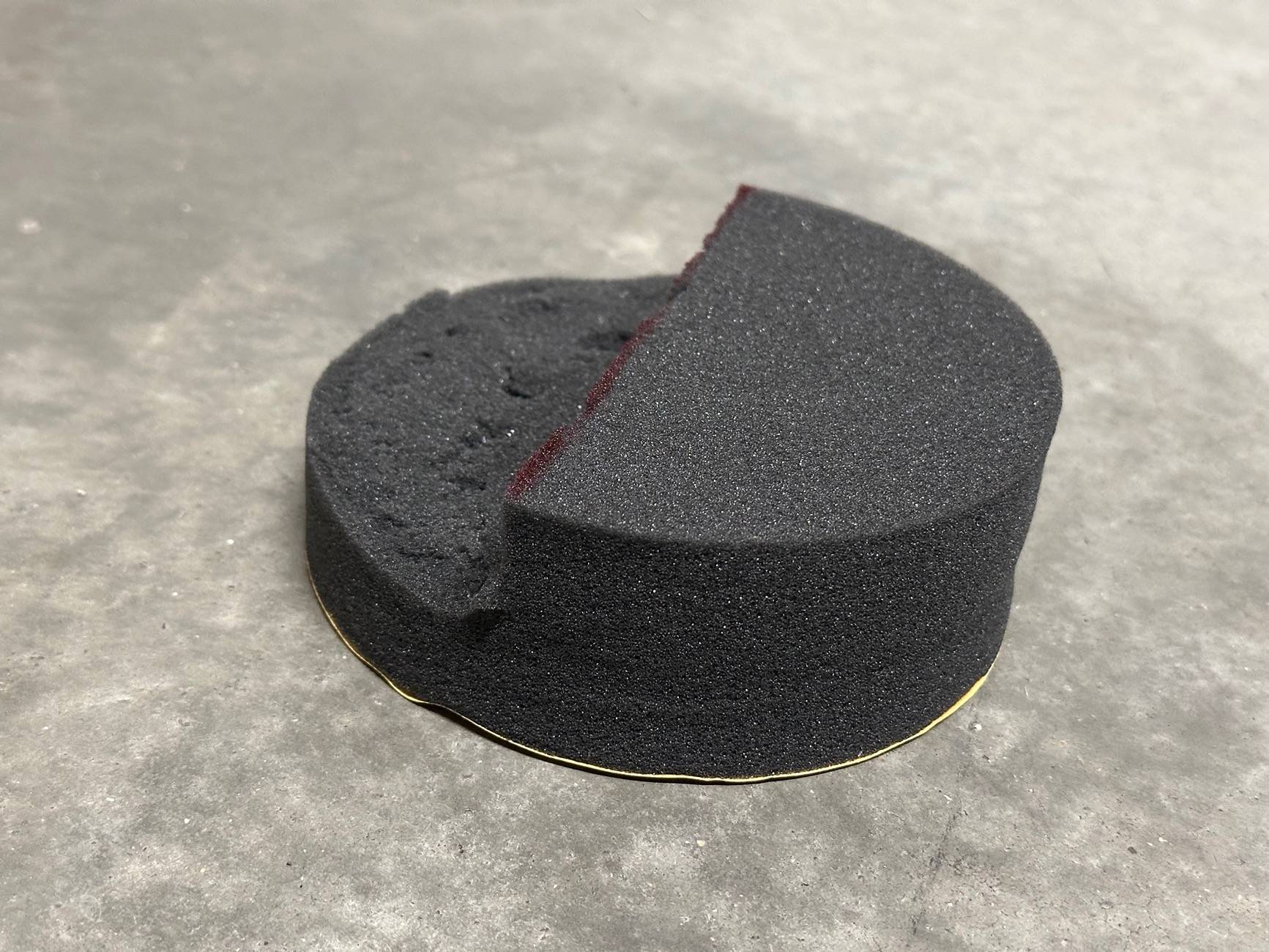

I also put the thick foam circle directly behind the speaker position, but had to trim it due to interference with the window rail. I wedged the foam in place, marked the outer edge of the rail, and then removed about ¾” of material from the face of the foam inside of that mark. It worked out perfectly and the window goes up and down with zero obstruction. Who knows if this is actually accomplishing anything at this point, but I had it, so I figured why not go ahead and install it.
Here is the finished assembly in the door!

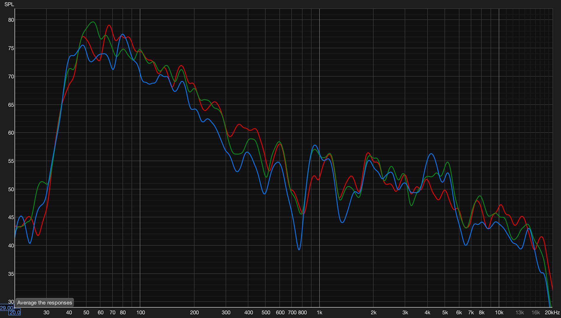

The following REW chart shows three measurements:
OEM system (red line)
Aftermarket dash speakers only (green line)
Full aftermarket speakers + door acoustic treatment (blue line)
For those unfamiliar with this type of graph, the y axis represents level and the x axis represents frequency.
All three measurements were taken at the same volume (25). They are the average of 20 seconds of pink noise. You can ignore the wonky curve. I forgot to zero out the EQ settings in the head unit before taking the initial measurement, but all three shots had the same EQ settings. The thing to pay attention to here is the difference between the curves, not the shape of the overall curve.
It's odd how much changed just by adding the dash speakers. There are significant new peaks at 950Hz, 2.5kHz, 5.2kHz. Oddly, despite being a two way design with a tweeter, the TS-A709 has a steeper roll off above 10kHz than the stock, tweeterless paper cones. This isn't necessarily a bad thing, as this could be perceived as "warm". However, the more dramatic peaks and valleys of the frequency response above 800Hz give a harsh impression, noticeably less smooth than the stock speakers. There is also an odd new dip between 300-400Hz, an important range for the "weight" of a mix; big notches like this can make the mix sound "hollow". From 300Hz down, the frequency response is mostly the same as stock, which I would expect since the stock door speakers were still in place. However, there is a big gain from 50-60Hz. This is bizarre. This is an extremely important area for bass, and for some reason, the stock door speakers performed significantly better in this area with the aftermarket dash speakers in place. This must have something to do with a difference in the crossover or load of the aftermarket dash speakers altering how the amp is interacting with the door speakers. This is purely a guess, but I don't know what else would have caused this, as the ONLY thing that's different between those two measurements is the dash speakers being swapped out!
Things only get worse once the door speakers are installed. There are dramatic new peaks and valleys across the entire frequency spectrum. The only thing I can think is maybe the sound deadening has altered the way the vehicle is resonating, but that would be the opposite of the intended effect. Look at how all of the peaks and dips between 300Hz and 2kHz are significantly emphasized. This is gnarly. Not in a good way. The ideal frequency graph is a nice smooth curve. All of these peaks and dips make the audio sound artificial and harsh. There is an almost 20db swing from 750Hz to 950Hz! That's insane! From 500Hz down, the aftermarket speakers are quieter than the factory speakers. Though the specs of the factory speaker are not published, my assumption is that it is a more efficient speaker than the aftermarket unit. And the big drop between 40-80Hz means noticeably less impactful bass. Though these new speakers are 2 ohm and are advertised to be used with the factory head unit, it seems the factory amp can’t quite drive them properly.
I guess the one good thing is something this graph doesn't show: decay. I couldn't measure this because REW refused to connect to the car's bluetooth. But the low end is noticeably tighter. So, the only way I could recommend these speakers is if low and low-mid sound quality is your absolute highest priority, with SPL as a distant second.
Overall, the stock system had a significantly more smooth frequency response. As you can imagine, this is pretty disappointing.
